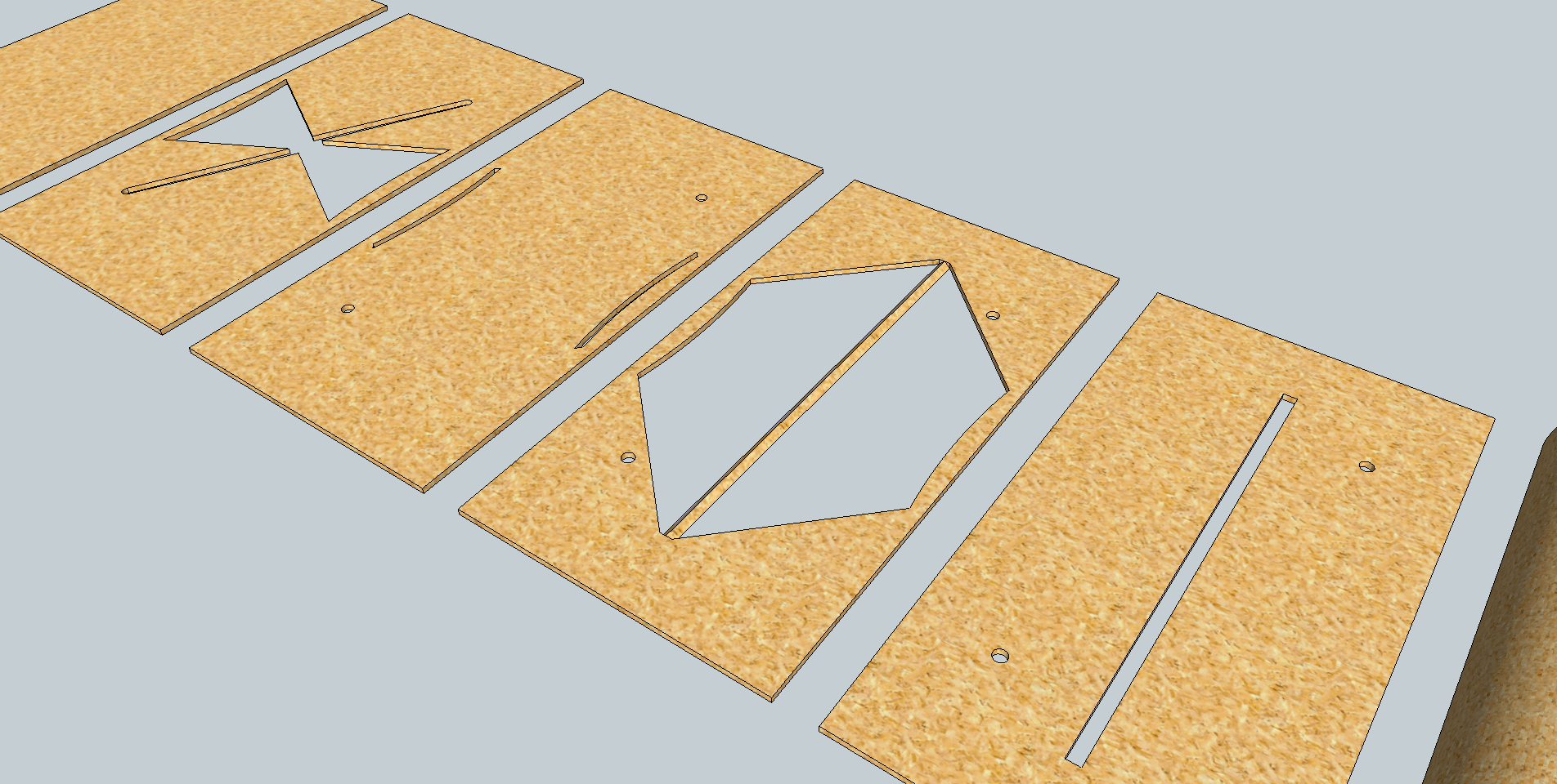

A little closer to the clear drawing I was shooting for.
Room under those sonotubes to hide midbass drivers
if you get to thinking unity...
The subtle thing here thats cool: Is the expansion from
roughly 45 degrees to 90 degrees is matched to fully
fill the horn without the high frequencies that usually
couldn't follow that change beaming down the center...
Lookie them curves! Bent the opposite way you have
become used to seeing of late. Not the usual paraline.
Remember, this is a Smith horn: The panel, slot, and
constant directivity are all horizontally oriented in this.

Looks good, but keep in mind that the expansion rate is going to be realllly slow. That's good for low frequencies, not so good for tweeters.

Interesting design and actually have all the materials on hand, including the sonotubes (Sakrete). Actually there is enough room in the tubes for a 6.5" mltl sub that'll hit 26 quite well I've designed. Woofer on top, port out the lower back. The width would aid BS to ~240Hz(ottomh) along the line.
I'm not saying I'm on board to try due to another design thats been put on hold... car accident, totalled, at fault driver never had a license and their insurance was recended for breach of contract kinda crap 😡
It's similar in size and uses 12"tubes for roundovers. Big on stature yet rather thin profile (9-10" deep) active 3way. Am so close to making this a wrap can taste it. Uggg, life

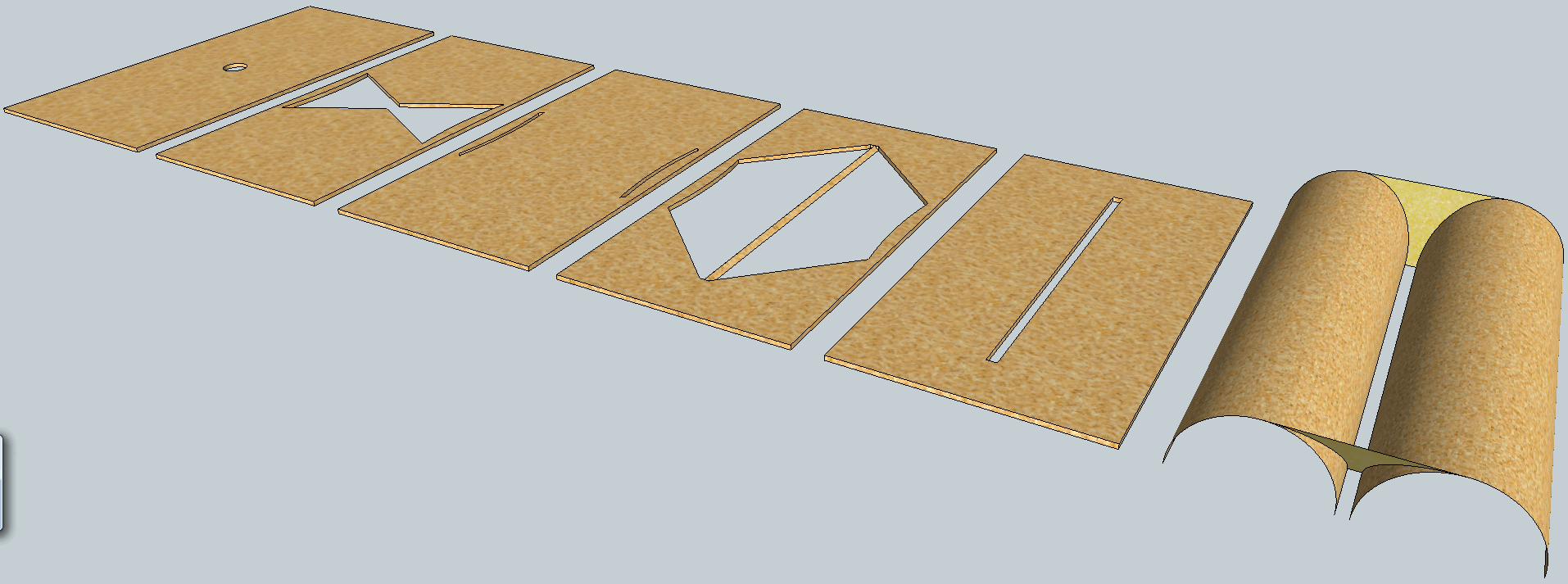

Since Patrick thinks the expansion is too slow, lets go crazy with that idea.
Manifold up to 4 compression drivers, here shown with only 2. So much
versatile room under those roundovers to hide all kinds of stuff, why have
anything on the back to interfere with hanging flat against the wall?
No functional difference, just cutting corners for weight.
Still lots more do-nothing material here could be pruned.
I'd probably just go with simple and heavy drawing 701...

So the reason my Paraline has a square mouth instead of a long skinny one is that I was stacking a Paraline on a Paraline. By doing that, you cut the footprint in half.
