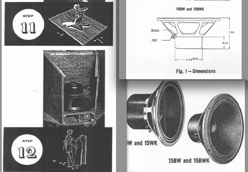

That horn was not created to produce a diffraction effect, that was just the way that was chosen to load the driver at what looks like 50% of the cone area. It could be done with a circular opening but the way they designed the horn it was just simpler to just cut the cone area in half by a straight edge. I would think at high excursion that the surround would hit the back of that plywood area in front of the cone if there was not some sort of spacer in front of the bass speaker.
The EV15BW and 15BWK used in the Centurion were designed for horn loading and fitted with a gasket deep enough for the expected excursion which was probably less than 3.3 mm, about 1/8" one way.I would think at high excursion that the surround would hit the back of that plywood area in front of the cone if there was not some sort of spacer in front of the bass speaker.
Other speakers may need an additional gasket.
I would agree with Patrick's suggestion regarding replacing the mid and HF with a coax, the original folded PA mid horn is more appropriate for carnival midway rides than home use, though the T-35 tweeters are not bad, if the diaphragm is properly shimmed and centered.
Those changes would require a crossover designed for the components, and delay of the mid/high to the LF horn path time of flight would be an improvement.

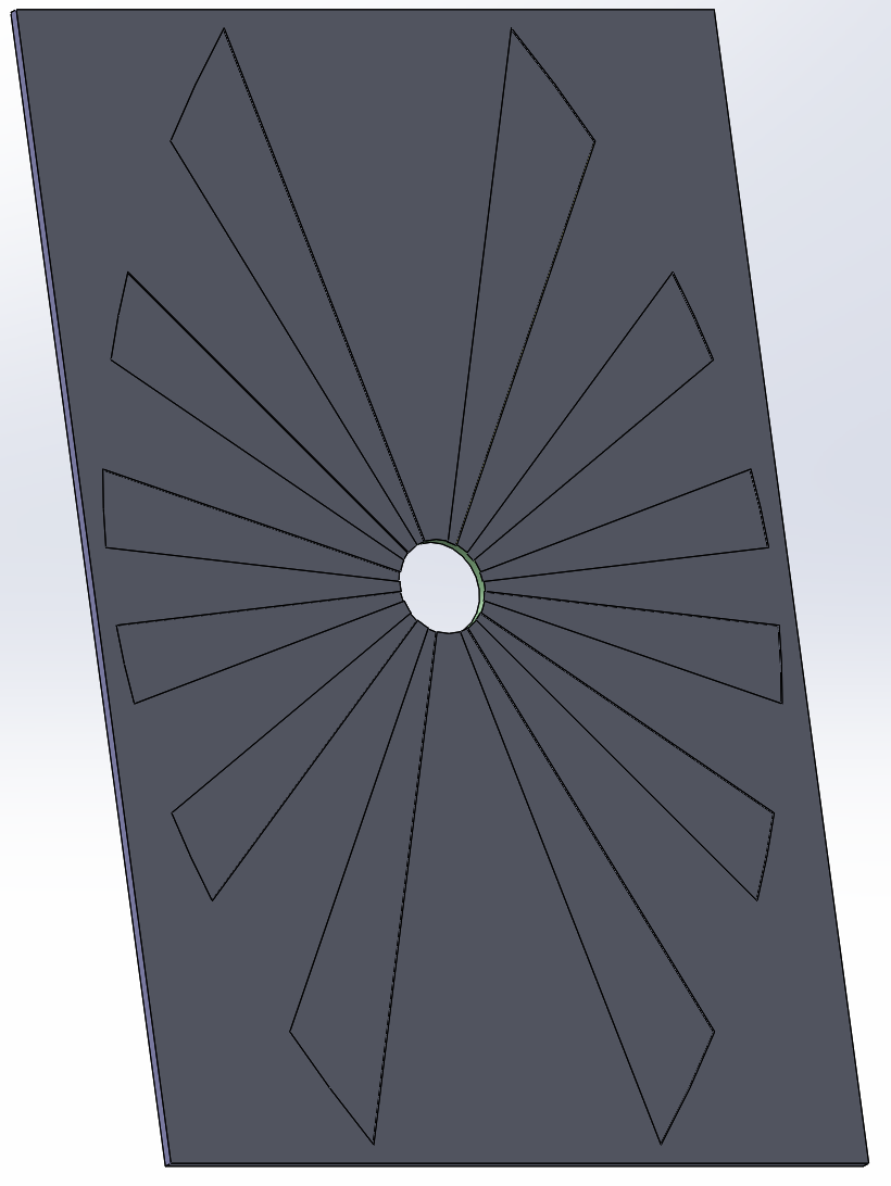

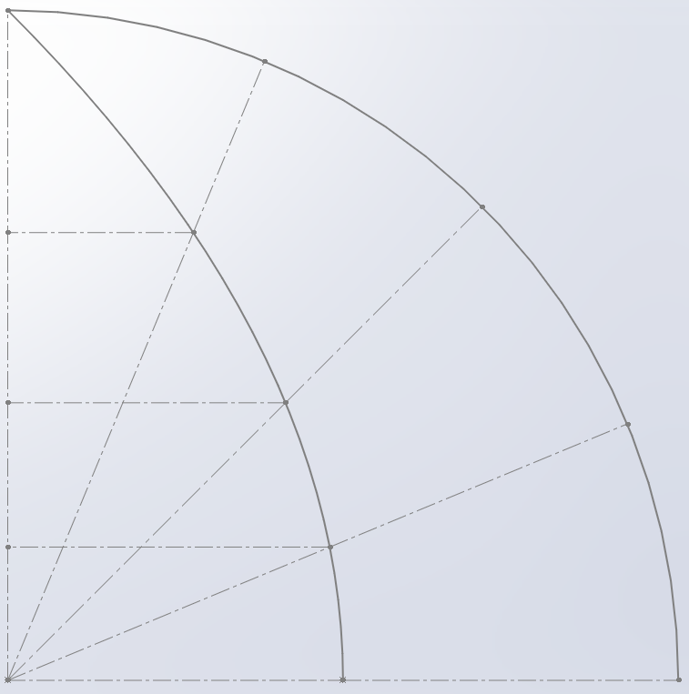

I have been thinking about the paraline for a bit, wondering if it would make it possible to somehow make a domestically friendly line array speaker without going floor-to-ceiling.

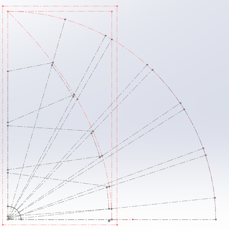

One thing that struck me is that although the path lengths for in the "standard" paraline that creates a flat wavefront are equal, the output along the line is not. Perhaps that is a good thing - perhaps not in all cases. But it seems to me that it would be interesting to have a device with equal output along the paraline along with a flat wavefront.
Here is a standard paraline (one quarter of it anyway), split into four 22.5 degree slices:
You can see how when you fold the lines back, you get the same path lengths for each segment.
However, each slice of the pie gets a different horn profile. This is easier to see if we mirror the "folded back" sections:
Different lengths of "expanding (conical?) and tube-like" expansions for each section.
I am wondering if this could be one of the reasons for the uneven response seen by people who have tried building these.

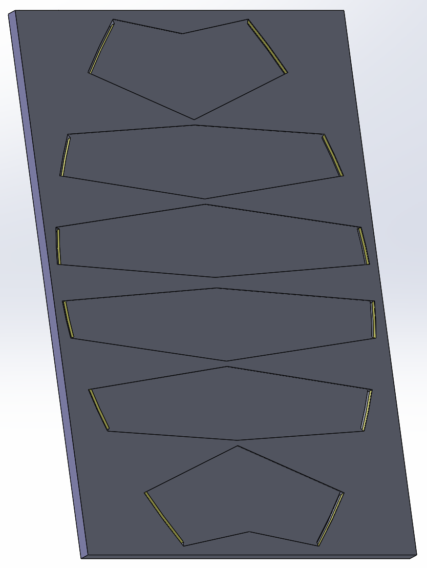

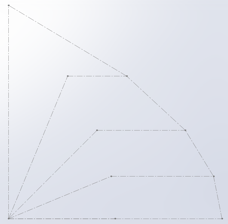

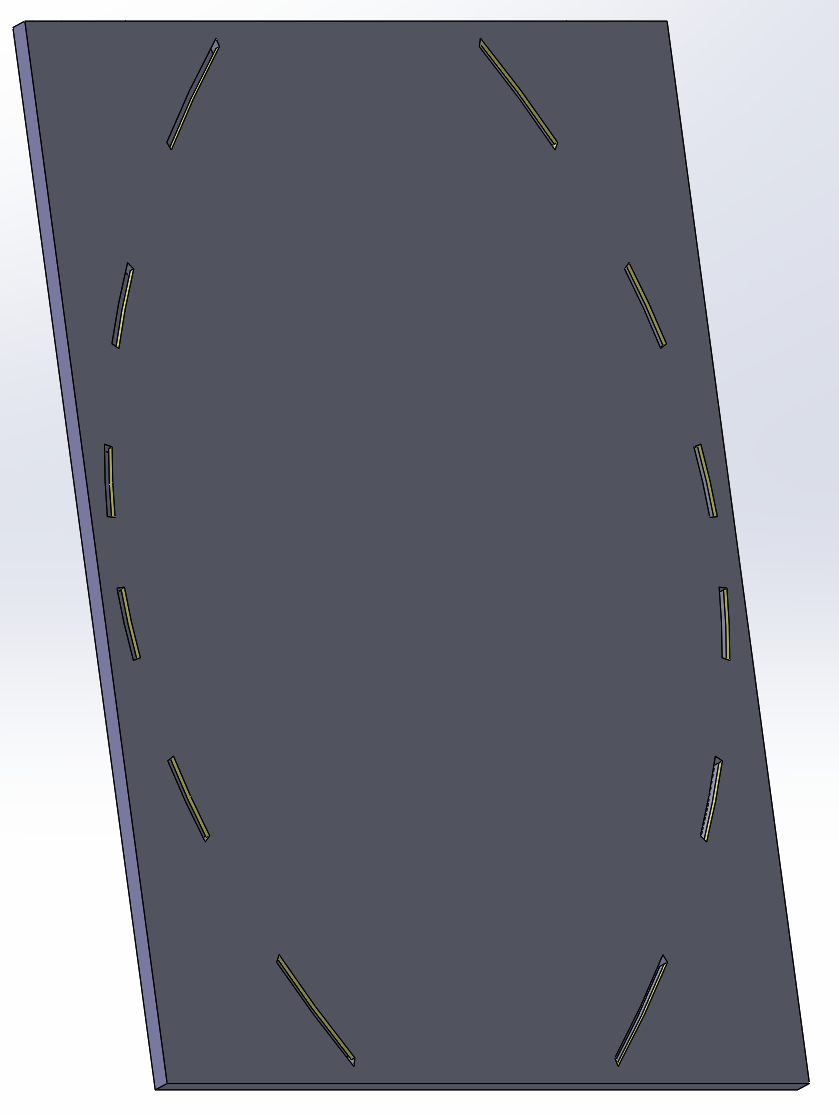

So I tried to draw a variant that would have equal expansion from the throat to the mouth. Through trial and error it seems like the only way to do this, is to make the mouth smaller, using only half of the area available radiating away from the driver. In the example below I´m using three slices with 12% angle. You can see how the angle continues as that section is reflected back towards the line opening.
Here´s how the first two layers would look like:
Third layer added:
Fourth layer added:
Final layer added:
Now, I didn´t place any reflector or anything there yet, but this will have to do for illustration. 🙂
Anybody care to give critical but friendly feedback on these thoughts?

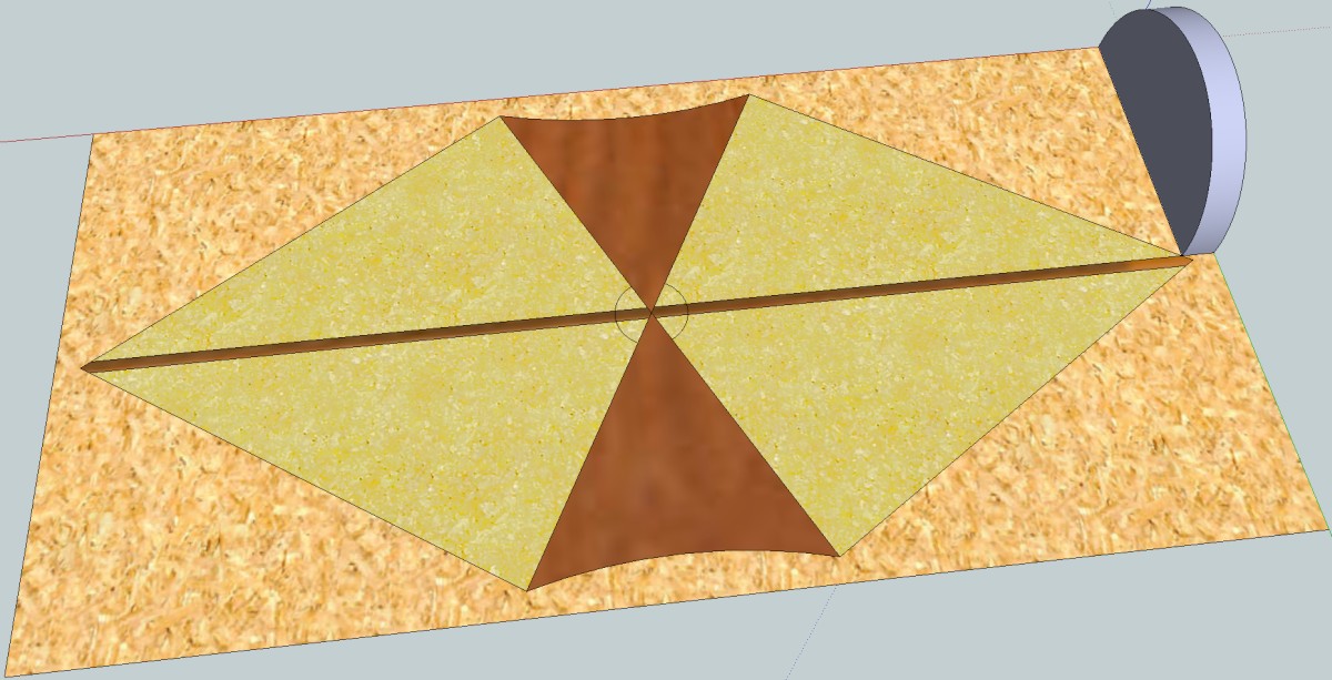

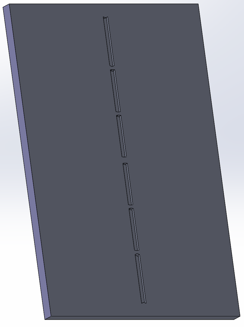

Just thinking of a cross between paraline and Smith horn.
Straight internal reflectors at the top and bottom, rather
than the usual parabolic. Flat triangular expansion all the
way to the horizontal exit slot. Then two roundovers:
Halves of PVC pipe covering the entire frontal area.

Bend the other way to match a narrow triangle to a wide triangle, thus
we are expanding faster all the way to the exit slot and roundovers.
It will all make much less sense if I just post a picture.
Pardon lazy drawing of multiple layers as-if only one...
Just for purpose of thinking too hard:
The speaker hole maybe 3inch, the panel 48wide x 24tall.
Since narrowing vertical directivity would be a feature,
the exit slot could be twice as wide as I drew it, originally
thinking 1/4 wave at 20KHz... Sonotube for roundovers?
- Square Pegs
