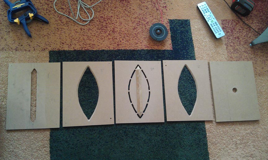

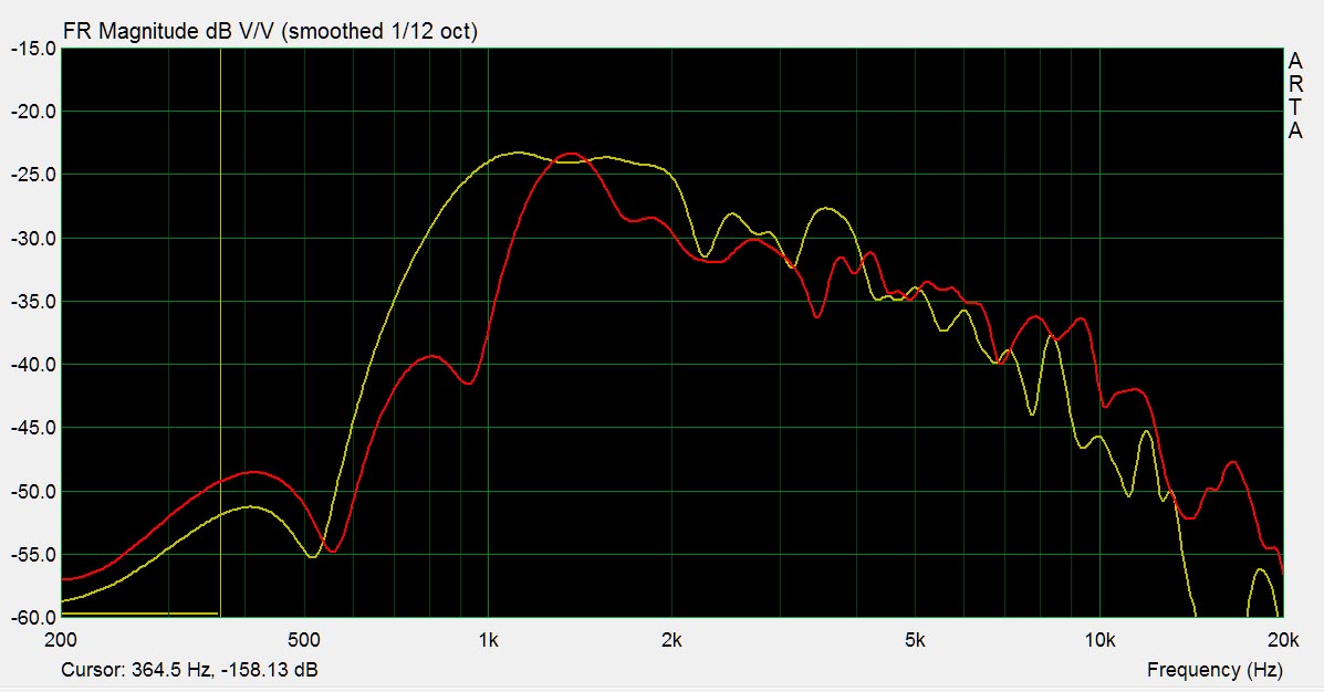

I built a Paraline this weekend, and did some quick and dirty testing today. I dimensioned it using Bateman's spreadsheet for 40 deg vertical dispersion, so its "pinched." I'm not much of a wood worker, more of a hack really, but I put a lot of effort into getting these things right. I made the "eye cutout" pieces with 45 deg angles because the abrupt 90 deg corners were bothering me. Unfortunately I made that decision an hour and a half away from my computer and CAD software, so I had to remake the template on the fly. I think it came out ok.
I was eager to see if it worked, so I put a 1" dome tweeter over the 1" hole for the comp driver. This was pretty sketchy, because the dome has a chamfer on its faceplate that the dome recesses into, so I was effectively creating a chamber for the dome. The yellow line is the measurement. I haven't yet made a reflector for the hf driver throat. Measuring with and without the mouth reflector showed that I got me a little smoother hf, with a tad more extension. Either way, I think I'm running into what Don is talking about with the path-length differences. Obviously this thing is low-passing the tweeter. My pathlength difference in the bend (with my angled path) comes out to about .375", which works out to about 12k at 1/3 wl.
I thought that maybe the chamber created by the dome on my driver mount plate was doing the filtering, so I quick rigged up a piece of cardboard with a hole large enough for the tweeter dome to protrude through (I took the faceplate off). That's the red measurement. A bit more extension and less bottom end.
Obviously this setup with the dome is far from optimal, but it'll be interesting to see how the comp driver performs once I get it.

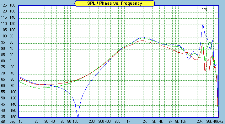

Actually your results are pretty good. Like any conical horn, we're going to see a lot more gain on the low end.
Here's a graph that John Krutke made, horn loading a dome tweeter on a Parts Express waveguide.
See the big swings in output that John is getting at the top end? That's what we DON'T want.
A big bump at the low end, and a smooth rollof is what we *do* want. A graph like yours is easy to flatten using standard filters. The thing we want to avoid are peaks followed by dips. Which is what we get when the pathlengths are wrong. The Dayton 2" dome exhibits this problem, and so does the BG NEO 8.
But I don't see that prob in your graph.

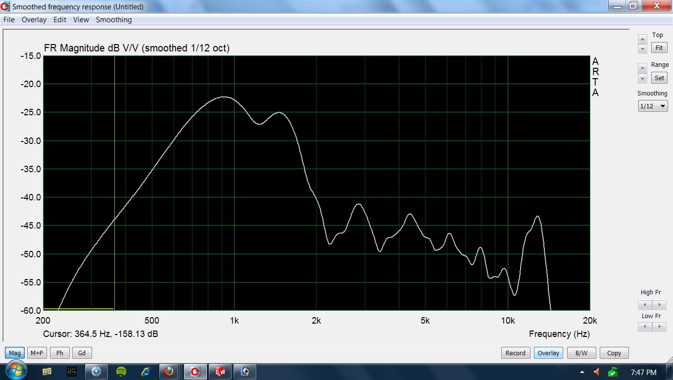

I was expecting the top end to roll off, but 20db seemed a bit much. Like you say though, a dome isn't exactly a comp driver. I'm not a horn guy and I've never used a compression driver so this is uncharted territory for me.
I wanted to see how a mid performed on the Paraline, and the closest candidate I had was a Fountek FR88 fullranger. I used plumber's putty to seal up the basket, and also to seal it to the throat plate. Graph included.
I eq'd it flat within its bandwidth, then redid the crossover on my Neo8's (the upper mids of my 4-way dipoles) to match the FR88 and listened. The Neo sounded dull and lifeless compared to the Paraline. I guess this is the dynamics you guys keep on about 😀. Then I whipped up a ghetto waveguide out of cardboard and duct tape for the Paraline and listened some more. Very promising! Despite the limited bandwidth and obviously very wrong cardboard waveguide I really like what I was hearing. Definitely potential here.

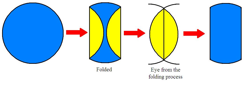

... We also must remember that the radial expansion of the paraline approximates a conical horn. ...
??? I thought it was parabolic.
For a Paraline (or its unfolded equivalent), the mouth area for a given length (radius) is pi * diameter * slot width. Double the length (radius), double the area.
For an axisymmetrical conical horn, the mouth area for a given length is pi * radius squared. Double the length, quadruple the area.
It seems counterintuitive to me... what am I missing?

As your measurement indicates, you made the mass rolloff even worse by placing a midrange onto the paraline. Being down 20dB with a dome tweeter is quite good. Even a compression driver is down a good 10dB most of the time.

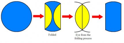

It’s always expanding. It is a circle that has two parallel sides folded over. There is no limit to how many times you fold up the sides of the circle. Instead of a single fold like in my attached picture, you can fold the sides into a Z shape.
