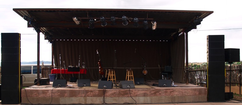

The Paraline line array I built using Eminence Alpha 8 and EV DH1AMT was the first PA system I have mixed on where the PA output sounds more "high fidelity" than the Sony MDR 7506 headphones, or the GK Ultraphones which also use the MDR 7506 transducer I use for reference.jerryo,
I have not heard these either. What I know is that this is borrowed from a pro-audio application for sound reinforcement with a coherent wavefront/ I don't really think that in its present form I would call it a high fidelity device. but I have not heard it so I could be wrong.........
I had used the same transducers in an MTM arrangement in the same cabinet shell, the difference between the Paraline/offset horn and the MTM was a huge improvement in terms of off axis uniformity and resistance to degradation caused by wind.
In terms of "ruler flat" frequency response, the Paraline will not appear as "high fidelity" as some transducers, but for the things I consider most important for hi-fi at a distance, haven't found anything better in a modular system.

I used birch plywood. The Paraline guts are posted in #92.Hi weltersys,
what is the frequency range that your paralines operate over, and do you have any photo's?
Whilst we are the subject, what would be the widest frequency response that one could expect to achieve using a paraline of reasonable dimensions?
What would be the best material to use for the construction?
Cabinet dimensions are 26.5 wide by 11.25 tall and 15" deep.
Using a pair of Keystone 18" subs, 28 eights, 10 EVDH1AMT, crossover points are 100 Hz, 680 & 1100 Hz, an underlap in the high crossover results in an acoustical crossover around 800 Hz.
Art
