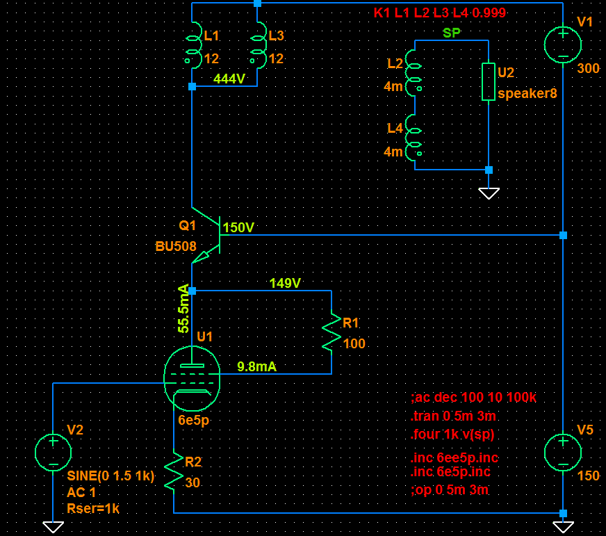

Spud Inverted Cascode Hybrid Experiment
One remark foreup: This is only an experiment and not meant as a serious proposal for an actual amplifier.
Spud amps using only one single tube, (single stage, no combo), have a problem that the gain of the tube - triode in particular - is not high enough to get any significant output into a speaker from common line input signals. This is usually delt with using an input transformer.
When I saw the Inverted Cascode on the TubeCad site https://tubecad.com/2016/04/17/Triode-PNP Cascode.png I wondered whether this could be translated to a spud solving the gain problem.
In such a cascode the voltage gain is no longer determined by the mu of the triode but solely by gm of the tube and the load impedance, g = gm * R.
Say we used a 6E5P (gm 30 mA/V) into a 6K : 8 transformer (turns ratio 27) the overall gain would be (30 * 6 / 27 = 6.6), so we could get 6 Volts out into the speaker for every Volt input.
In a conventional grounded cathode setup the 6E5P (mu of 30) could only deliver one volt out per volt in.
With the cascode we get 6 times more ... gain problem solved ... or not ...
Well, here's what I came up with. And it does have the expected gain ...
but ...
we need a high voltage PNP transistor which can withstand the 600V+ voltage swing on the primary of the OPT,
and because to my knowledge such a device does not exist (the best I can find is MJE15035 which has a 350V rating) the transistor has to be a cascoded as well.
Sim and a prototype setup work and they do have the expected gain.
Because I did not have any of those HV PNPs I went for a pseudo darington configuration in the prototype requiring only small signal PNPs KSP94 (rated 400V) and a good old horizontal output NPN (BU508, C5251) which are good for a kV or so.
And because I did not have a suitable OPT as well, I used a pair of small 12K : 4 OPTs with series connected secondaries and parallel primaries for a 6K : 8 mockup.
Still works and plays load enough from line signals.
In my sim I get 2.7W into a speaker load with just 1.35V peak input and 1 ... 1.5 % THD depending on tube model.
Power supply has +150V and -300V and was derived from a center tapped 115V + 115V isolation transformer.
So where's the catch ?
Well, there's more than one:
  • cascodes have high output impedance and this is no exception; in other words: damping is practically non existing,; sound depends on speakers whether they like "current drive" or not
  • cascodes have poor PSR; but only the +150V rail requires good filtering, the -300V rail is almost immune to ripple.
  • the carbon footprint is abominable; for 10W burned in the tube there is 20W wasted in the transistor ... and it would be a pain in the neck to get rid of those 40W in an actual stereo build.
Schematics attached, LTspice files and models in the Zip.
One question which I am not able to answer, maybe someone can teach me:
  • is the transistor cascode still a cascode or is it soehow involved as an amplifier ?
  • the question came up because of how the biasing resistors connect to the output signal ... ???

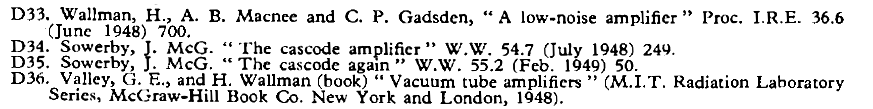

Cascode sure starts in vacuum-tube days. I can't find a authoritative "it starts here!" reference. It's not in Spangenberg or Reich.
It is mentioned in passing in Radiotron 4th and linked to Wireless World 1948+:
https://worldradiohistory.com/UK/Wireless-World/40s/Wireless-World-1948-07.pdf (page 41 in 6MB PDF)
https://worldradiohistory.com/UK/Wireless-World/40s/Wireless-World-1949-02.pdf (page 46 in 7MB PDF) (this issue also has the James tone control)
The July article is not the cascode I remember: here both grids are driven. The February article is the usual cascode and cites-
H. Wallman, A. B. Macnee and C. P. Gadsden, Proc: I.R.E., June, 1948, Vol. 36, No. 6, page 700
https://worldradiohistory.com/Archive-IRE/40s/IRE-1948-06.pdf (page 38 of 20MB PDF)
The Wallman paper only speaks of triodes and pentodes, of course. Wallman actually worked in WWII and the 'modern' transistor was still being birthed when he published. Like much literature, the cascode is described as pentode gain with triode noise.

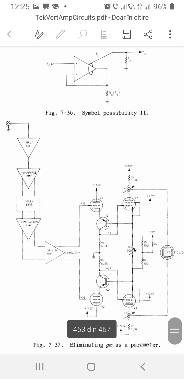

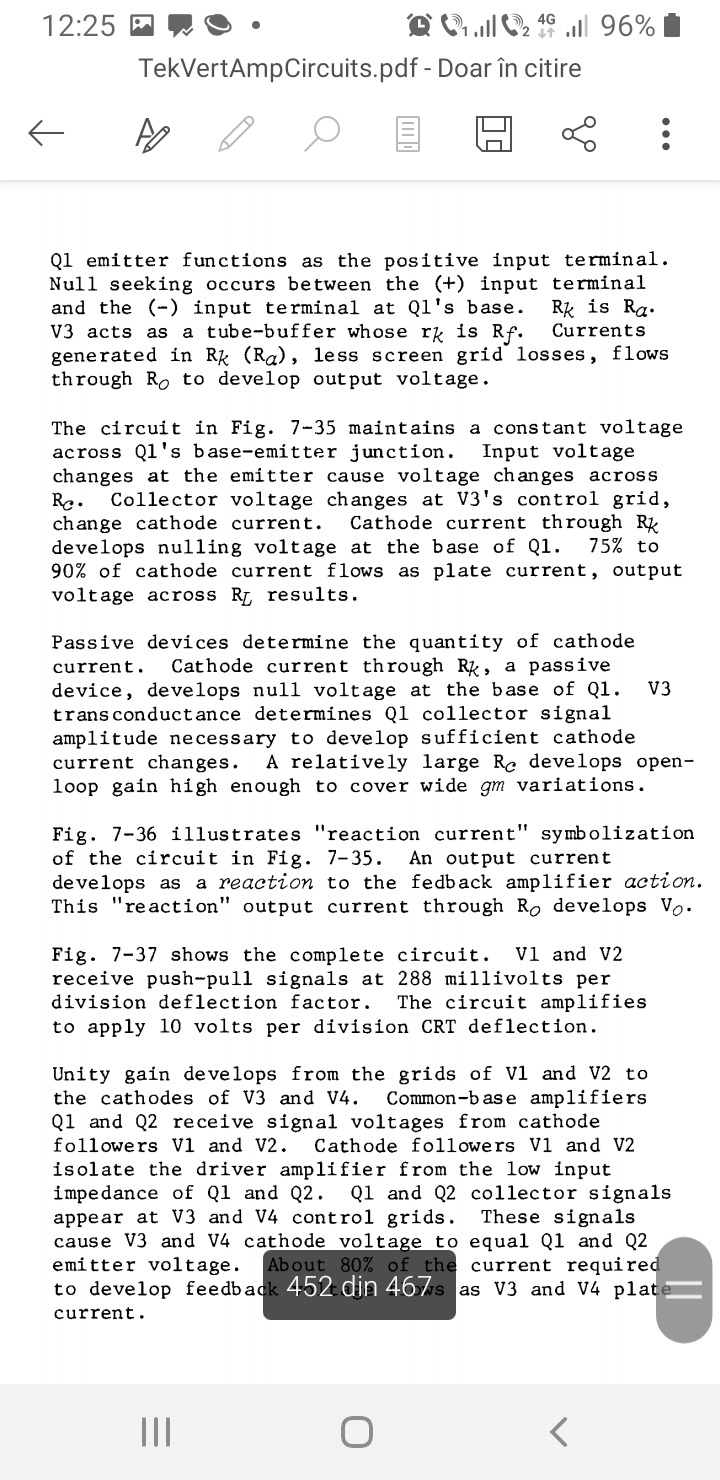

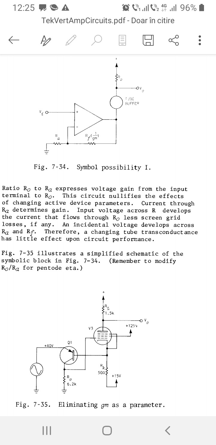

There's a much better version used by Tektronix.I can also make for a fine electrostatic headphones amplifier and you don't need too high voltage transistors either.At the time they used this circuit there was no high voltage transistor anyway...
