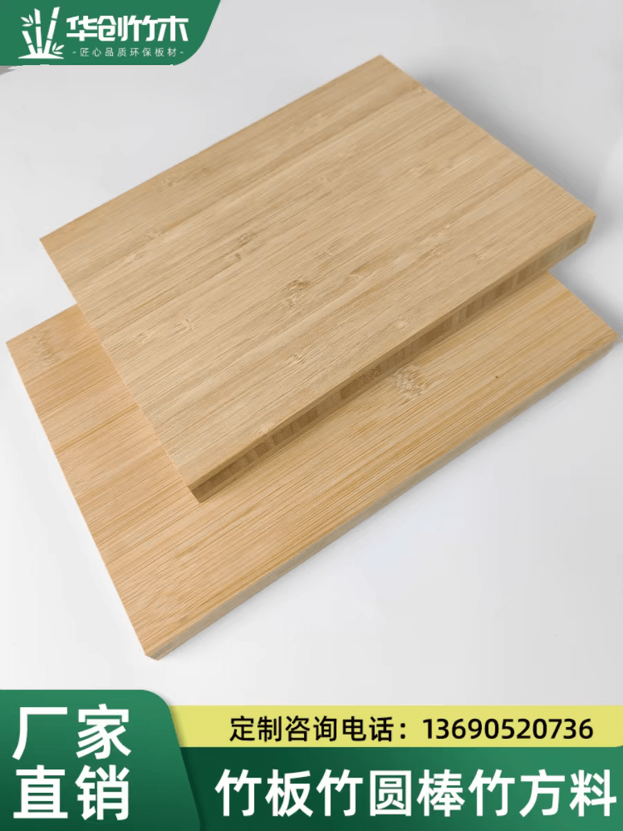

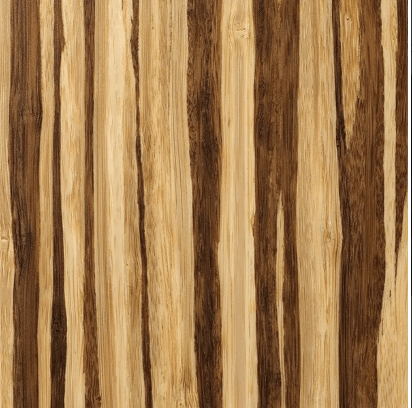

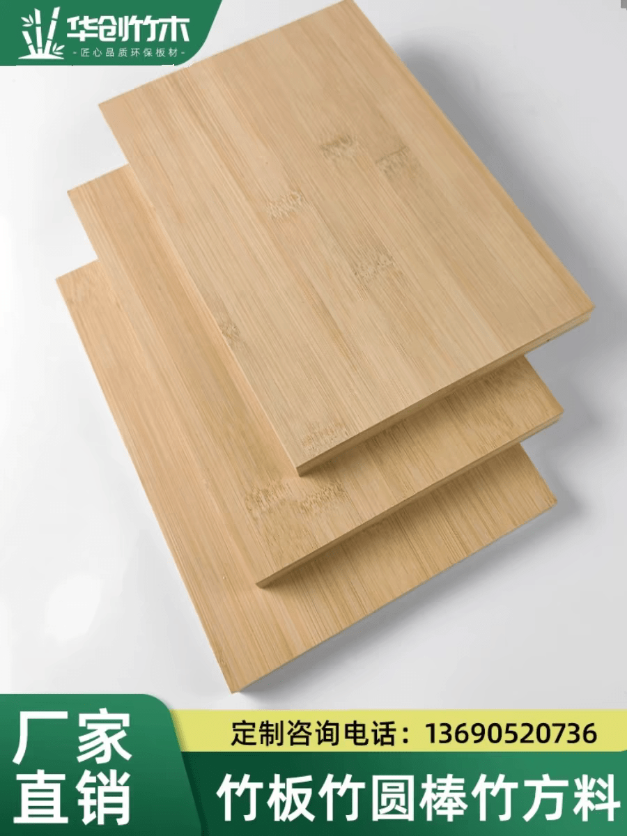

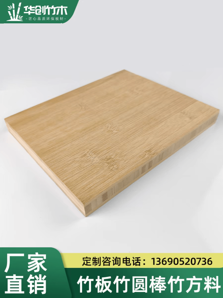

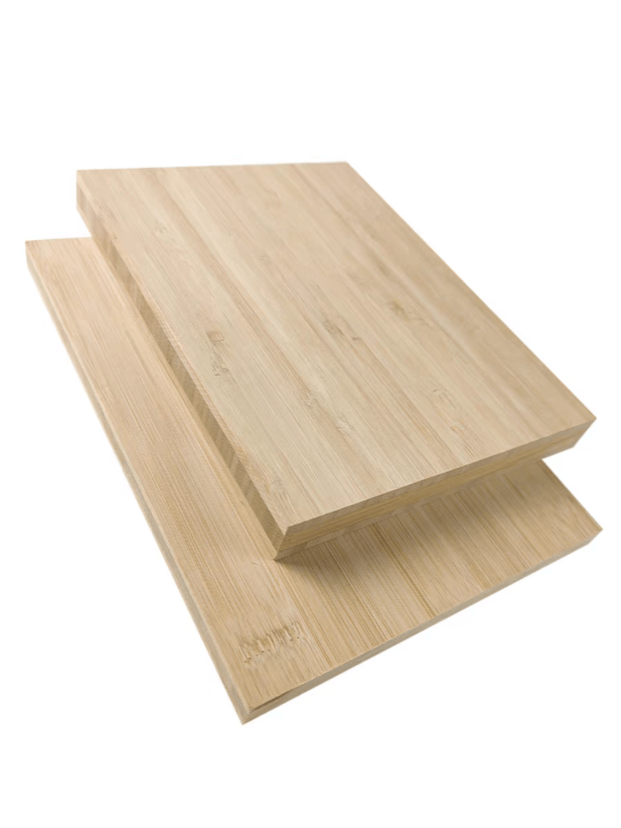

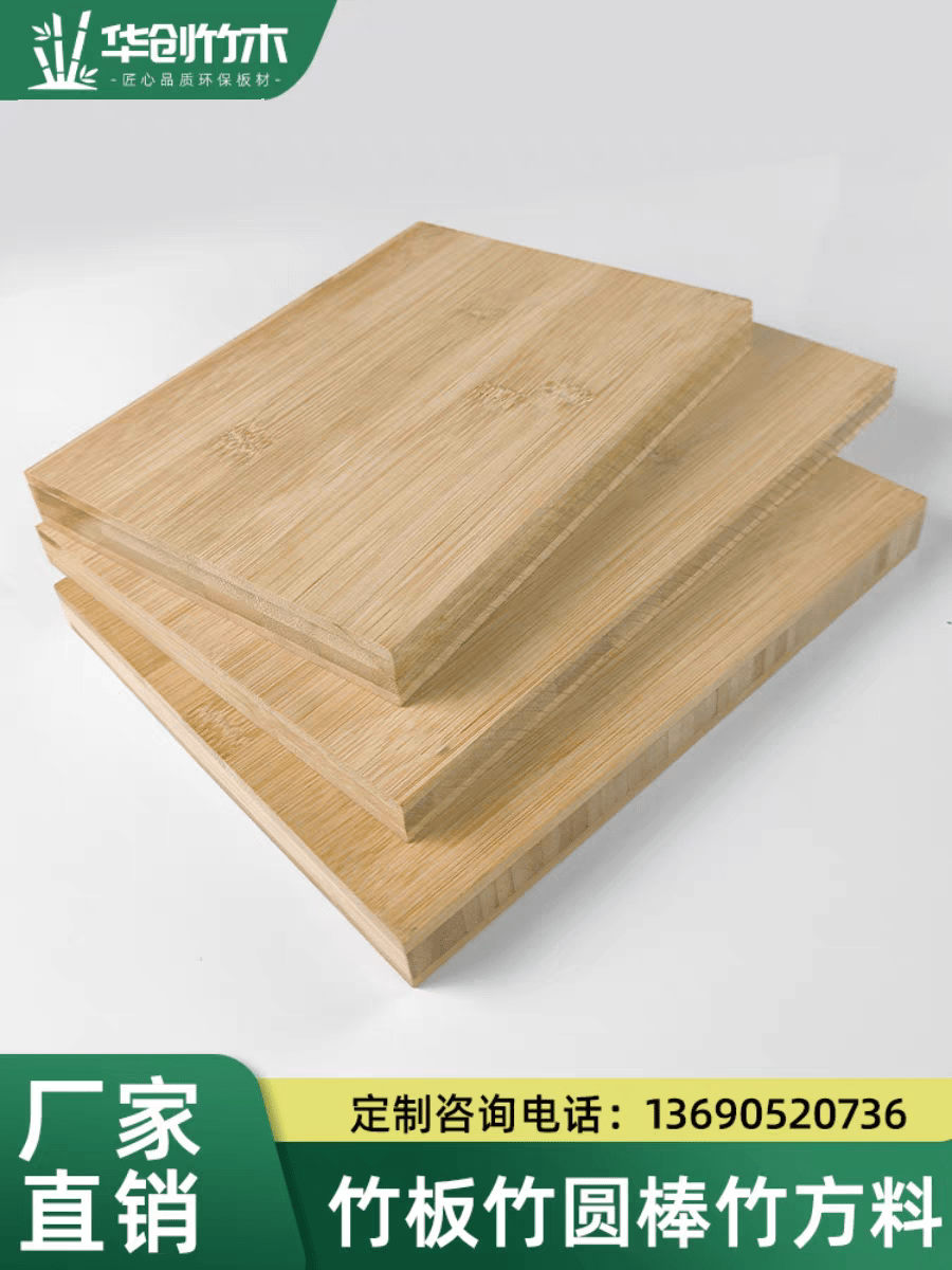

Whether this bamboo wood good for speaker cabinet? Thanks!

Composite Bamboo ply is great stuff to build cabinets with. It ain’t exactly inexpensive though. I have a cutting board that has lived outside since 2007……still looks good and lies flat…..I can think of no better test than that. In all fairness, it’s on a Teak table……and the table looks a little better.
Therefore, which one is more adequate for speaker cabinet between the two attached pictures?Composite Bamboo ply is great stuff to build cabinets with. It ain’t exactly inexpensive though. I have a cutting board that has lived outside since 2007……still looks good and lies flat…..I can think of no better test than that. In all fairness, it’s on a Teak table……and the table looks a little better.
Can't say for sure by board looks like image 1 and 4...same segment layer style
Yes pics 1 and 4 are vertical and the second best. Pics 2 and 3 look to be horizontal and are considered the least desirable for this. Although it may be just fine, the other two are considered superior.
You meant the bamboo ply from the attached pictures are the best?Yes pics 1 and 4 are vertical and the second best. Pics 2 and 3 look to be horizontal and are considered the least desirable for this. Although it may be just fine, the other two are considered superior.
Let's not confuse things. Now the pics in post #49 appear to be duplicates. 1 is the same as 3 and 2 is the same as 4.
2 and 4 are the better board.
Regarding 2 and 4, don't you think this type has any voids?Let's not confuse things. Now the pics in post #49 appear to be duplicates. 1 is the same as 3 and 2 is the same as 4.
Thanks!

I doubt either orientation has voids. It will be stiffer than mdf. Are you building these yourself?
what is bamboo wood sound like as cabinet?
If well engineered box, nothing from the box. Except for the affects of external shape on the diffraction signature, and any issues from the internal shape. Thise can be minimized but never eliminated.
