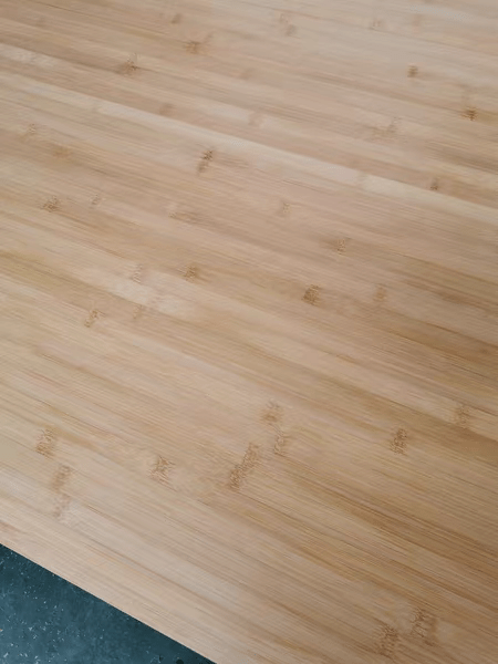

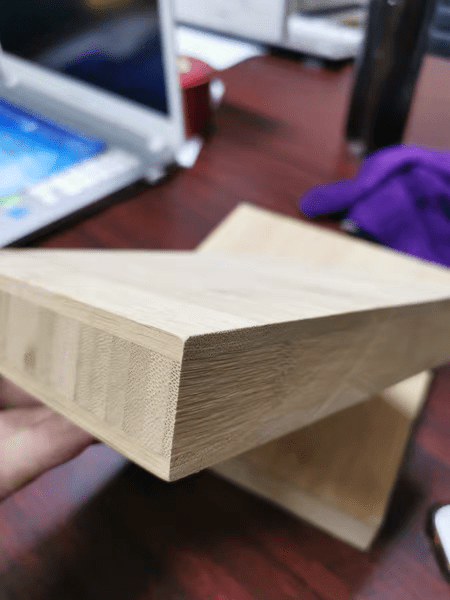

The only bamboo plywood I can access here in Hong Kong looks like the attached pictures. Are they suitable?

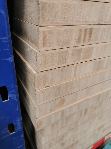

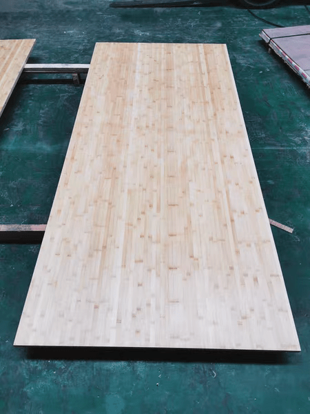

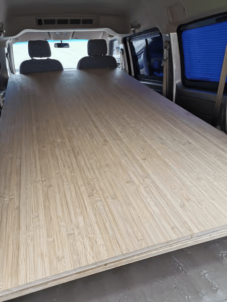

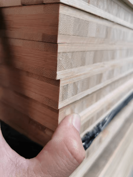

Here are the bamboo board from the supplier, and they claimed that those are not bamboo plywood but bamboo annexation.
Can I have it for speaker cabinet?

That is called Vertical and is fine. The stuff Dave shows as he mentioned is known as Strand and is the best and hardest but most expensive, hard on your blade and not always available.
Is that better than MDF?That is called Vertical and is fine. The stuff Dave shows as he mentioned is known as Strand and is the best and hardest but most expensive, hard on your blade and not always available.

Bamboo ply ois made in China, it would be surprising that it couldnot be found. But then Finish BB seems to be hard to get in Sweden.
Bamboo ply is made of a block core with a “veneer” sheet sandwiching it.
Horizontal, Vertical, & Stranded are different constructions of the “veneer”.
The first 2 refer to the orientaion of the grain. Stranded takes bamboo strands and embeds them in some sort of epoxy/binder to create a very stiff sheet. Vertical is suitable for loudspeakers, stranded is better (by more tham a bit).
Both a pretty. Vetical can be dinged, stranded takes a much harder blow to ding. It is also heavier (not a direct asset, it is a consequence of getting the stiffness).
Even Horizontal is better then MDF. And note that both builds shown are raw plywood with a clear coat.

Almost correct. It refers to the core. Horizontal is flat stacked, vertical is what you show in post 36 and stranded is how you described.Horizontal, Vertical, & Stranded are different constructions of the “veneer”.
