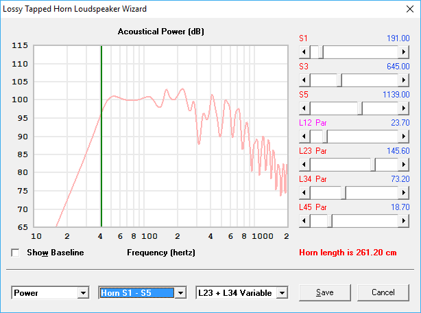

Hi. I'm completely new to this. Can someone explain what order I need to use these different tools in?
I have Hornresp, I've entered all the Thiele-Small Parameters etc. I hit calculate but not sure what values I should be exporting into the Boxplan spreadsheets.
I really need to put together a list of instructions on how to use the spreadsheets, along with a few worked examples 🙂.
Here's a simple outline:
1. Use HornResp to come up with a suitable TH design for your driver (BTW, the driver you chose may not be the best driver for this type of alignment unless you want to go really low, and the folds that are covered in my spreadsheets are more for pro audio builds).
2. Take a note of the net volume of the simmed TH, then add about 10~15%. Let's call this V
3. Choose starting box dimensions to achieve volume V and enter these into the spreadsheet.
4. Enter the dimensions of the driver into the spreadsheet.
5. If the spreadsheet indicates that S1 or S4 (or S4), needs to be entered, do so, using the values from your HornResp sim.
6. Adjust panel sizes in the spreadsheet until the horn expansion (lower graph is a smooth as possible).
7. If the other calculated HornResp parameters in the spreadsheet are not a close match for those in your sim, try adjusting the box dimensions a bit, then repeat from step 6.
8. Once you're close enough, replace the HornResp parameters in your sim with the ones from the spreadsheet. If you don't like the results, repeat from step 6 🙂.

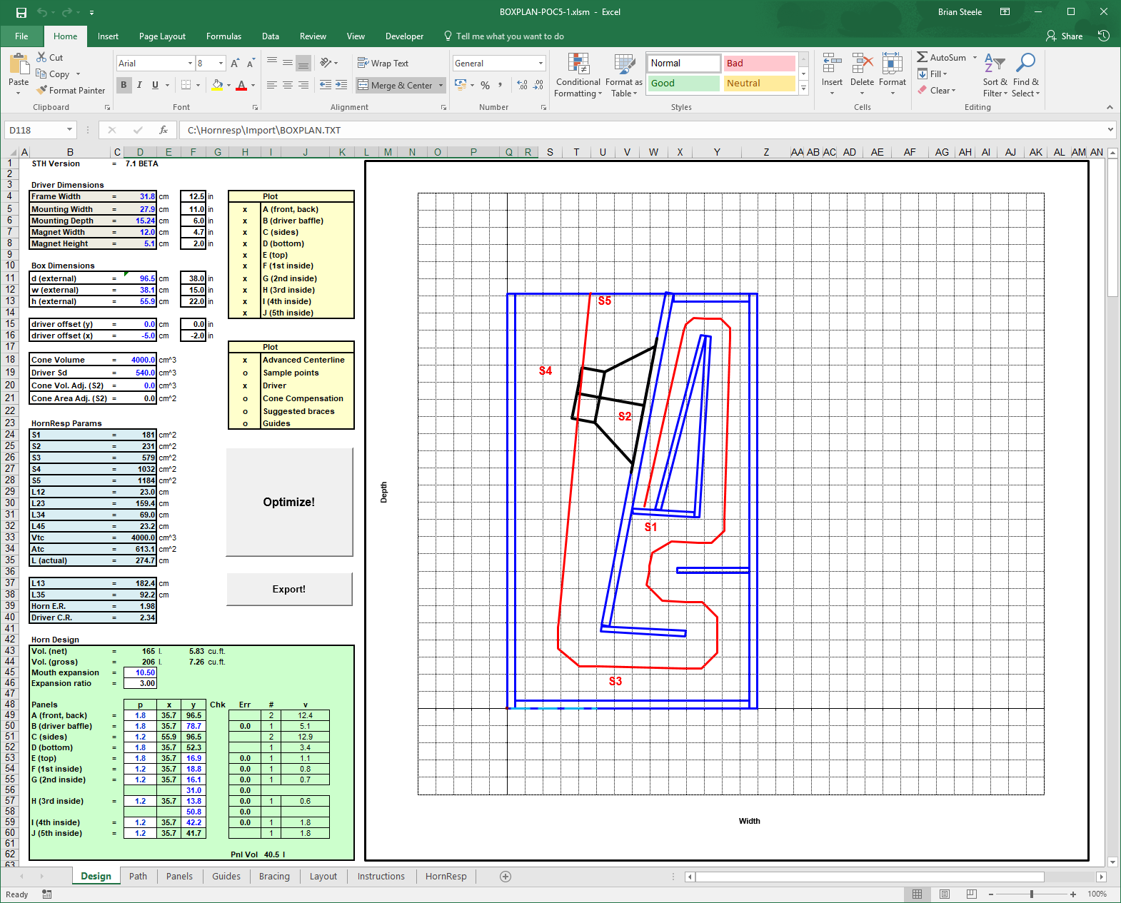

Redoing the "Keystone"....

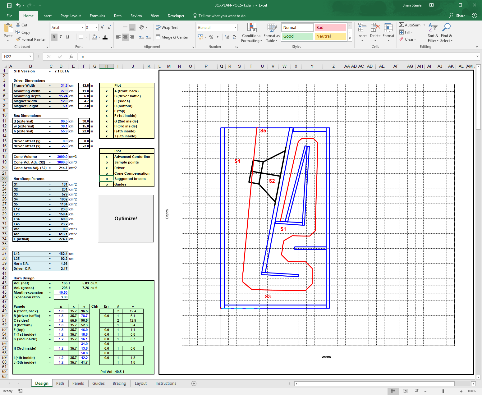

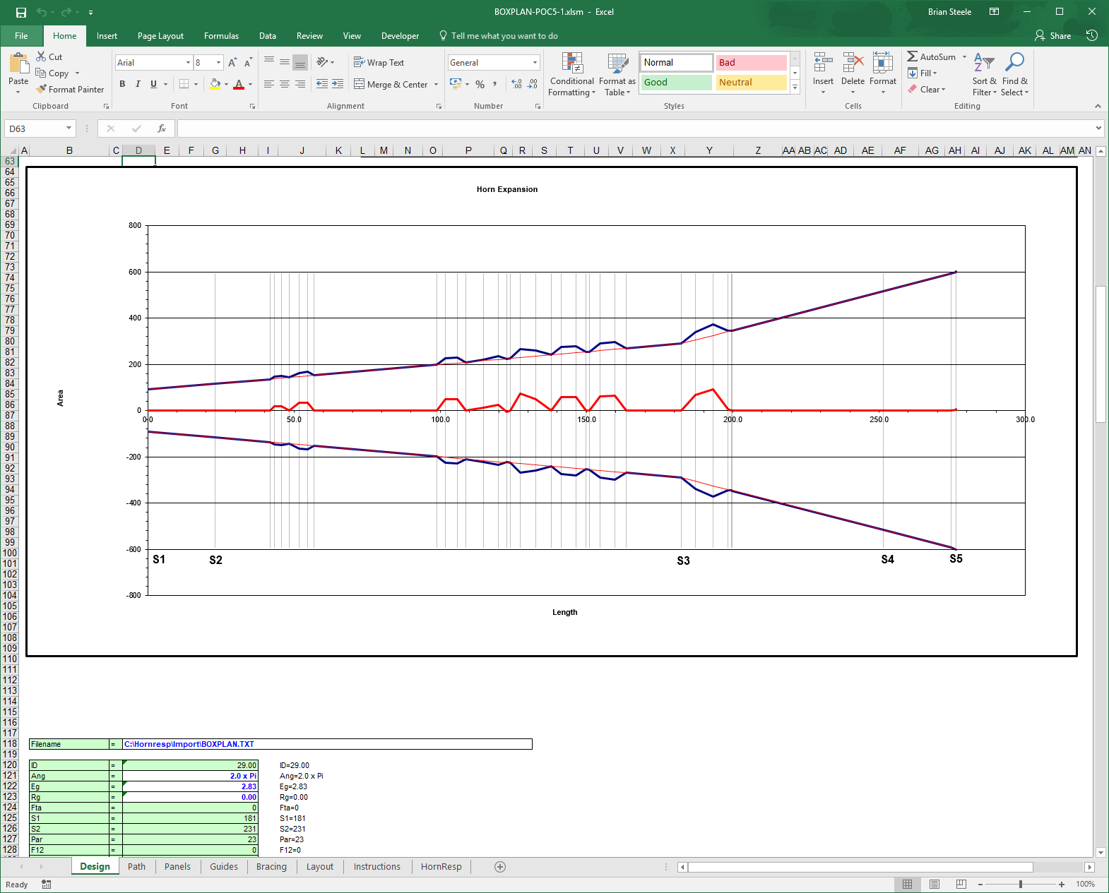

Well, it's been a while since I've posted an update here, so here's one 🙂. I'm working on a design spreadsheet that "improves" (sacrilege, I know) on the Keystone-type build by converting the fold to a dual-expansion TH (that narrows the passband, by increases efficiency), moving the driver to the bottom of the enclosure (to increase stability) and finally lengthening L12 as the longer L12 is, the easier it is to damp out of band peaks by stuffing this section.
The spreadsheet is still a work-in-progress as I've got some unused space (highlighted in the image) in the horn and I'm thinking of including in cone compensation (to address the usual upper dip in the passband that can happen when doing a TH without cone compensation), but this spreadsheet features something my previous spreadsheets didn't feature - Optimization macros! Just put in the desired external measurements and the expansion angle, then hit the "[Optimize!]" button a few times until all the error values in the table reach zero, and you're done. It usually takes about 7 or 8 hits of the button, but the process is quick, and it's certainly faster than trying to optimize the layout by hand. Just don't make any huge changes to the measurements, as the optimization routine has no limiting built in and you could end up with unusual results.
Note that the spreadsheet is unfinished (some of the functions are not working) and of course it contains macros, so you'll have to enable macro execution when you open it, but I've already used it to come up with a 100dB 40 Hz~300 Hz TH based on the Kappalite 3012LF-4 driver that will fit perfectly in my car's trunk for transport 🙂.
Brian,I'm working on a design spreadsheet that "improves" (sacrilege, I know) on the Keystone-type build by converting the fold to a dual-expansion TH (that narrows the passband, by increases efficiency), moving the driver to the bottom of the enclosure (to increase stability) and finally lengthening L12 as the longer L12 is, the easier it is to damp out of band peaks by stuffing this section.
..I've already used it to come up with a 100dB 40 Hz~300 Hz TH based on the Kappalite 3012LF-4 driver that will fit perfectly in my car's trunk for transport 🙂.

Your design sims well, but bears little resemblance to the Keystone, named after the exit shape, not the horn path, which is quite different from yours.
Yup, I had to redo part of the fold, to incorporate the dual expansion. It's a still a W.i.P. as I don't like having unused space in a fold. And there will be more unused space when I incorporate the cone compensation.
Don't understand "moving the driver to the bottom of the enclosure", your layout shows the driver at the top of the cabinet with the exit to the sky. If you lay it down, the design is quite deep, taking up a lot of real estate.
Rotate the image 180 degrees 🙂. The mouth is pictured as firing out the top (bottom!) because it's just easier to sim that way. The mouth can be moved to facing the driver in the actual build, and any response changes should be minor. The builder can fiddle around with the shape of the mouth in the actual build as per the "Keystone" build.

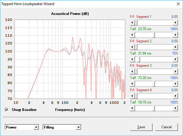

Stuffing reduces out of band peaks as well as in band sensitivity.
If L12 is long, the impact of any stuffing in that section is limited primarily to frequencies above 120 Hz or so and does not significantly affect passband sensitivity. Well, at least HornResp says so 🙂. Stuffing anywhere else in the TH does impact passband sensitivity though.
Based on my experience with using the Eminence 4015LF in the Keystone, the extra sensitivity from the light mms is negated by the gnarly distortion as the cone "doth protest too much" when pushed anywhere near Xmax ;^).
The 4015LF is quite different to the 3012LF, so hopefully my experience is different. In any case, I'm keeping the CR pretty low for this particular design, in the hope I don't run into that problem. Also, by using a spreadsheet to adjust the horn's dimensions can make it a lot easier to modify a particular design for a particular driver.

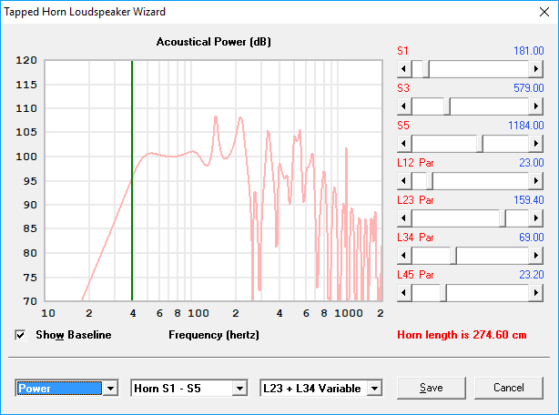

The attached image shows the impact of stuffing L12 for the example TH given in the spreadsheet:
Brian,1)The mouth is pictured as firing out the top (bottom!) because it's just easier to sim that way.
2)The mouth can be moved to facing the driver in the actual build, and any response changes should be minor. The builder can fiddle around with the shape of the mouth in the actual build as per the "Keystone" build.
3)If L12 is long, the impact of any stuffing in that section is limited primarily to frequencies above 120 Hz or so and does not significantly affect passband sensitivity. Well, at least HornResp says so 🙂. Stuffing anywhere else in the TH does impact passband sensitivity though.
4)The 4015LF is quite different to the 3012LF, so hopefully my experience is different. In any case, I'm keeping the CR pretty low for this particular design, in the hope I don't run into that problem.

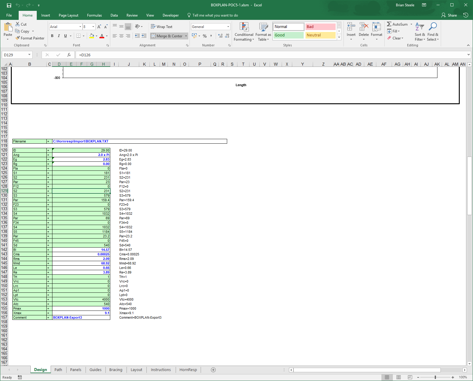

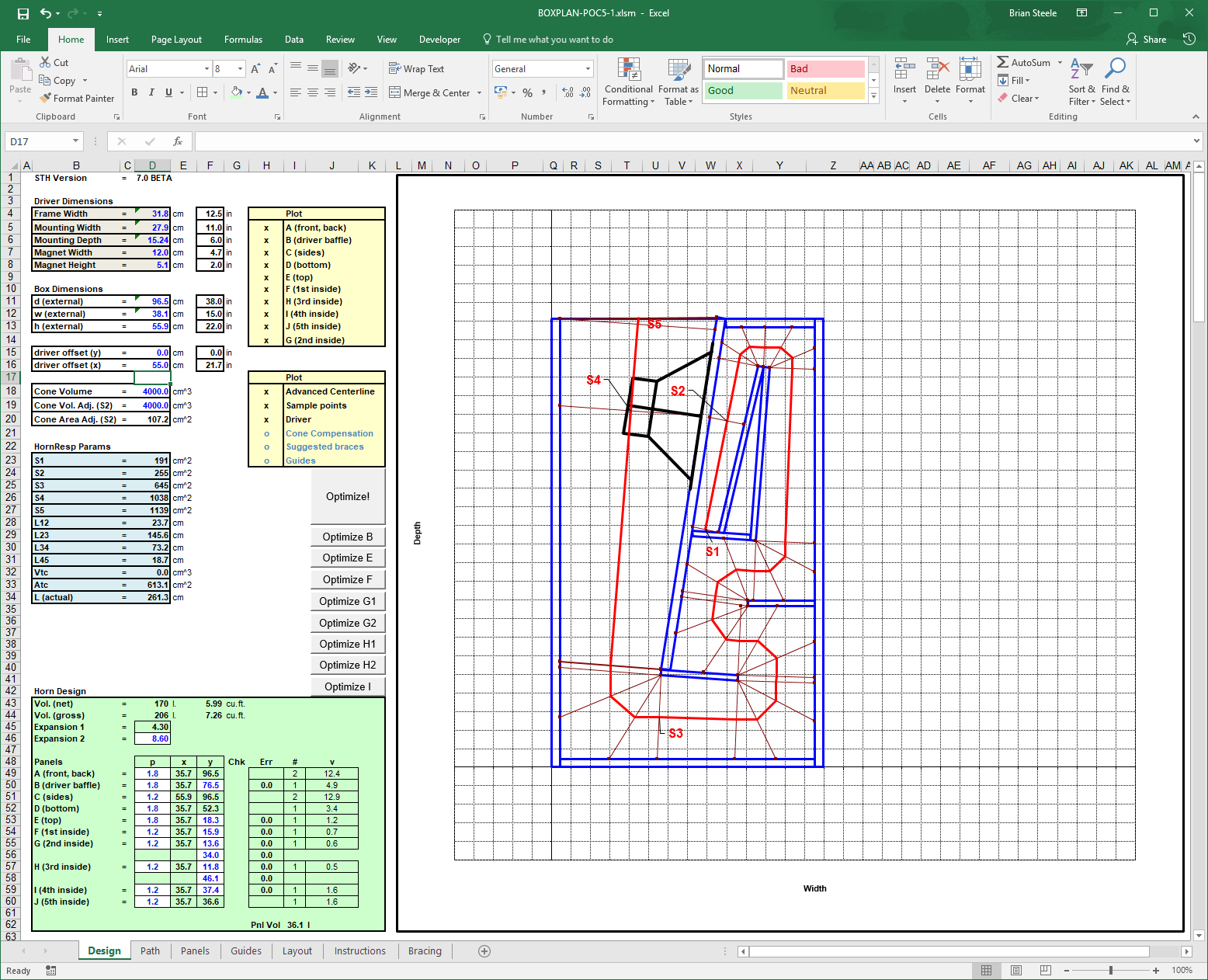

I've attached an updated version of the workbook. There are still a few things that need to be cleaned up (like the "instructions" sheet), but it is usable at this point. It allows you to not only design a dual-expansion TH, but also to set different expansion ratios too. Then it's just a matter of hitting "Optimize" until all "Errors" column is all zeroes, at which point the HornResp data displayed in the workbook's "Design" sheet can be copied to HornResp for further analysis.
I've come across a few interesting things while messing around with it. For example, I tried expanding S1-S2 into the unused space in the center of the horn, but that actually made matters worse - apparently you can have a too-long S1-S2 section. Another thing is that, with a judicious choice of expansion ratios and driver position, you could negate the need to include any cone compensation, which would otherwise be required to avoid having a significant dip in the FR where the third major impedance spike occurs. For the example given, I assumed a front cone volume of 4 liters and zero cone compensation.
I've got a 3012LF on its way to me already. I can't wait to see how it performs in this particular design.
Updated version attached. I did a bit of cleaning up, and now all of the routines on the "Designs" sheet work, e.g. showing how any required "cone compensation" can be included. I've also added a macro that can be used to create a HornResp import file with the information from the spreadsheet ("the "Export!" button). Of course you'll have to enter the driver data and some other information for the export file.

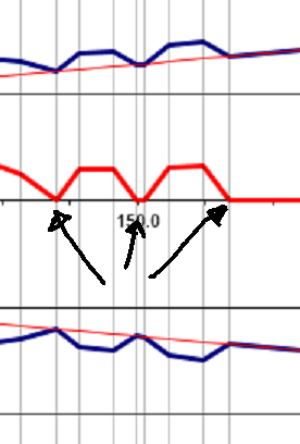

Hi Andrew, while my spreadsheet does ensure continuous expansion around a bend if it's used properly, the size of the expansion "bumps" on the horn expansion graph might be a bit misleading, and the actual expansion around the curves is a lot smoother than portrayed.
Here's why:
For analysis purposes, the spreadsheet calculates the CSA of the horn at points where it can be determined orthogonal to the path through the horn (illustrated by the red line in the image), and the difference between what the spreadsheet measures and what the CSA should be at that point in the horn's path is used for error-checking. However, using the sample points around a bend that were created using the "advanced centerline method" for this purpose is a bit of a challenge though, as the path is not orthogonal to the sample lines at those points, which means that the calculated CSA will be exaggerated. So while the CSA at these sample points are displayed in the graphs (hence the "bumps"), the spreadsheet ignores them in the error analysis.
