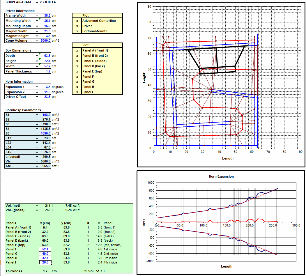

Is there any way you could use your spreadsheet to reverse engineer a sim for dimensions? http://www.diyaudio.com/forums/subwoofers/278424-help-reverse-engineering-sim-tham15ds.html
Brian,
Unfortunately my THAM spreadsheet can currently only model single-expansion THAM THs, and that looks like a dual-expansion one.
Once I've finished work sorting out the bugs in my SS-fold spreadsheet, I could have a look at the THAM one to see if it can be modified to cover dual-expansion THAM folds.

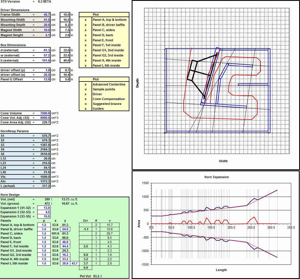

Aargh - bug found in calculation of L45. Fixed in this version.
...and here's an updated version that allows S1 to be set independently of S2. It also has a few more bug-fixes in it.
....and here's an updated version that can do dual-expansion THAM folds...
Arrggh - forgot to update it with the HornResp output.
There's still some issue somewhere however. The corresponding HornResp sim is slightly larger than the net box volume given in the spreadsheet. I suspect it's something to do with how I'm calculating S5. I'll have to check it again during the week when I get a chance.
Here's an updated version of the THAM spreadsheet. It fixes one minor bug (calculations for panel H) and adds a few features.
Note that the spreadsheet (as per previous versions) includes the option to top-mount or bottom-mount the driver. Of course, if the driver is top-mounted, the top of the enclosure will need to be made removable. Based on my experience with POC2, I suggest that you never, never, never do this. That particular section needs to be well-braced to get the best results, and it's impossible to do so and have a removable driver access panel at the same time.
Another updated version of the THAM spreadsheet. This includes a few more minor bug-fixes and now includes layout guides

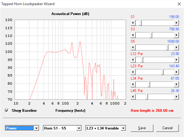

Hi. I'm completely new to this. Can someone explain what order I need to use these different tools in?
I have Hornresp, I've entered all the Thiele-Small Parameters etc. I hit calculate but not sure what values I should be exporting into the Boxplan spreadsheets.
I notice that the S1-5, L12-45 etc. etc are not calculated in Hornresp, so I'm assuming that I need to set at least some of these myself to indicate a folded tapped horn design. I have no idea what to do next.
The driver I'm using is a Dayton Audio RSS315HF-4 12".
Any pointers would be hugely appreciated!
