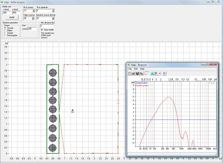

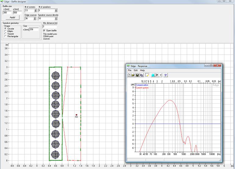

Thanks for the info. Ran some sims in edge as suggested.

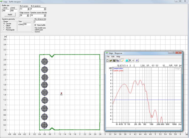

I compared the effect of woofers on the edge of a very large baffle, to woofers near another large panel (approximately, since edge doesn't have capability for multiple baffles). Seen in largebaffle.jpg vs splitbaffle.jpg
Greatest changes were at low frequencies, with little shift in the dipole peak.

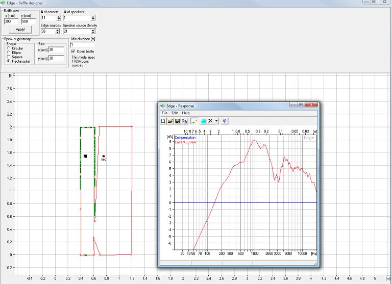

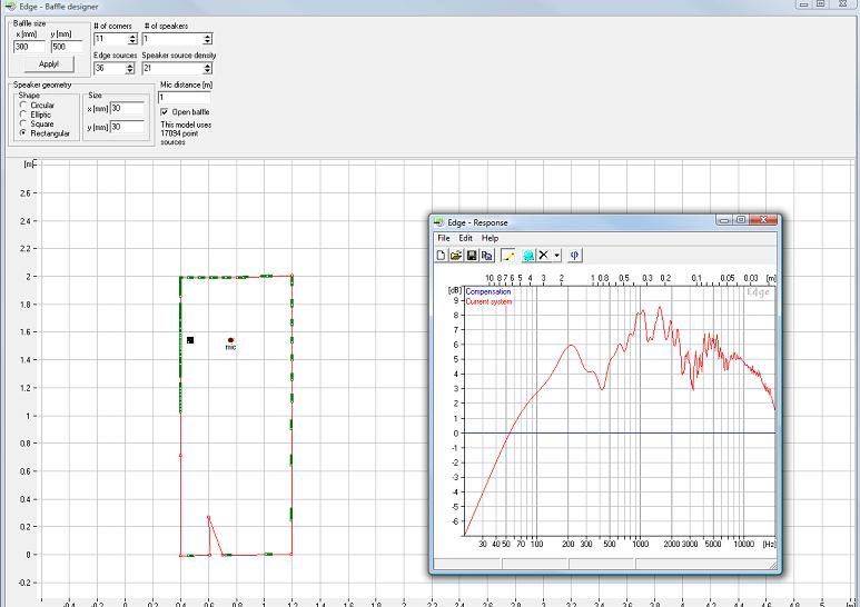

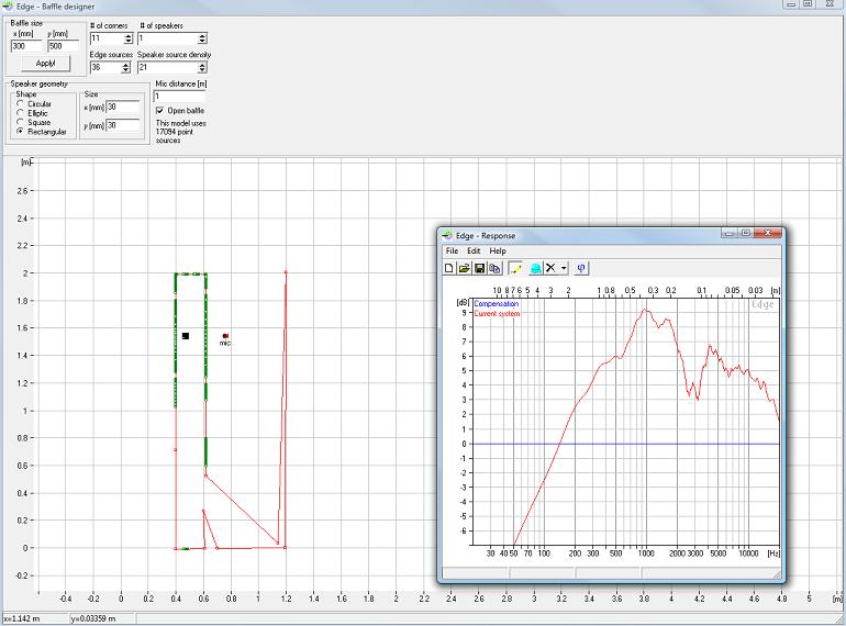

Looking at effects of a gap between panels on high frequency response:
Comparing first two images indicates (according to edge) that leaving a gap between panels is effective for dipole cancellation at high frequencies.
third image - combining the panels results in primarily low-frequency gain.
I didn't show results for arrays, because it seems edge is over-estimating comb-filtering, at least as I had set things up.
