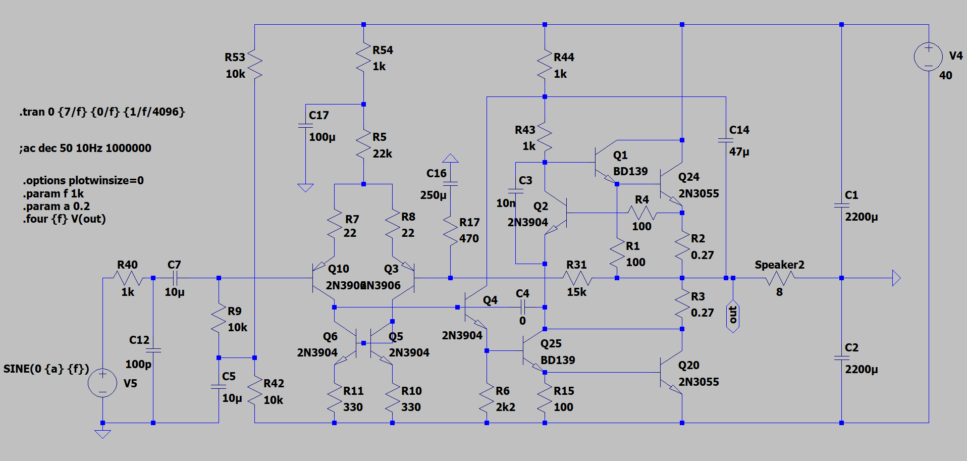

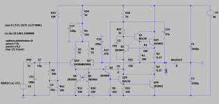

Here is my last version:I can attach an LTspice schematic at some point but for now, how about (referring to your original schematic):
2k2 resistor: one end to +20V, other end to lower end of R1. Let's call this new node "Vcc/2"
Another 2k2 resistor: one end to Vcc/2, other end to -20V
A capacitor, probably 100uF 35V, in parallel with the second 2k2.
R72 as described by Osvaldo
-v pin of C3 to -20V or Vcc/2, I haven't modelled the latter.
Regarding DOZ, yes I may well end up using that, but for now I'm looking at the updated JLH with two pairs of output transistors:
https://sound-au.com/tcaas/jlhupdate.htm
Sure, but it's not as important as the current mirror. Either way, the IPS needs one or both to remove supply voltage dependencies.What about changing R5 by a CCS?
Now that I have the single supply class A ( Thanks Osvaldo de Banfield, Rory Christ,Steveu, bremen nacht), I will make some adjustments , to test adaptive bias (AKA sliding bias). 🙂
If there is a chance for the speaker to be disconnected, rememer put a large resistor (1K suffices) to mantain the output cap charged and prevent pops when reconecting.
