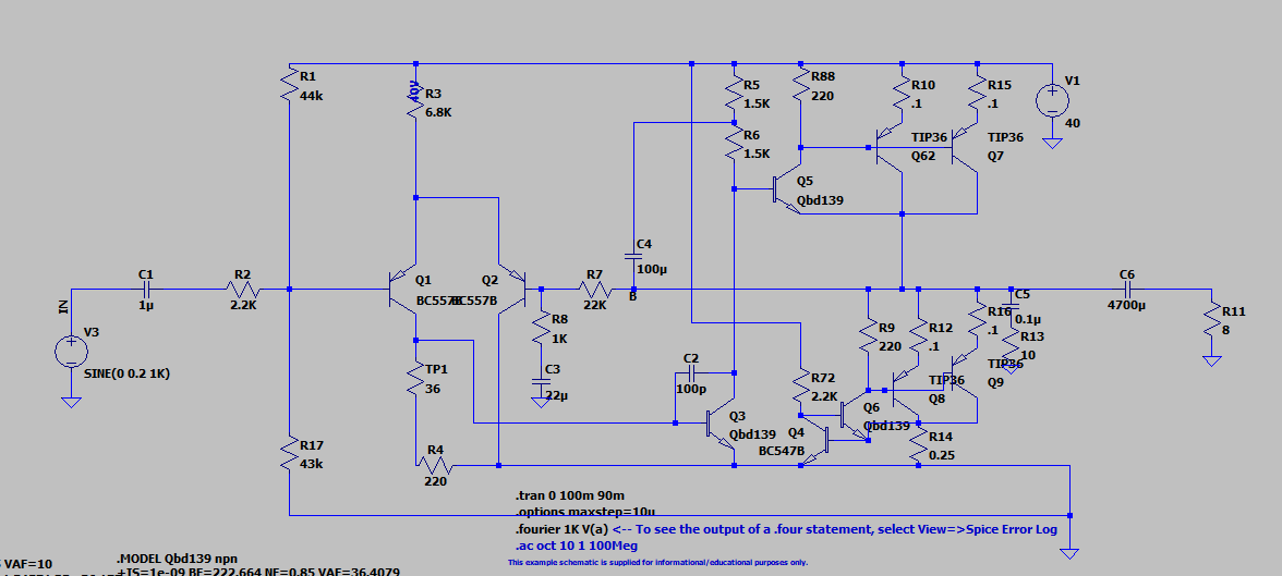

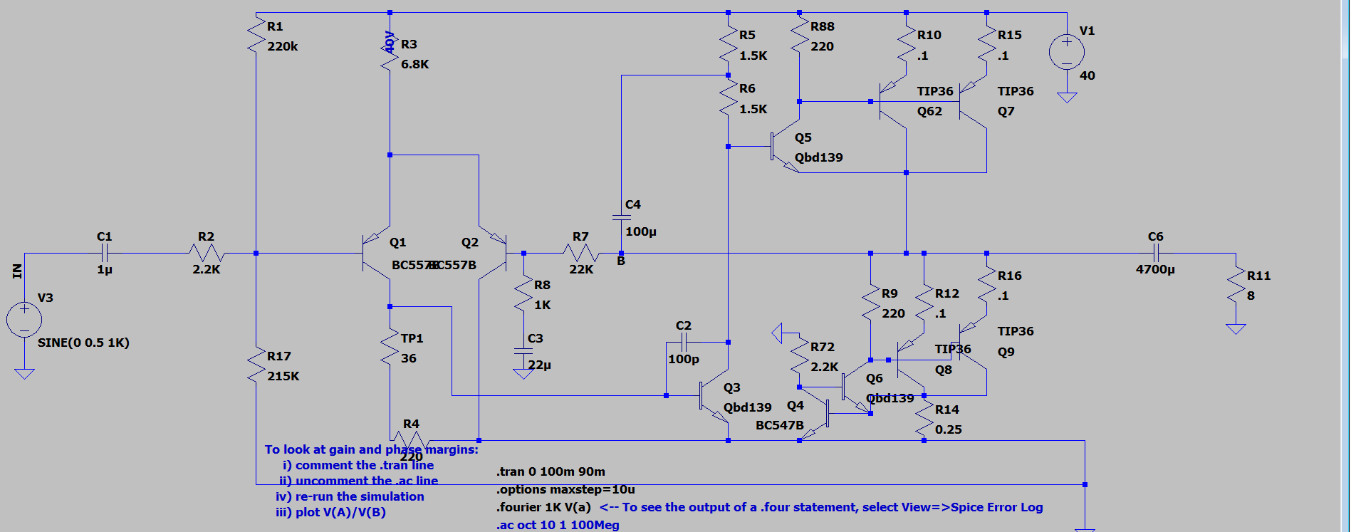

I can attach an LTspice schematic at some point but for now, how about (referring to your original schematic):
2k2 resistor: one end to +20V, other end to lower end of R1. Let's call this new node "Vcc/2"
Another 2k2 resistor: one end to Vcc/2, other end to -20V
A capacitor, probably 100uF 35V, in parallel with the second 2k2.

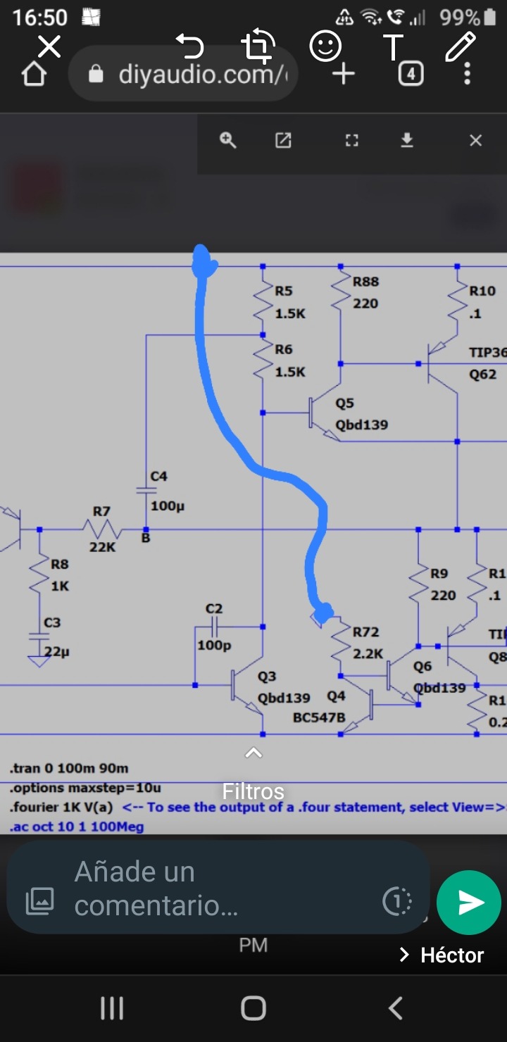

R72 as described by Osvaldo
-v pin of C3 to -20V or Vcc/2, I haven't modelled the latter.
Regarding DOZ, yes I may well end up using that, but for now I'm looking at the updated JLH with two pairs of output transistors:
https://sound-au.com/tcaas/jlhupdate.htm

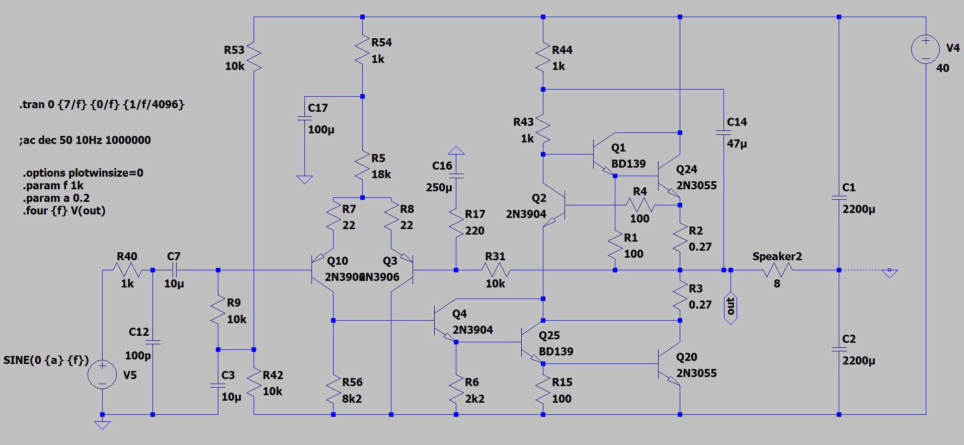

Here is my last version:
It seems to me that 10mA for the input divider (40V/4.4K) is too high unncessarily. I would use 47K.
The ripple rejection can also be done as in vintage circuits.
