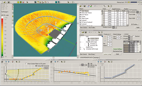

In really big events, you can use delay towers. (For those not familiar with live reinforcement, a delay tower is a second smaller system that is set up further down the audience area and it is fed electronically delayed signal so to 'echo synch' with the main system, and not make it sound as a repeat echo.) Also, if we are not talking huge gigs, most line array systems can through coherent enough SPL from top row to last row if hanged and aimed properly. There are software and optical aiming means that come as standard accessories with serious line array systems.
