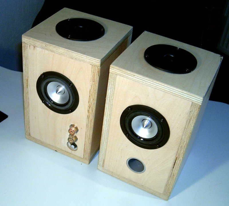

In the picture, as copied by a Dutch DIYer who's driving them with a Hiraga amp. The originals have a slot port, no tw sensitivity selector, and an Audax 0.75 inch tw inset with a router.

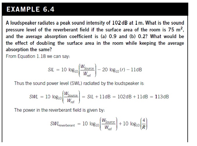

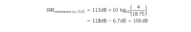

from "Acoustics and Psychoacoustics" by Howard and Angus, 4th ed., Focal Press 2009, Chapter 6: "Hearing Music in Different Environments"
(an average absorption coefficient of 0.2 is typical for a typical domestic listening room and it corresponds to a RT60 of around 0.4 s)
it follows that the SPL produced by a loudspeaker in a typical domestic listening room at any normal listening distance is 4 dB higher than it's measured SPL output at 1 meter distance

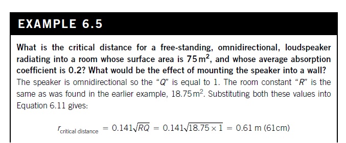

The addition of the "hanging around" reverberant field?
I do not know but do these coefficients correspond to a rather "live" room?? Seems likely... like a tiled bathroom, very reverberant?
_-_-bear
definitely a typical living room according to Professors Howard and Angus

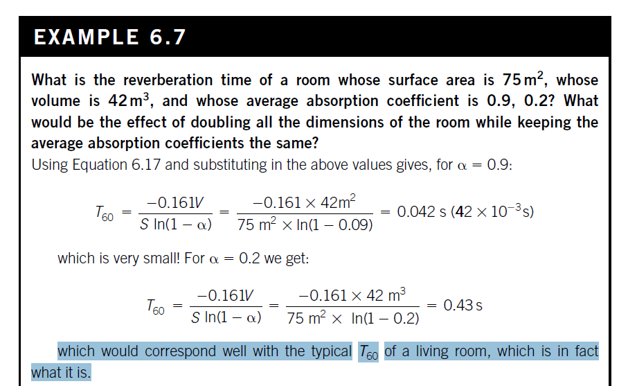

actually their calculations are much more conservative than those of the authors of the handbook from the Swedish Royal Institute of Technology linked before in this thread here
