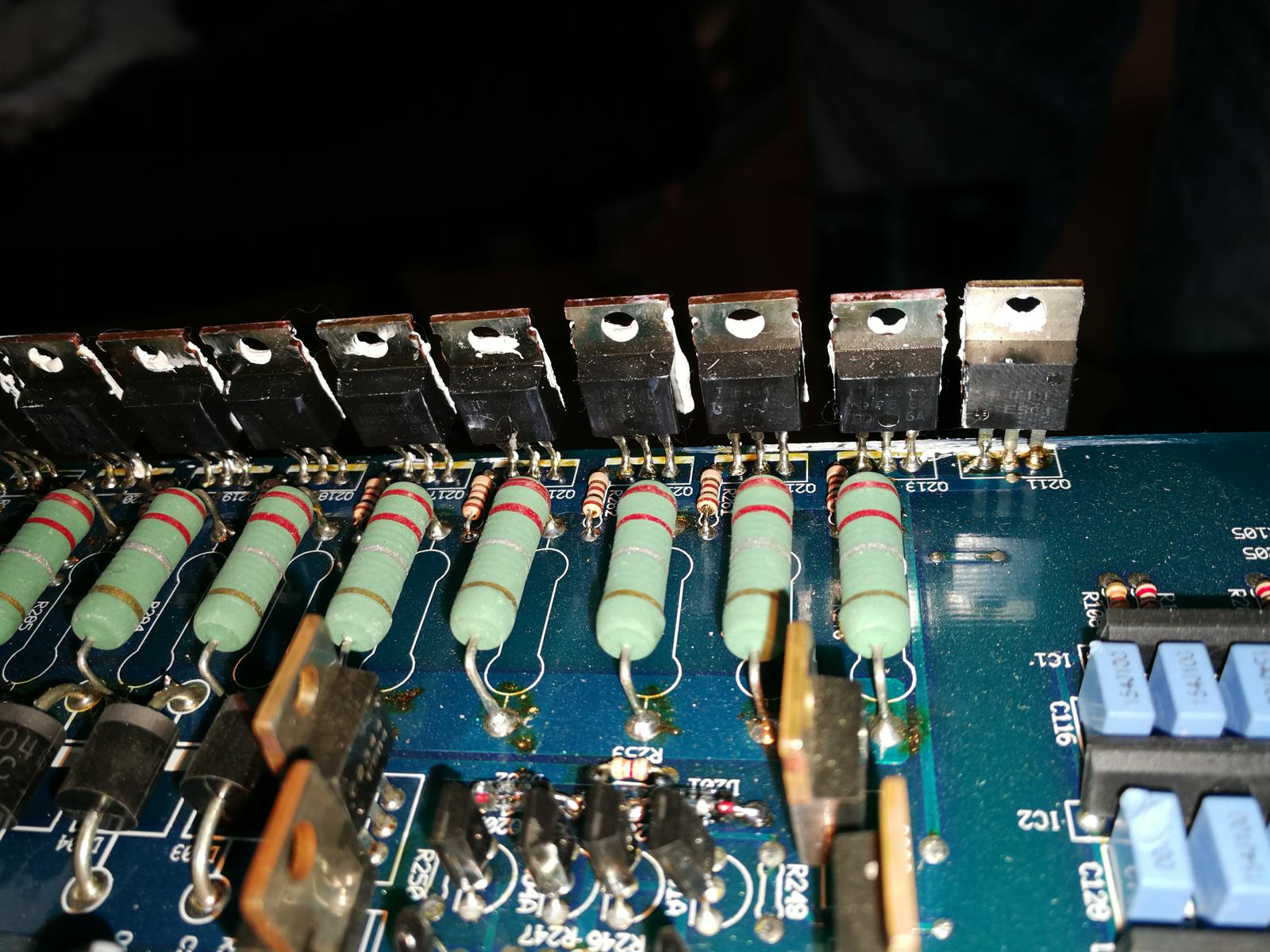

i have a S-6002 2 Channel A/B amplifier.
The Transistordrivers get really fast very hot, the current starts at 2,4A and go in 10 Seconds higher than 4.5A. Then i remove the remote signal, before it gots more damage.
Any Idea? Measured +- 22V DC in OP-Amp Voltage.

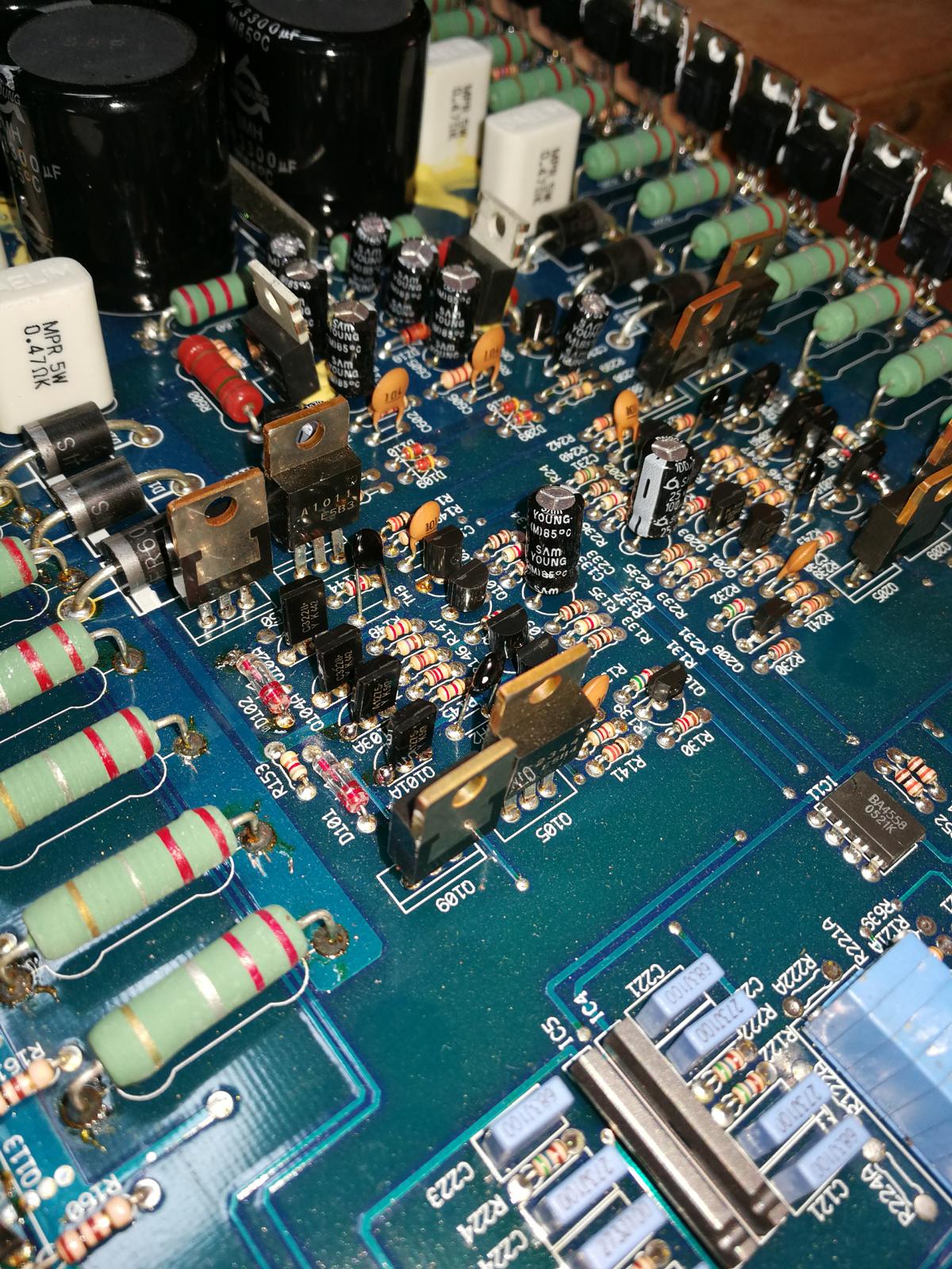

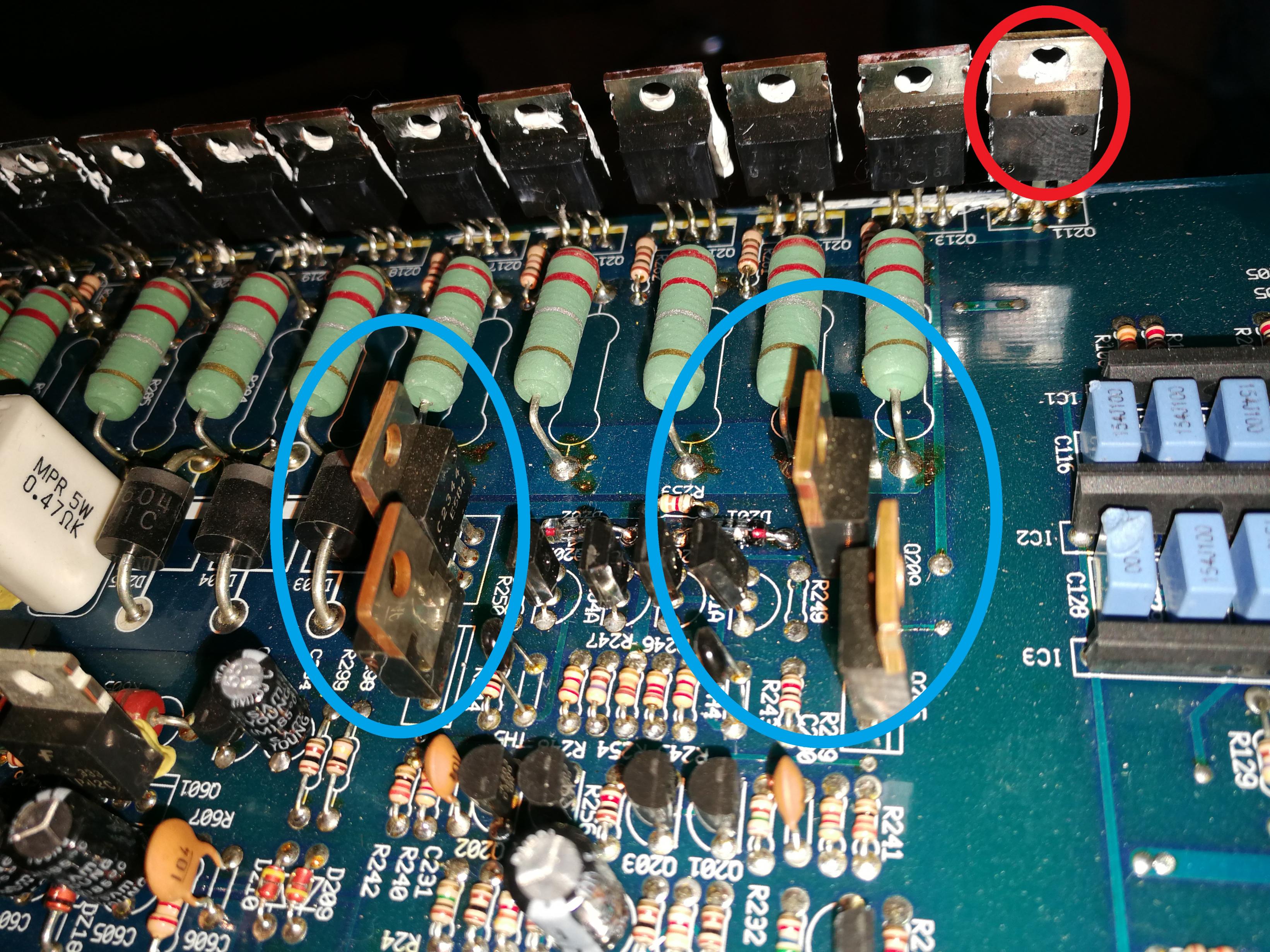

Then the pre drivers start heating up more and more. They start really fast to smell. Current also rises. I've desoldered every part in Pre-amp and testet separate. Found nothing bad.
Im not sure if the 22 Volts are correct.
When i clamp the red ringed drivers down to heatsink, the blue ringed starts to get hot until they start smell.
I think there is any problem i don´t find.

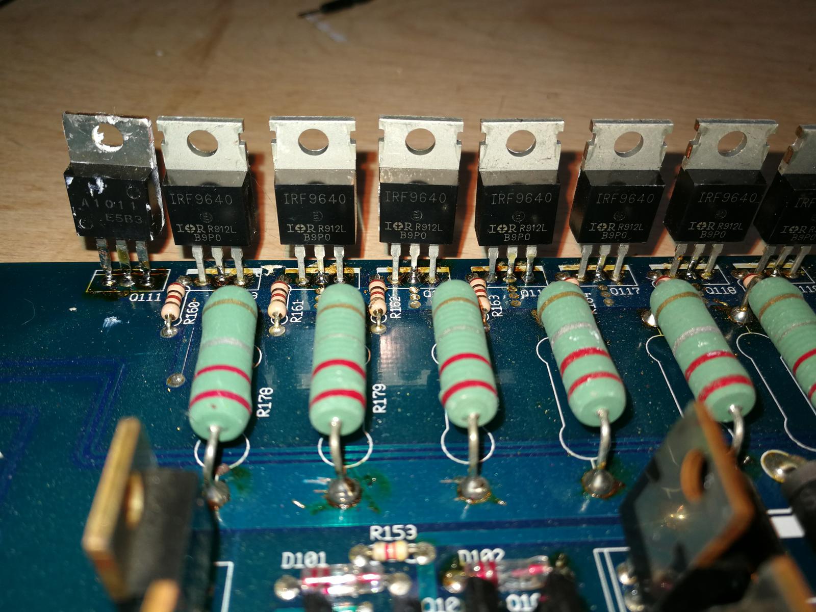

With mounted outputs, it starts direct with around 8A and rises fast. Under 1 second the drivers hot. outputtransistors still cold.

What's in your opinion the best way start to search?
Remove all outputtransistors?
I think it is only on site. I changed all outputs (both sides)
Regulators are tip41c and tip42c.
Think they where regulated from zener diodes.
