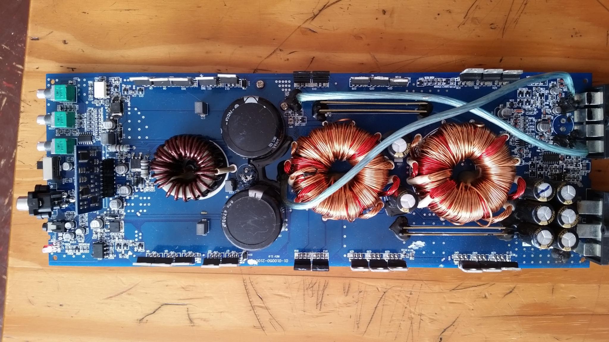

I have this 1500D which fickers between red and blue led so in and out of protection, only visible damage was the 2 22uf non polarised electrolytic capacitors that had swelled and popped the tops, all output fets and ps fets check fine and driver board works in another 1500D ive replaced the 22uf capacitors but amp still cycles between red and blue led and the output fets get hot.

Well doest seems like difficult, big amp. I would remove rectifiers and power it up without them. After that would check the voltages of PS PWM.
Everything checks fine till i plug in audio driver board, the audio driver board is fine as ive used it in another amp
