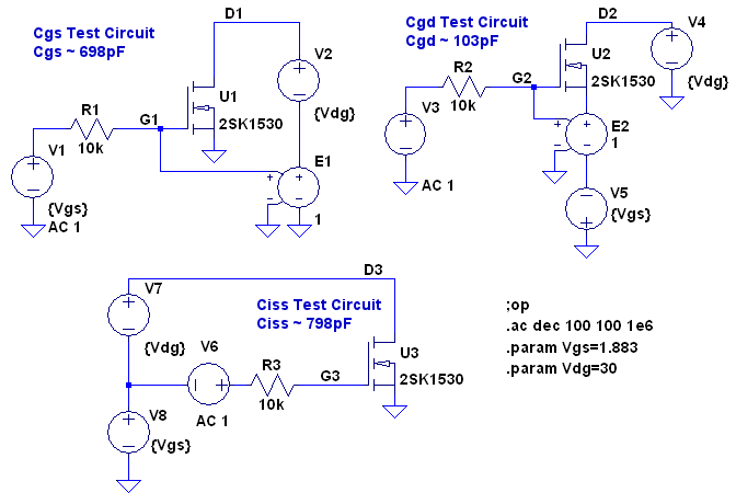

Nice simulation job! The changes you mentioned should not make a really big change in the behvior of the amplifier, so these simulations should be reasonably relevant.
Where did you get the SPICE models for the 2sk1530 and the 2sj201. If you can, please email me a copy of them at bob@cordellaudio.com.

Hi Bob,
I made a small mistake. 7ppm refers to a slightly different version of your amp, i.e. 2 pair of MOSFETs (they were superimposed on each other, so I overlooked it). Furthermore, the main power supply was +/- 40V in stead of 35V and Po was 85W in stead of 50W.
Here are more correct figures, although with 2SK1530/2SJ201 in stead of IRFxxx:
THD @ 20kHz and a measuring bandwidth of 200kHz
Po = 0.5W -> 1.45ppm
Po = 5W -> 4.16ppm
Po = 50W -> 6.24ppm
As you can see, my simulator is quite in his element when sniffing at your amp. 🙂
Cheers, Edmond

Thanks Bob.
The models are home brew and running only under Micro-Cap V8. They are partly based on the BSIM3 model (level 8) and partly on a couple of diodes representing Cgd and Cds.
Which simulator you are using? If it's LT-Spice for example, I'm afraid my models are of no use to you.
Please, let me know.

Hi Edmond,
I've done some capacitance sims and the Cgs of the device is indeed much higher than the external capacitance added in the subcircuit, just as you say. I have never studied the BSIM3 model, so at the present time I have no clue how the internal capacitances of this model get calculated. The circuit below shows three simulations - the first for Cgs, the second for Cgd, and the third for Ciss as a sanity check to make sure the computed Cgs and Cgd add up to Ciss. DC drain currents in all three circuits are 150 mA, and the DC value of Vdg is 30V in each case.
The first circuit (FET=U1) bootstraps the drain voltage so the total instantaneous Vdg is a constant 30V. This eliminates Cgd. The bandwidth at G1 is calculated, and Cgs is computed from the gate resistance and the -3dB frequency at G1.
The second circuit (FET=U2) bootstraps the source so that the total instantaneous Vgs is a constant 1.883 V, the voltage required to get 150 mA drain current. This eliminates Cgs. The bandwidth at G2 is calculated, and Cgd is computed from the gate resistance and the -3dB frequency at G2.
The final circuit (FET=U3) just grounds the source, sets the DC gate voltage to 1.883V and the DC drain voltage to 30V above the gate. The bandwidth at G3 is calculated, and Ciss is again computed from the gate resistance and the -3dB frequency at G3.
This was done for the 2SK1530 and the 2SJ201. The results are as follows:
2SK1530: Cgs = 698pF, Cgd = 103pF (Vdg = 30V and Vgs = 1.883V)
2SJ201: Cgs = 1120pF, Cgd = 231pF (Vgd = 30V and Vgs = -1.937V)

Hi Andy,
Cgs is a bit lower than the Toshiba specs, but these were measured at Vgs=0. So, would you be so kind to run some more simulations, now at Vgs=0?
Apologies for my 'laziness', but I'm unfamiliar with LT-Spice, that's why I'm asking you.
Cheers, Edmond.

Hi Edmond,
Sure, no problem. The results are:
2SK1530: Cgs = 886pF @ Vgs=0, Vds=30V
2SJ201: Cgs = 1439pF @ Vgs=0, Vds=30V
BTW, the Berkeley BSIM models look pretty comprehensive. Sub-threshold conduction, woo woo! There was no documentation on them in the LTSpice help, but I found a whole lot of stuff at the Berkeley BSIM web site. I downloaded the manual for BSIM 3v3. It's 205 pages! Yow.
Andy
