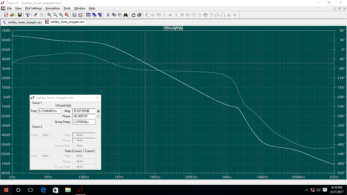

I have a couple of questions on the plot posted by De Oc:
Q1.)
Post1434 shows the 0degrees in the middle of the right axis. Normally we see this middle point labelled as 90degrees or 180degrees and we have to do a bit of arithmetic to arrive at the Phase Margin (PM). But in De Oc's plot it looks like the plot is already scaled to read off Phase Margin.
What has been done to allow this direct reading of PM?
Q2.)
It looks to me that this amplifier has a low open loop gain.
If we set the closed loop gain to ~+24dB, then that level would cross the OLG curve @ ~ 20kHz.
Does that mean that there is no excess gain @ 20kHz and thus no negative feedback @ 20kHz to reduce distortions?

The gain plot is not "open loop gain", but "loop gain", i.e. the gain around the loop, when the loop is closed at all frequencies. Disturbances are attenuated by this loop gain. To attenuate distortions of a 20 kHz sinewave requires decent loop gain at the harmonics, i.e. 40, 60, 80 etc. kHz.
I would have expected a higher unity gain frequency, and the gain curve does look somewhat odd for a hifi amp. Could this be an opamp or IC amplifier since the low frequency gain is ~60dB.
The schematic says it's a mod of a Toshiba amplifier. Can't see the top half of the schematic so can't really say why the low-frequency gain is limited. The high-frequency gain plot (for gains above ULGF) is not "correct" as the loop gain is measured using just a voltage source in the feedback loop, instead of a Tian or Middlebrook probe which use a current injection also.

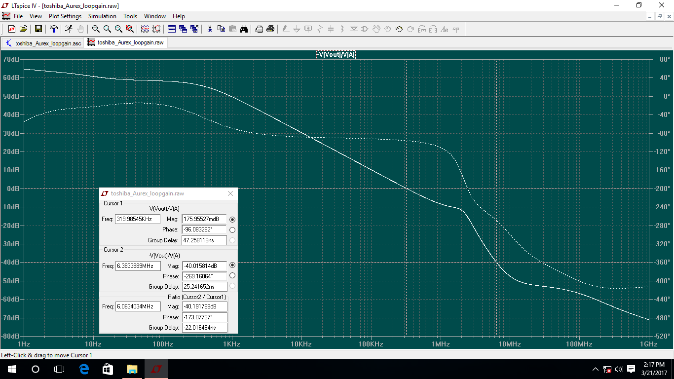

Hi John,
If you are referring to post #1434 [per AndrewT query above], it was derive from an old bootstrap design of Toshiba [Aurex SBA-50]. The plot was the result following the example on LTSpice audioamp.asc tutorial. Attached was another approach following a discussion from another "plotting phase margin thread" by forum members, [dadod, neutrality, bonsai & others]
If I understood Sir Bob Cordell correctly, left image cursor 1 is at 0db and it corresponds to 96deg. To calculate -180-96=84deg [84deg being the phase margin] . To validate, the amp has a closed loop gain of 35db then dragging the cursor to find 35db in the graph and 35db corresponds to -86deg.
Finding the gain margin, left image 2nd cursor falls at 360deg and it corresponds to -40db. To calculate, -40db minus closed loop gain and that should be -40-35=5db gain margin.
Correct me if I'm wrong.[non technical mind here 🙂 and still getting the grip of it]

Hmmm..something is not right, I think I have dragged the cursor a little over 35db, phase falls at 86deg instead..

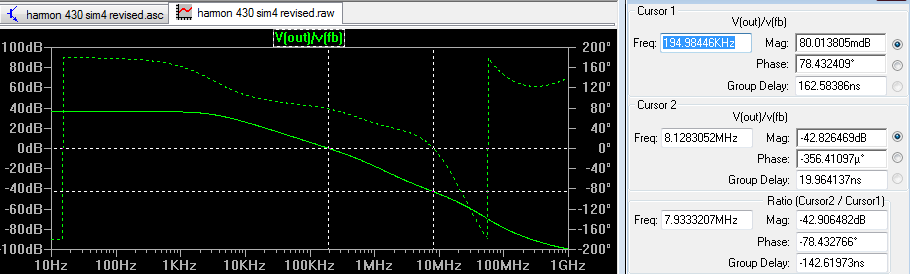

Q1.)
Interesting! I opened up my LTSpice and been able to do it this way:
(1) Untick the "unravel branch wrap" on the phase plot. This makes the 0 degree in the middle of the right axis.
(2) Manually change the top scale of the left axis (equal to the lower limit) so the 0 dB is also in the middle of the axis.
(3) Save the plot setting may be???

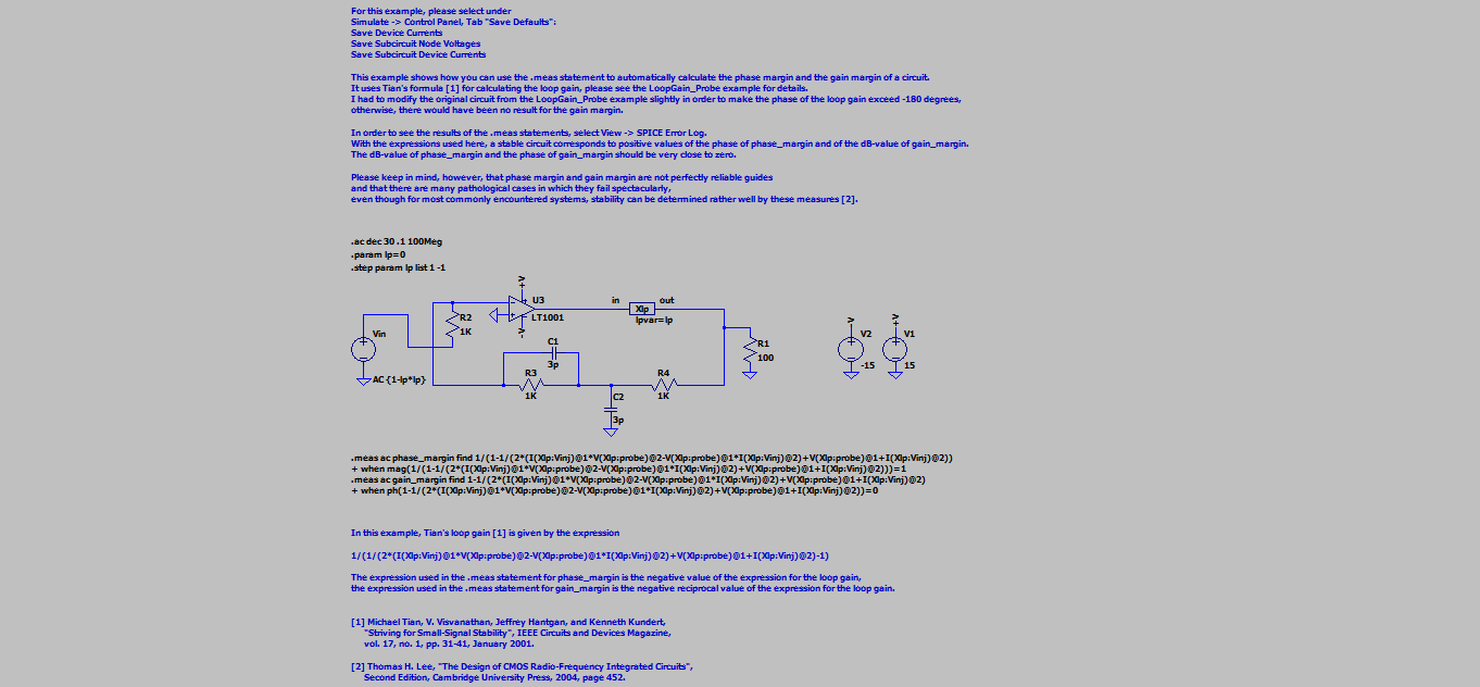

I see your point here, guess I need to scan back the thread, below was member andy_c's teaching it does involve the Middlebrook Tian probe. There is one LTSpice method that actually uses .measure directive [no plotting of graphs needed] but finding the correct variables is too hard for me.
"So, to sum up:
1) Look at AOLB = loop gain = -1/(1-1/(2*(I(Vi)@1*V(x)@2-V(x)@1*I(Vi)@2)+V(x)@1+I(Vi)@2)) to analyze stability.
2) Find the frequency for which AOLB is 0 dB. This is the unity loop gain frequency.
3) Find the phase shift of AOLB (call it phi) at the unity loop gain frequency.
4) Compute the phase margin from phase_margin = phi - (-180)
...from andy_c
When you do it with that trick of aligning 0 dB with 0 degree, make sure you plot "v(out)/v(fb)" instead of the normal "-v(out)/v(fb)". Otherwise you are looking at the phase at the LF or left side of the positive gain side (if not careful).

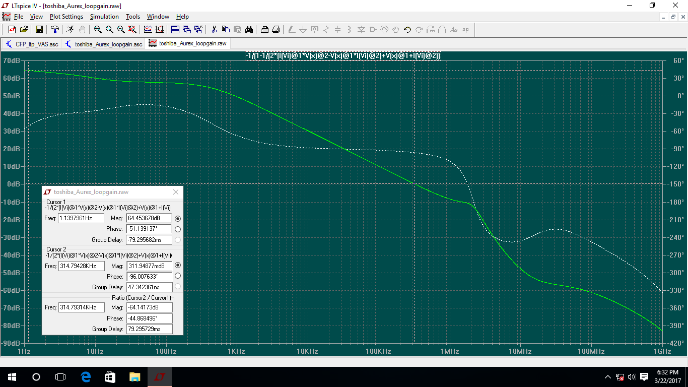

Ok I think I got it sorted now. Following andy_c's teaching, here's what I got from my Aurex mod amp.
OLG = 64.45dB
ULGF = 314.79KHz
-96° - (-180°) = 84° PM
Method was Middlebrook Tian probe. According to andy_c it takes into account all impedance interaction. Gain margin cannot be calculated here as 360° does not correspond to 0dB.
Does not seem to be very good figures but anyway...🙂

Allow me to clear myself, after seeing how the more experienced simulators do it, gain margin can actually be plotted. Dragging cursor 1 lower to find 180° phase [via plot window and not aligning with the reference phase no. in the graph] and the corresponding dB is the gain margin. In my plot it was -12dB.
Hope I've done it clearly now, sorry about this.
