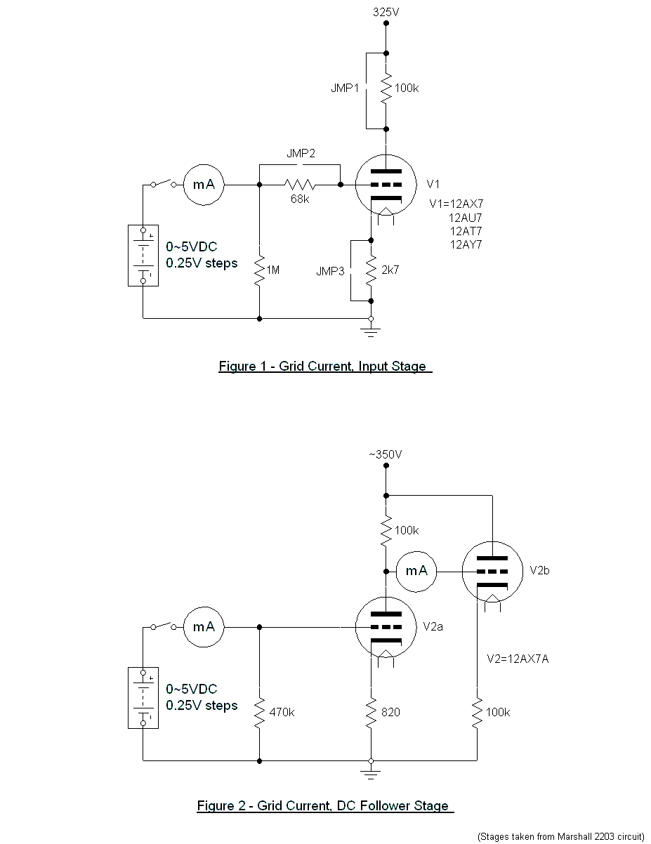

Frustrated with lack of grid current data on popular SE tubes for guitar amps, I am proposing to conduct the following testing.
A number of years ago I converted an old monster of a 100W Traynor head to a Marshall JMP Lead "2203" circuit. I intend to take it apart in order to allow some probing and use it as my test bed. The intention is not to obtain plate curves, just Grid curves in the overdrive regime.
Included here is a diagram of the input and DC follower stages that will be tested.
Test1: Figure 1, all JMP's=IN. This will obtain pure IG vs. VG.
Test2: Figure 1, JMP1=OUT. This will hopefully indicate how IG is affected by a dynamic reduction in the plate voltage (IG should be higher than in Test1).
Test3: Figure 1, JMP1 and JMP3=OUT. This will indicate how IG is affected by both a dynamic change in VP (plate voltage) and VK (cathode voltage).
Test4: Figure 2. This test of the DC follower will show IG for not only the gain stage (in a manner similar to Test3), but also the steady-state and dynamic IG of the follower.
Any feedback or suggestions is welcome.
Will this data be useful/valid? Am I missing anything? Is this a waste of time, "do it the right way"?

I wonder however if Marshall "screwed up" or did this intentionally (see my Figure 1 above). Assuming Fender was and is the "standard", 68k is not the correct value. If one studies the input jacks closely, the two 68k's end up in parallel when input 1 is used, therefore the input grid stopper is really a 34k resistor. When input 2 is used, the Rin drops to 136k, and the two resistor form a 6dB pad. This input was meant for "line level" equipment, or a heavily degraded guitar tone.
But yes, this resistor determines 99% of the input noise of the amp (and rolls off the high end).
