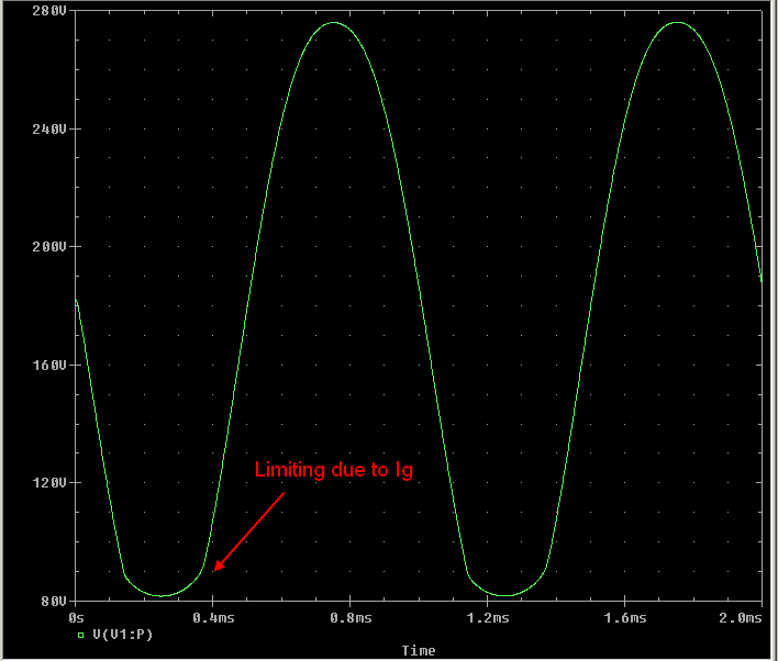

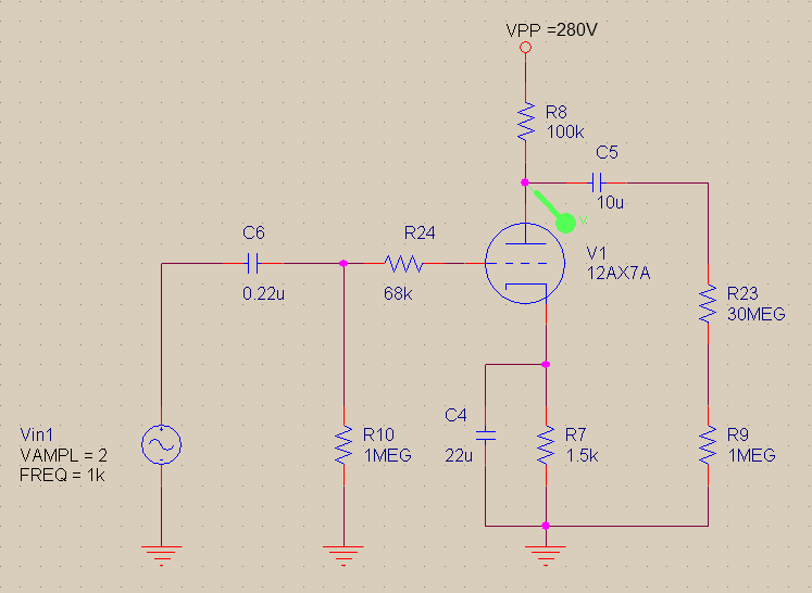

Poynt99 :
Yes, a 12ax7 will flatten out like that with 2 volts input for sure, that is a high input for that tube. It will also round out at the top. If you run that simulation again at 1 volt input you should see little flattening and almost as much output. The 2 volts is just too much, don't for get the cathode resistor is bypassed and you are getting the full gain of the tube.
Or you could remove the 68K resistor.
By the way, is this circuit copied from something, or is it just something you put together to test the model ?
I only ask because the 68K resistor is not really necessary ( except to show up grid current ), and the 30Meg and 1 Meg resistors, and the 10u coupling capacitor are a bit high in value.
I suspect the 68K resistor is a grid stopper to filter out RF.
I usually use 10K in my designs.
If a little distortion is not a problem then why worry about grid current at all?

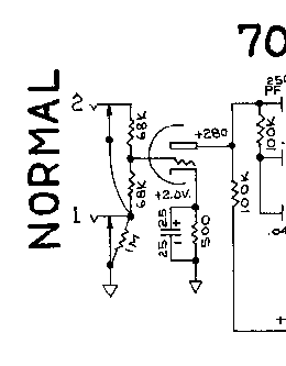

I was just thinking about this today.
I wonder however if Marshall "screwed up" or did this intentionally (see my Figure 1 above). Assuming Fender was and is the "standard", 68k is not the correct value. If one studies the input jacks closely, the two 68k's end up in parallel when input 1 is used, therefore the input grid stopper is really a 34k resistor. When input 2 is used, the Rin drops to 136k, and the two resistor form a 6dB pad. This input was meant for "line level" equipment, or a heavily degraded guitar tone.
But yes, this resistor determines 99% of the input noise of the amp (and rolls off the high end).
...the input grid stopper is really a 34k resistor.
Okay, that makes the thermal noise voltage a whole 3 dB better.
