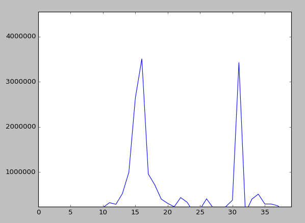

"A Simple Matter of Programming" (TM), one could use a Raspberry Pi
Very simple, RPi should work fine. The cart still has output at .5556Hz the lowest frequency in the system. The frequency spectrum will show a peak there. This is a plot of the low end of a 28sec sample, the signal would be in bin 15.556, you could use a 9sec sample and it would be centered in bin 5. RPi should have no problem with the 864,000 point FFT.
Figuring out a way to start the sample at the same point and the phase of the 0.5556 Hz signal gives you the axis of correction, if it gets below the noise one might argue it no longer matters.
