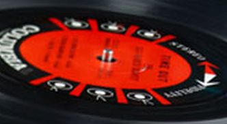

Maybe, but probably not very practical. How long before successful alignment each time you play a record? With a pencil line it's permanent...throw it on and push it in place.I have a much better solution. I have a removable spindle on my record player. In spec and adjustable all in one. Does that make mine superior by design?

It's a roksan xerxes. Attached pic is best I could find in a rush to show how it looks with the outer spindle removed.

I don't see where "adjustability" comes into play. The idea is to remove the spindle after centering the record on the platter. So I understand your previous statement where you said you could also use a pencil. I was imagining an off center spindle which you would rotate, moving the record til it was concentric. 😉It's a roksan xerxes. Attached pic is best I could find in a rush to show how it looks with the outer spindle removed.

😎The proper solution, of course, is to fill original hole (epoxy?) and redrill properly.
In case it´s not clear: drill a new hole in the proper center 🙂
You must realize that will not work except for one side onlyI already answered on post #12 😀
You put the record on at the nominal centre (if it were made correctly). You then pull the outer spindle off and have all the adjustability you need. I did look at an off centre spindle, but it's hard to get the accuracy unless you machine 50 of them and a nudge to align with a pencil mark is very quick and easy.
