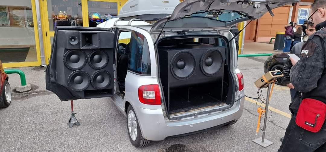

Ok i try to explain because my english Is not perfect. I want to build 2 separate box easy to install and remove from the back doors of my car, so when i use the car for everyday i can remove them and let them in my garage. And when i go at events i can put them on and obviously listen with people from behind the car. Probably ported configuration. For the low bass i have 2 pride sv3 15's on 8k rms, 5k 2ohm for the left door and another 5k for the right woofers. 4 8ohm mid-woofers Is perfect for that scenario in my opinion. I have the drivers hf108 and the horn Is STH100 from faital pro too. Now the question is only one. What is the loudest and best sounding? Later after work i take a look at the delta b 10's. Feel free to give suggestion. One last thing before i forget, 3 to 4 months from now i want to sell the subs and build a long throw cabinet with 2 b&c 18SW115. Thank you for every replay, very appreciated 😊

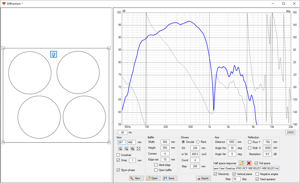

4 drivers mounted vertical and horizontal will just cancel
almost half the bandwith. Radiating into full space even worse.
4 drivers can work. the baffle would need to be splayed.
and the lower drivers filtered so they dont cancel the upper drivers
high end response.
otherwise most the power is canceling itself.
high end response.

So if mounted vertical. Then cancelling of high end
is only vertical. Depending on center to center
distance.
By mounting horizontal and vertical.
Cancelation is vertical and horizontal.
most systems are vertical alignment.
for best Horizontal. or side to side.
to keep high frequency from canceling
the drivers are usually smaller.
