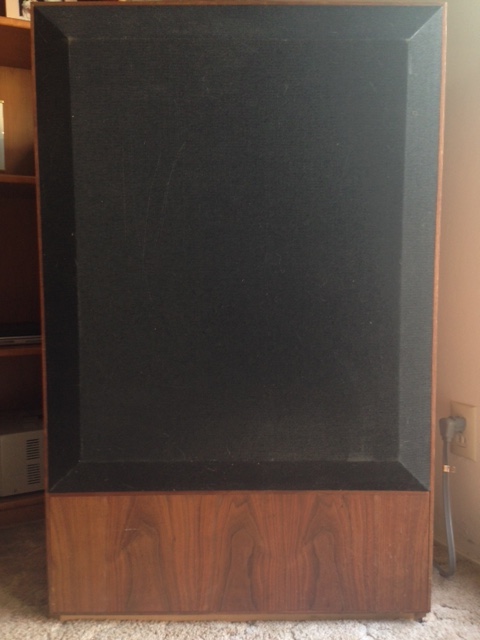

My countless hours of researching different speaker options has finally paid off! A week ago, after perusing CList, I bit the bullet and sprang for a pair of Altec 604-8G in home made cabinets that appear to be 620/Model 17 cabs.
When I first hooked them up using the stock Altec attenuator I was a little concerned I'd made a hasty decision. They were almost impossible to adequately blend the horn and woofer. Even so, they offered a level of imaging and detail I'd never before heard from my J2.
So after listening for a week, today I decided to try bi-amping using my Ashly XR 1001. I'm using my J2 on the compression drivers and an old HCA 1500A for the woofer. The results are astounding!
Next, I plan to build the Markwart crossover to see if I can resort to using just my J2 for both sections. If that doesn't match what I'm hearing now I'll end up trying to build a custom crossover to bi-amping using my VFET on the LF and J2 on the HF. It's going to be fun! 😀
The Altec 604-8G are definitely drivers worthy of Pass amps!

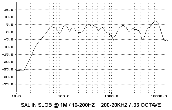

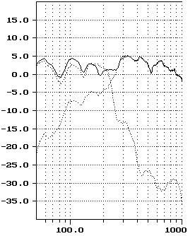

Currently they are set up as follows:
Latest SAL driver in SLOBs with Definimax 15". Drivers wired in phase.
Low pass: 80 Hz 2 pole, EQ +5 dB at 30 Hz
Hi pass: 160 Hz 2 pole, EQ shelved -4 dB at 2.5 KHz
Attached are composite response curve and acoustic crossover detail.
