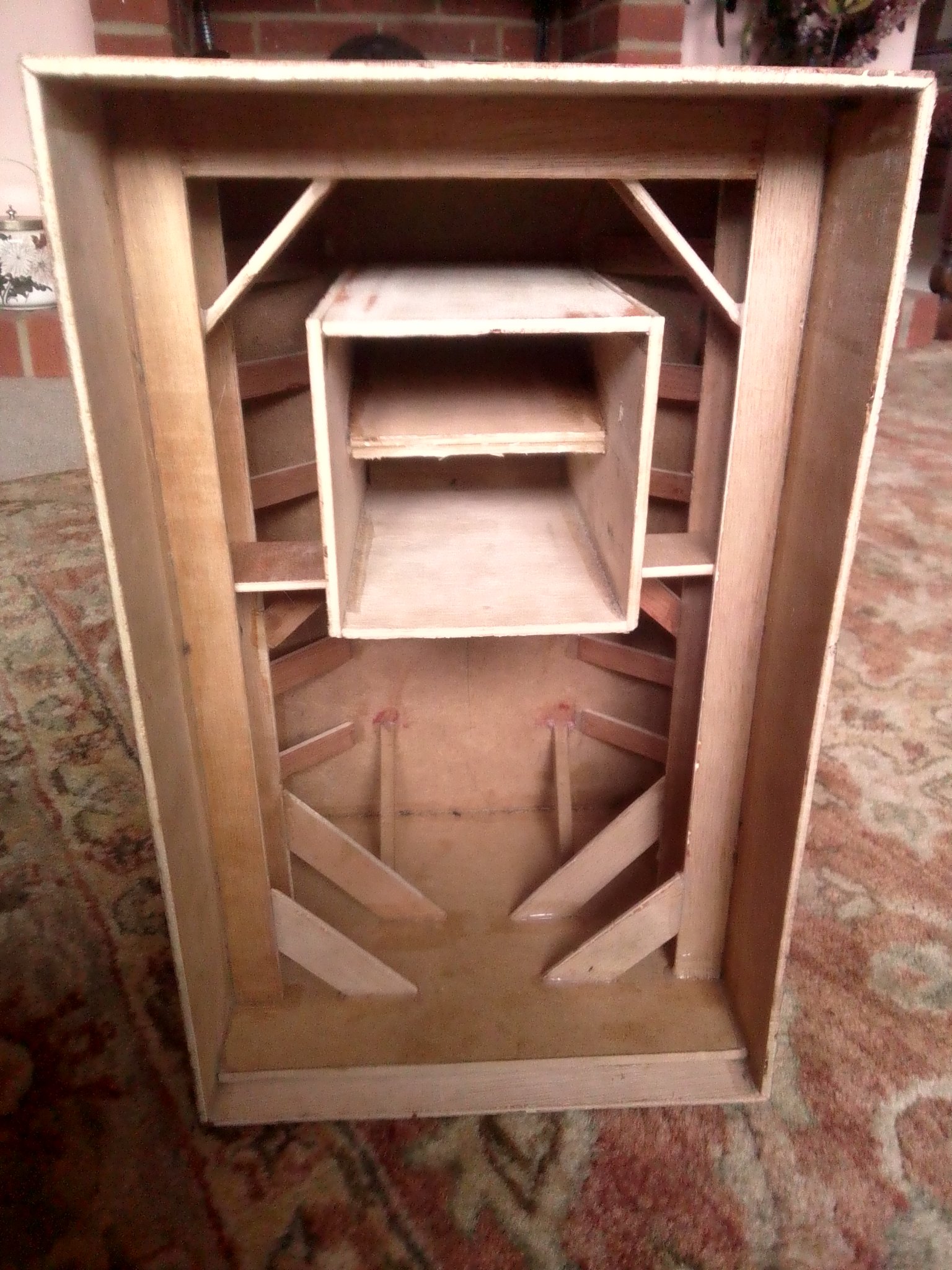

My favorite side effect of building around low level listening is that you need little to no internal bracing as the cabinets don't get energized, which allows keeping the cabinet resonances low where they're less distracting. It does sound bad when turned up 😬
I figured that the low mechanical resistance was helping this, and I've been suspicious if the strong (heavy) magnets are helping, and therefore thinking about trying field coil speakers.
That's curious, as cabinet exitation is linearly related to sound level. In other words, turning down the level to reduce sound level from the cone reduces the box exitations with the same factor. The relative difference stays as it is at higher level.My favorite side effect of building around low level listening is that you need little to no internal bracing as the cabinets don't get energized, which allows keeping the cabinet resonances low where they're less distracting. It does sound bad when turned up 😬

These are my latest speakers; sound great at low levels, and a LOT of internal bracing, about 50 bits of wood in each cabinet, but then it takes a lot of bracing to make 3.6 mm walls stiff.[/ATTACH]
I can think of some non-linear effects, though, like baking trays with internal stress causing them to 'pop' from one stable state to another. So a gong-like rattling effect could also be at play.That's curious, as cabinet exitation is linearly related to sound level. In other words, turning down the level to reduce sound level from the cone reduces the box exitations with the same factor. The relative difference stays as it is at higher level.
