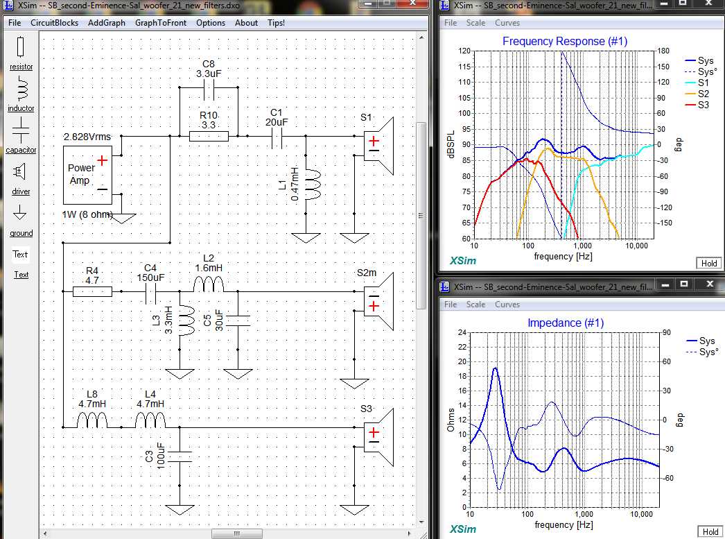

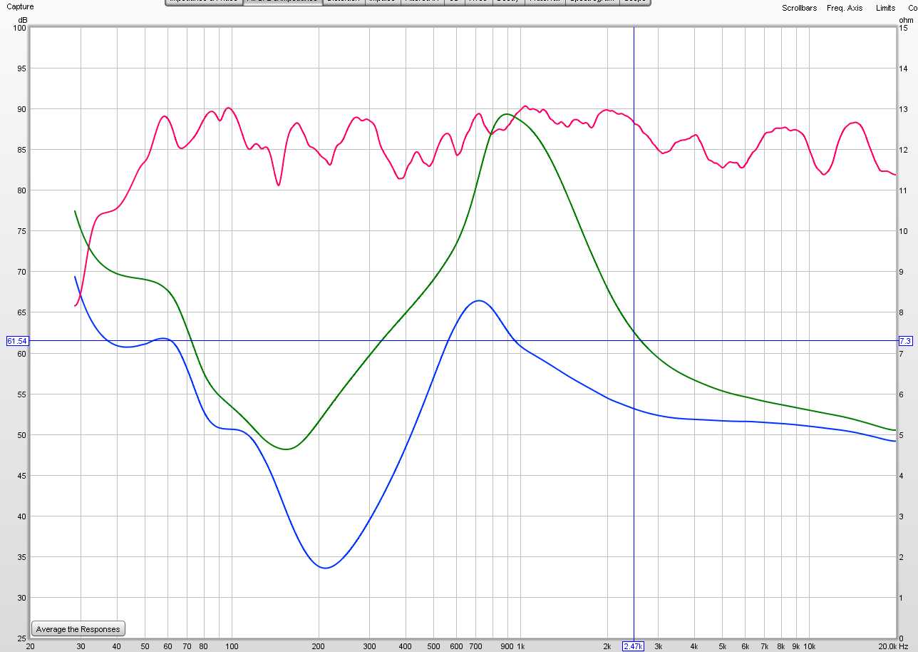

Ok, I made some measurements with the full speaker.
It sound ok but I whant more. I will continue to test diferent filters configutrations.
With violet is the output,
with green is the impedance and
with blue is the impedance with the resistor R4=10ohm and placed after L3 coil. The amplifier was'n happy with this configuration.
