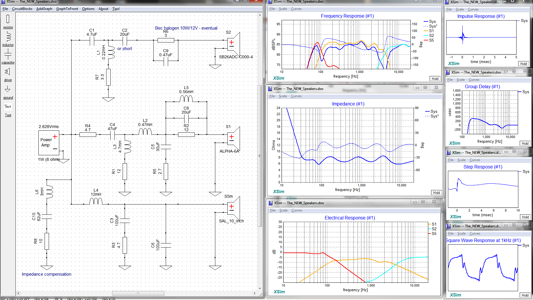

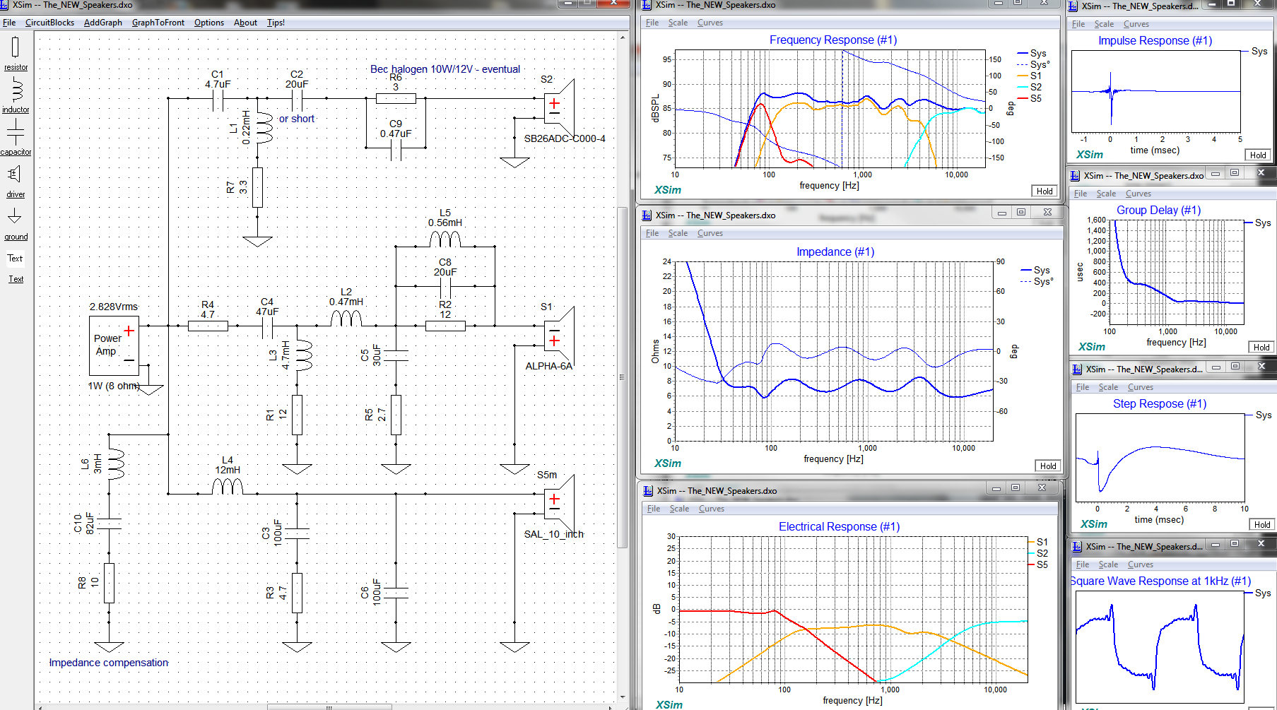

Using the FRD and ZMA files extracted from datasheets and measurement of my woofer, I sketched a filter.
What do you think?
First with mid in correct position (reversed) and second with mid in direct connection to see the cross frequencies
I initiate the order for EMINENCE ALPHA-6A and SB ACOUSTICS SB26ADC-C000-4.
What do you think?
