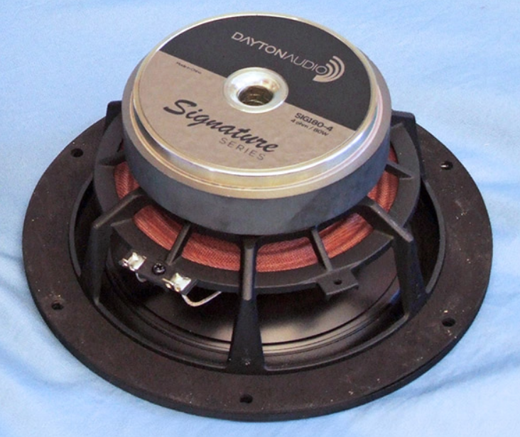

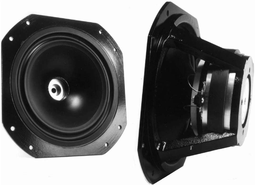

i think that this is a very important and often overlooked topic The basket design Expecially the outer ring where the bolts are usedTo bolt the woofer to thesteel frame one would have to cleverly design the basket.
Imho that ring should be big to allow for a better match with the front baffle
this is a good example of what i mean a large front ring on the basket with an increased contact area between driver and baffle
instead is usually very narrow I do not understand why

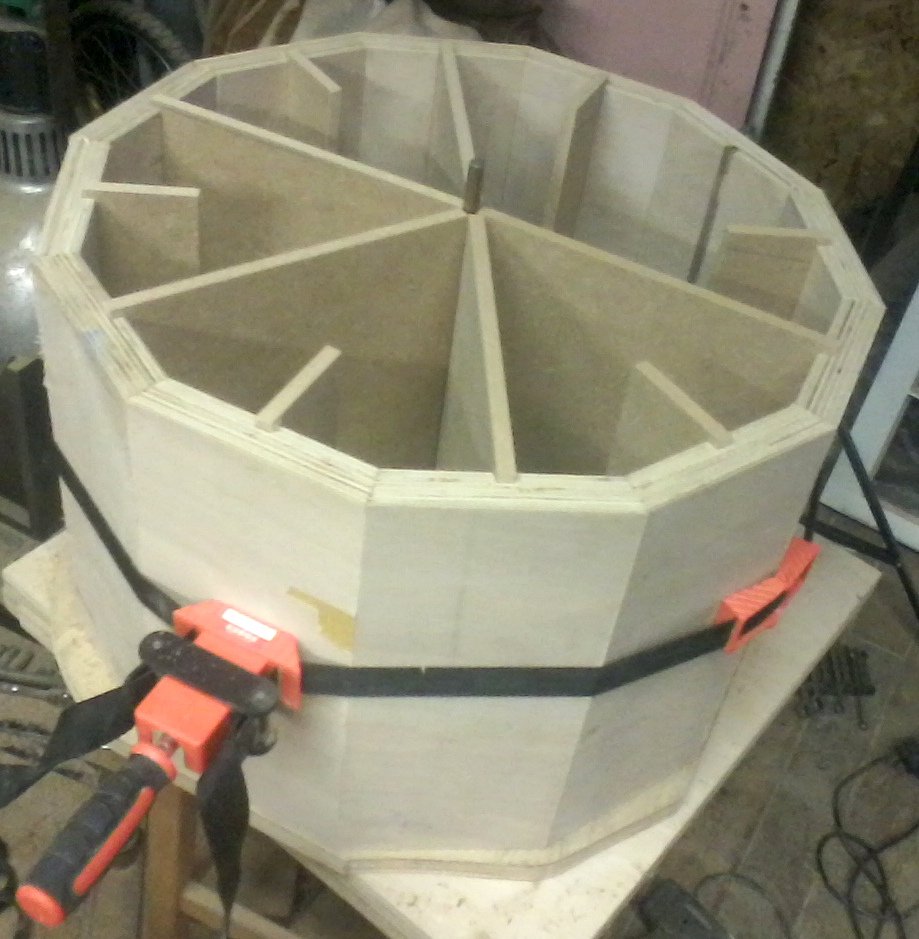

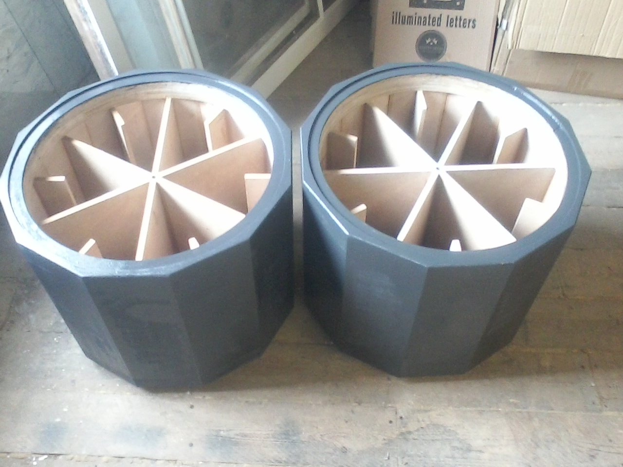

Hi i agree without problem It is the construction that becomes challengingWith a little thought it should be perfectly obvious why cuboid boxes need so much complex bracing to reduce panel flexing so they work acceptably well - they are the wrong shape to start with!
tell me how many subs are not cuboid There must be at least one good reason to use a cuboid cabinet
probably because it is simpler easierTo my mind it is rather like building a bicycle with a rubber frame and then having to add all sorts of stiffening elements to make it rideable. Why does everyone seem to take this route when building DIY speakers?
i agree again But i believe that a well designed and built bracing can eliminate most of the problemI can understand that slightly more complex woodwork is beyond the capability of some, but it saddens me that there is so much Monkey-See-Monkey-Do in many different hobbies, when there is an almost limitless quantity of inspiration and ideas to be found on the interweb using just a tiny bit of lateral thinking - thinking outside the box, pardon the pun...

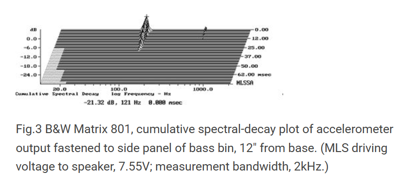

in my mind something like the bass bin of the old B$W 801 S2 could be taken as a reference
https://www.stereophile.com/content/bw-matrix-801-series-2-loudspeaker-measurements
Simplicity. That's about it - they even use more material than a cleverly designed enclosure...There must be at least one good reason to use a cuboid cabine
My basic rules are; Subs - rigidity, Mids - well-damped. The BBC papers on enclosure construction are still relevant today.
The outer bezel is but one part. Ideally we would be able to bolt the other end of the driver to the box as weell.
We don’t get to design our own baskets, but in this case a (couple?) hundred of these were made:
The basket envelopes the magnet assembly, so that the magnet is not puloled off when a bolt reaches thru the pole-piece and bolts to the cabinet. nSame could also be used to create a push-push assembly.

If i have learned one thing is that the requirements for low and mid high differ This is why i would like to keep things separated
this will also allow to try different solution for bodies and heads more easily
Who said that a speaker must be a monolith ?
Hi thank you for the very interesting information i was only noticing that the basket edge is usually very narrow also for big unitsThe outer bezel is but one part. Ideally we would be able to bolt the other end of the driver to the box as weell.
A wider edge could provide a better contact of the basket with the front baffle
I understand that this arrangement provides significant advantages for vibrations managementnSame could also be used to create a push-push assembly.
