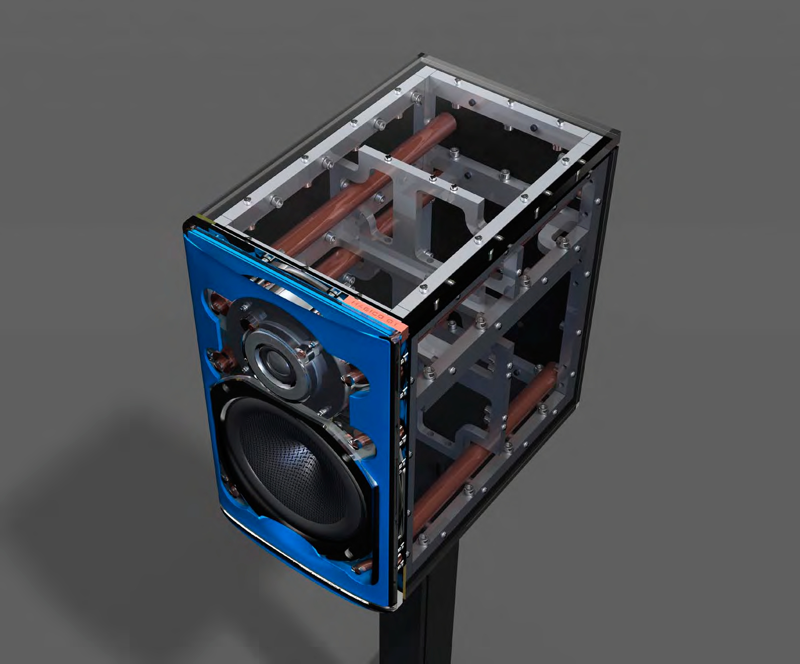

For a bass box i remain on my idea A steel cage very rigid structure that can be loaded with additional weights bolted to the structure in some ways
Bass box must be very very heavy Like 50 kg
The side top and back panels can be made of different material like mdf even not very thick and kept attached with magnets to the metal frame above mentioned
This would make the access to the internals very easy
Only the front baffle should be very rigid and bolted to the metal frame

actually the cage should be internal acting like a frame on which the various panels are attached in some wayA cage is around the outside, the longest path; you want the shortest path to make something rigid.
i have seen this design and i am very impressed
the woofer must be bolted to the frame i guess

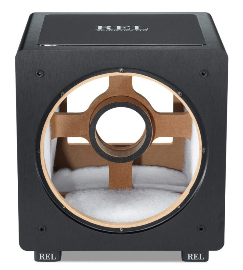

however i have also seen the inside of a Rel sub It has a thick cross acting as bracing in the middle I guess they use mdf so not the best
i wonder if the cross can be made out of metal for extreme stiffness
it is an entry level sub
another solution for bracing Much more complex

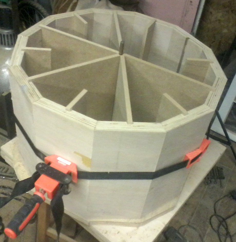

With a little thought it should be perfectly obvious why cuboid boxes need so much complex bracing to reduce panel flexing so they work acceptably well - they are the wrong shape to start with!
To my mind it is rather like building a bicycle with a rubber frame and then having to add all sorts of stiffening elements to make it rideable. Why does everyone seem to take this route when building DIY speakers?
I can understand that slightly more complex woodwork is beyond the capability of some, but it saddens me that there is so much Monkey-See-Monkey-Do in many different hobbies, when there is an almost limitless quantity of inspiration and ideas to be found on the interweb using just a tiny bit of lateral thinking - thinking outside the box, pardon the pun...
Not really, if they are designed cleverly. My enclosures have no front baffle and I pump a kilowatt plus into each of my six 18" sealed PA subs. The enclosures empty weigh about 9kg, with a first major resonance around 500Hz.
Now i want pictures and more details please!
