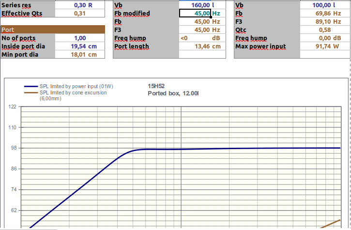

Beyma 15XA38Nd Bass Reflex project
Hello guys!
After reading a lot of very interesting information on this driver, I pulled the trigger and bought a pair.
Thanks for the very useul information. I'm not exactly new to this, but not very active on forums. I've build myself some projects, including one transmission line which I enjoyed for 10 years, but it's time for an upgrade.
I considered a few options, but it seems this driver is a really good fit for a traditional relatively big bass reflex. Maybe an MLTL could be an option (Caveman), but I don't have the knowledge or the correct tools to simulate it. Do you see any real advantages for this specific driver, when comparing to a traditional bass reflex?
160L seems to be my sweet spot in terms of size and flat response.
Aligning the enclosure @45Hz, I'm getting F3=45Hz, F6=40Hz (maybe room gain is my friend here? I could not find anything conclusive on room gain...).
Being myself a bit of a bass head, i'm worried about the low end. Maybe it will extend a bit when the enclosure is properly stuffed.
I'm using the spreadsheet recommended by Troels Gravesen in his site.
Port Calculation
Recommendation is to reduce the length of the port by a factor of 0.7, but this is an approximation, as "virtual volume" can change once you add internal stuffing. So maybe I'm able to tune it lower than my simulation, but then there's another question:
Beyma states in the speaker spec sheet that parameters are measured after "some time in operation", which means I need to play for some time before fine adjusting the port length. Any idea on how long (should I run them for the traditional 100 hours before making adjustments?)

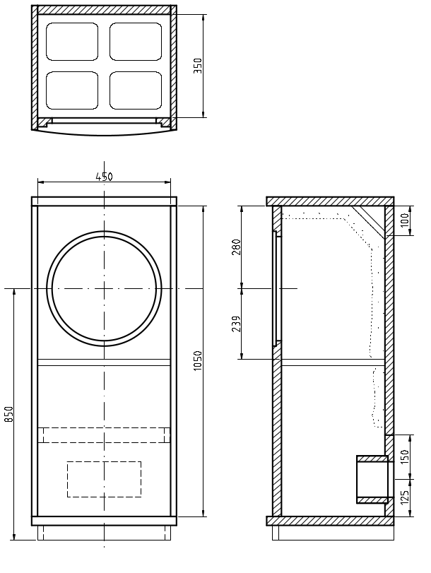

Enjoy the sketch of the box attached. Any comments are welcome!!
Cheers!

Some additional information
Some additional information on the project:
Materials
- Wood: Birch Plywood (if I manage to find it here... 😀)
- Wall Thickness:
30mm Front baffle and back
20mm lateral and bracing (theres a piece inbetween the woofer and port which did not appear in the cut lateral view, I don't know why)
- Stuffing:
50mm thicknes PET acoustic treatment plate (around 30kg/m3) behind the speakers
- Automotive felt lining for lateral walls and other surfaces, except for port, and maybe front baffle - this is easy to glue to surfaces and it's designed to reduce vibrations in cars, I've heard good comments about it.

Assembly
- 2 pairs of high capacity castors behind the bottom skirt, two fixed in the front, two with brakes in the back. This will make it easy to move the monsters around for cleaning and near field listening. I'll add 3 feet (one in the front, two in the back) in a way they remain hidden when moving, and will allow for a fixed installation when I find the right position)
- The only part which will be removable will be the upper back panel, in order to give me internal access to make adjustments after installation
- Some sort of adjustment method to the port in the back: I decided for back firing port for two reasons:
a. It reduces interferences from any mid-range material that could come out if it was positioned in the front
b. My room has thick absorbing material behind the speakers, which will reduce interaction with the room

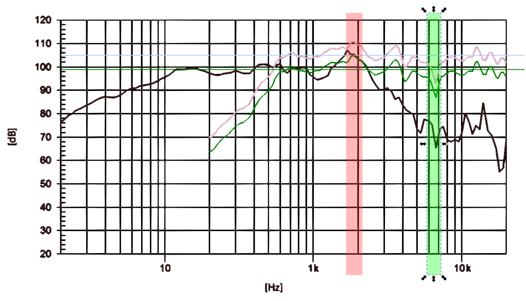

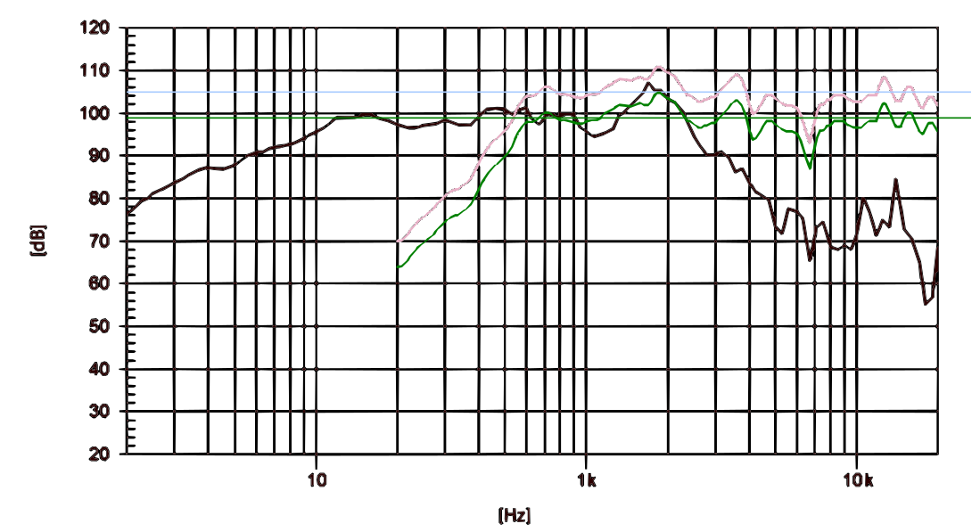

The "Balanced" position is the necessary attenuation to get both drivers having the same average SPL output.
According to the manufacturer, that would be -6dB (tweeter is 105dB/W/m and woofer is 99dB/W/m).
I took both drivers response and moved the tweeter response 6dB down, to see how overall response would theoretically be, considering specs are accurate and average is sensible.
Legend
- Red is the tweeter response with no attenuation
- Green is 6dB attenuation
- Horizontal blue is tweeter average sensitivity with no attenuation
- Horizontal green is tweeter average sensitivity attenuated
Looks good.
Two points I'm concerned about:
1. 5dB peak @ ~1.7-2.1KHz (marked with a red window in the second image, the tweeter response almost touches the blue line, @105dB)
2. A big dip @ ~6.8KHz
According to what I have read, our ears are supposed to be less sensitive to dips, so I guess #2 is not a major concern.
Anyway, it is iteresting that this dip happens in both drivers; possibly an effect of the coax configuration?
If we look at the speaker spec sheet, that peak is there, but not so acceantuated, and there are some additional peaks in HF which do not appear on the reponse graph of the individual drivers. Maybe that explains their choice for 1.8KHz crossover point and the raising frequency characteristic of their crossover, noted somewhere else by another forum member.
Is the tweeter response expected to be the same with or without the crossover?
Is there any way to include a "contour" filter to the tweeter @1.8KHz? Maybe it's just easier to place crossover frequency at this point, selecting a filter that could result in that intented attenuation.

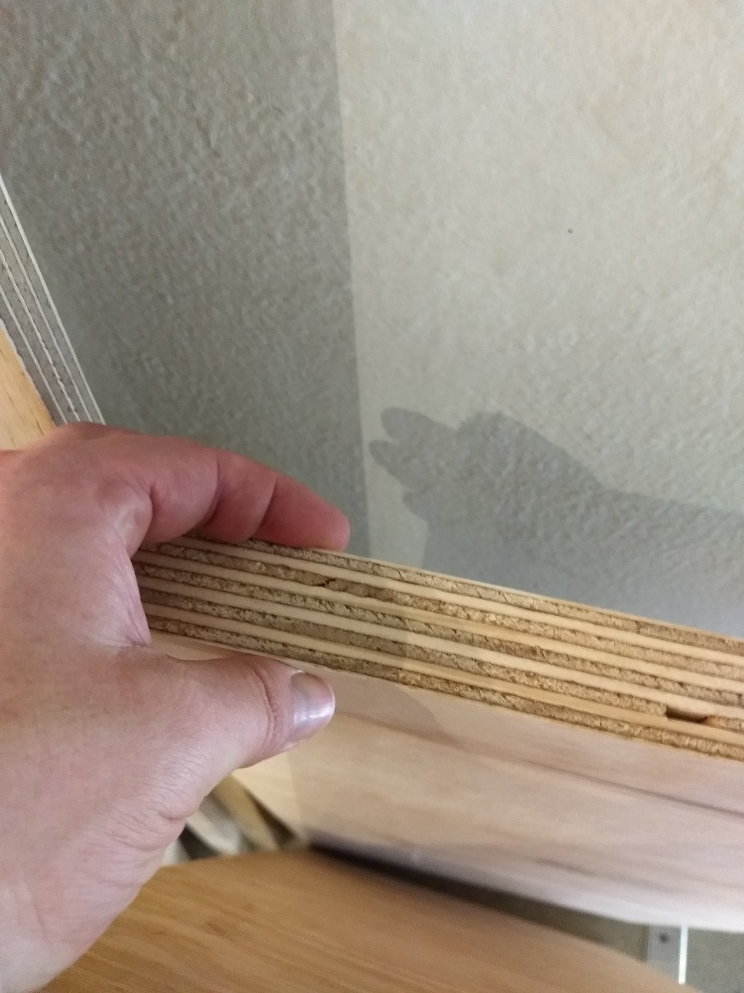

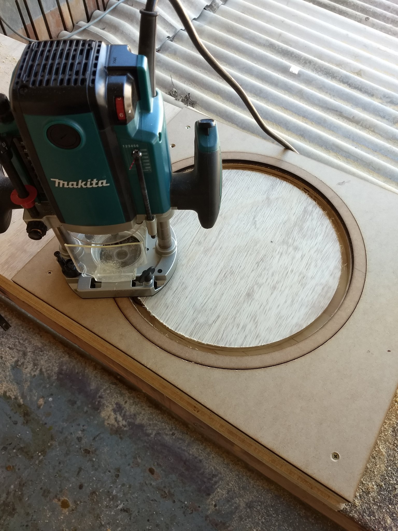

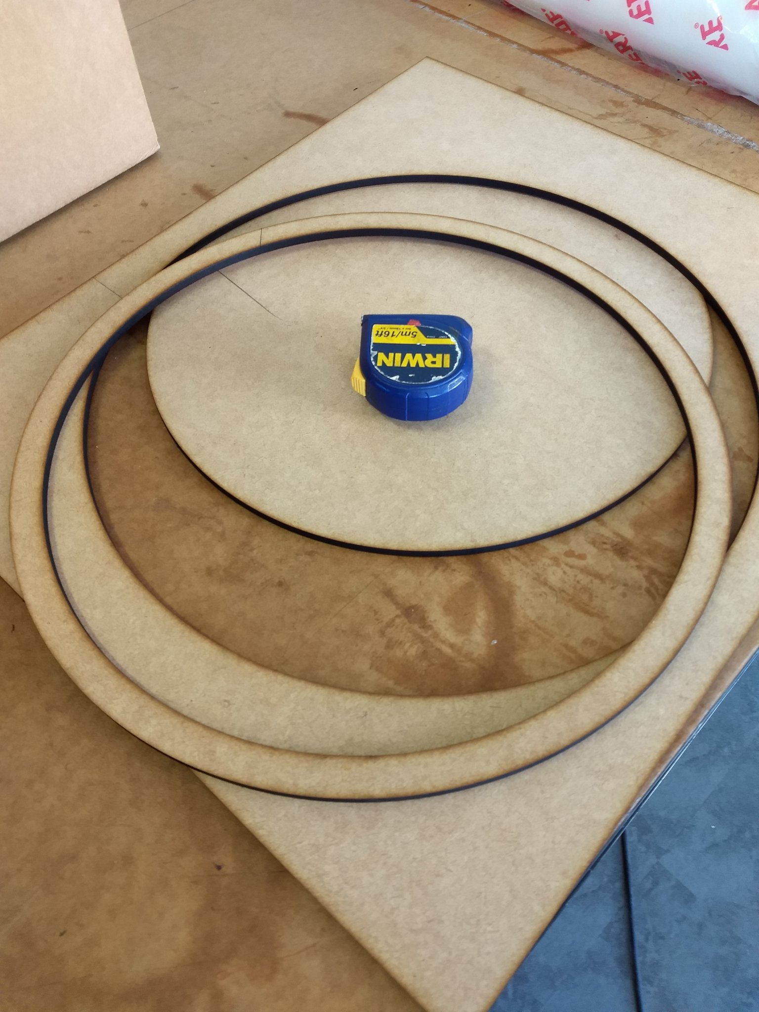

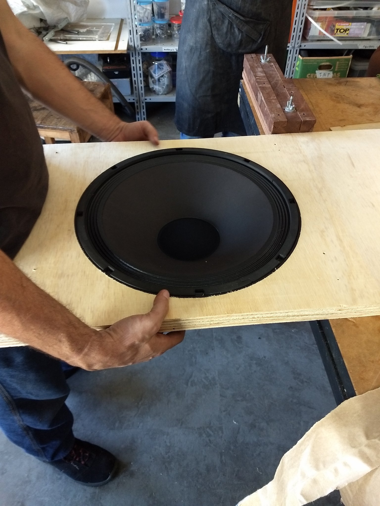

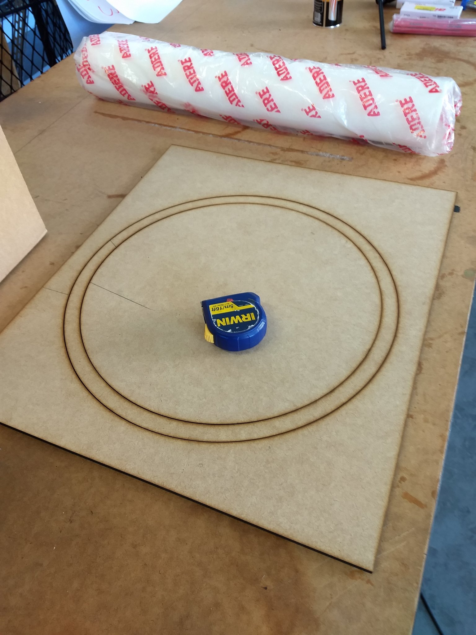

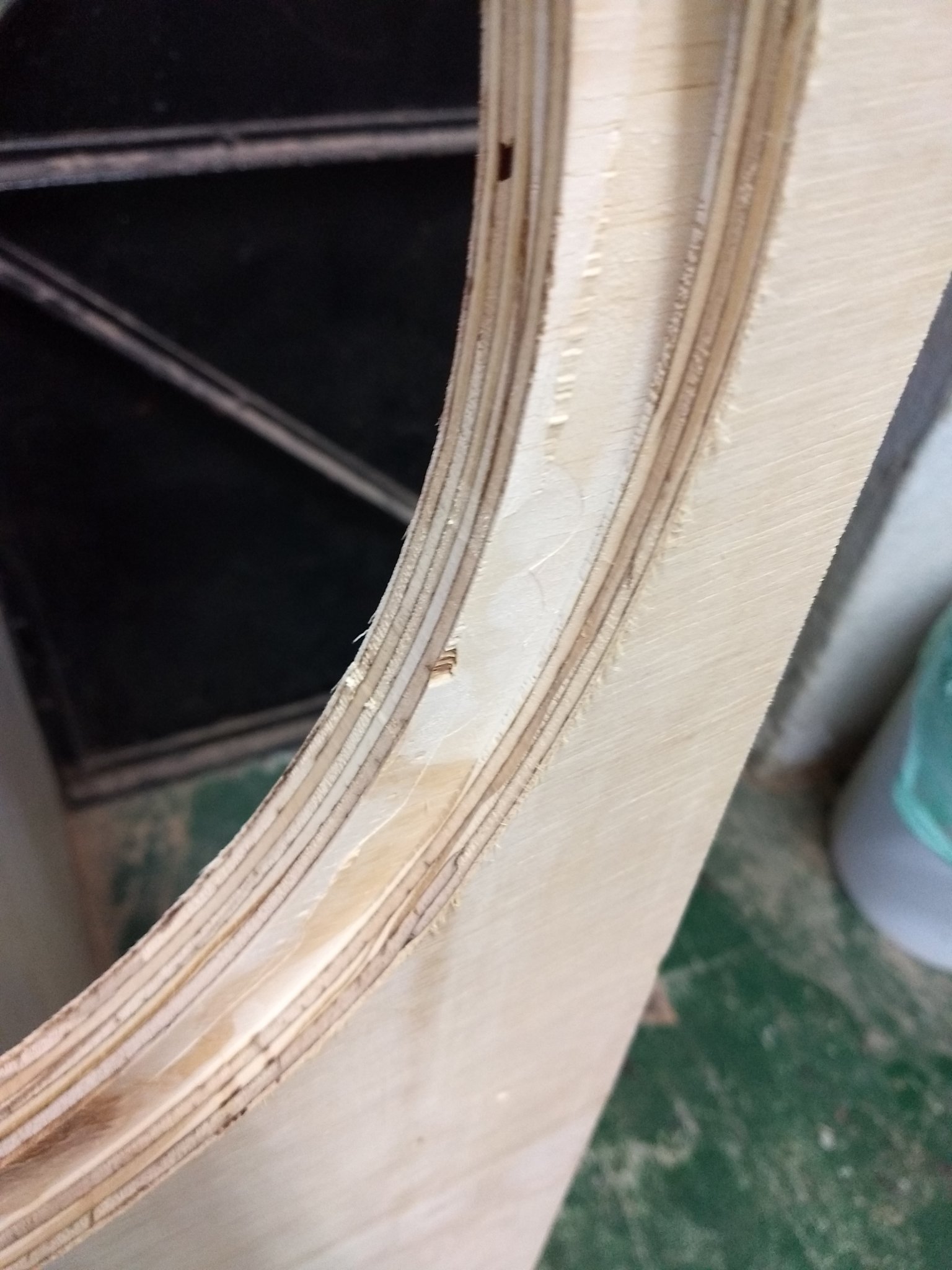

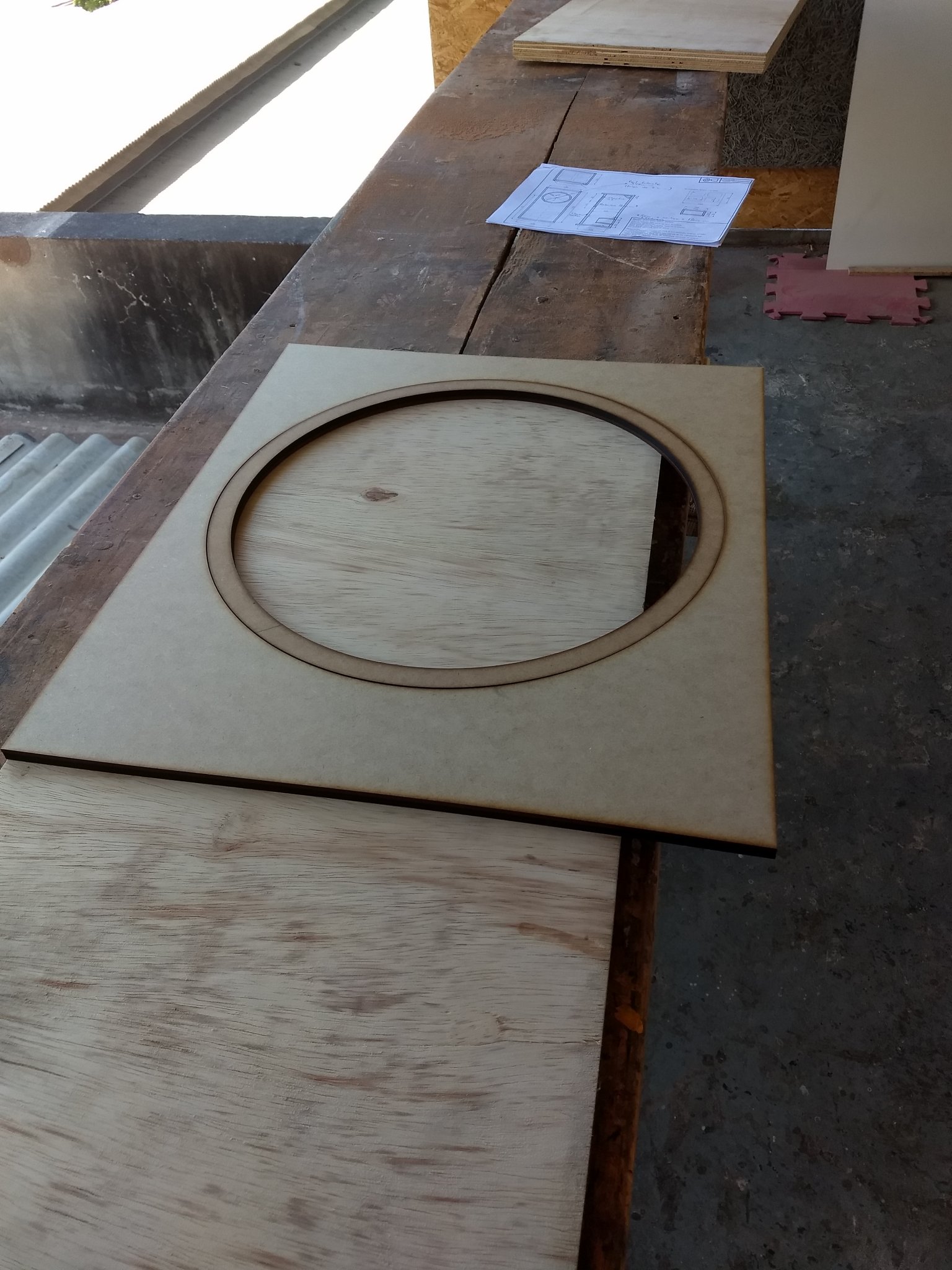

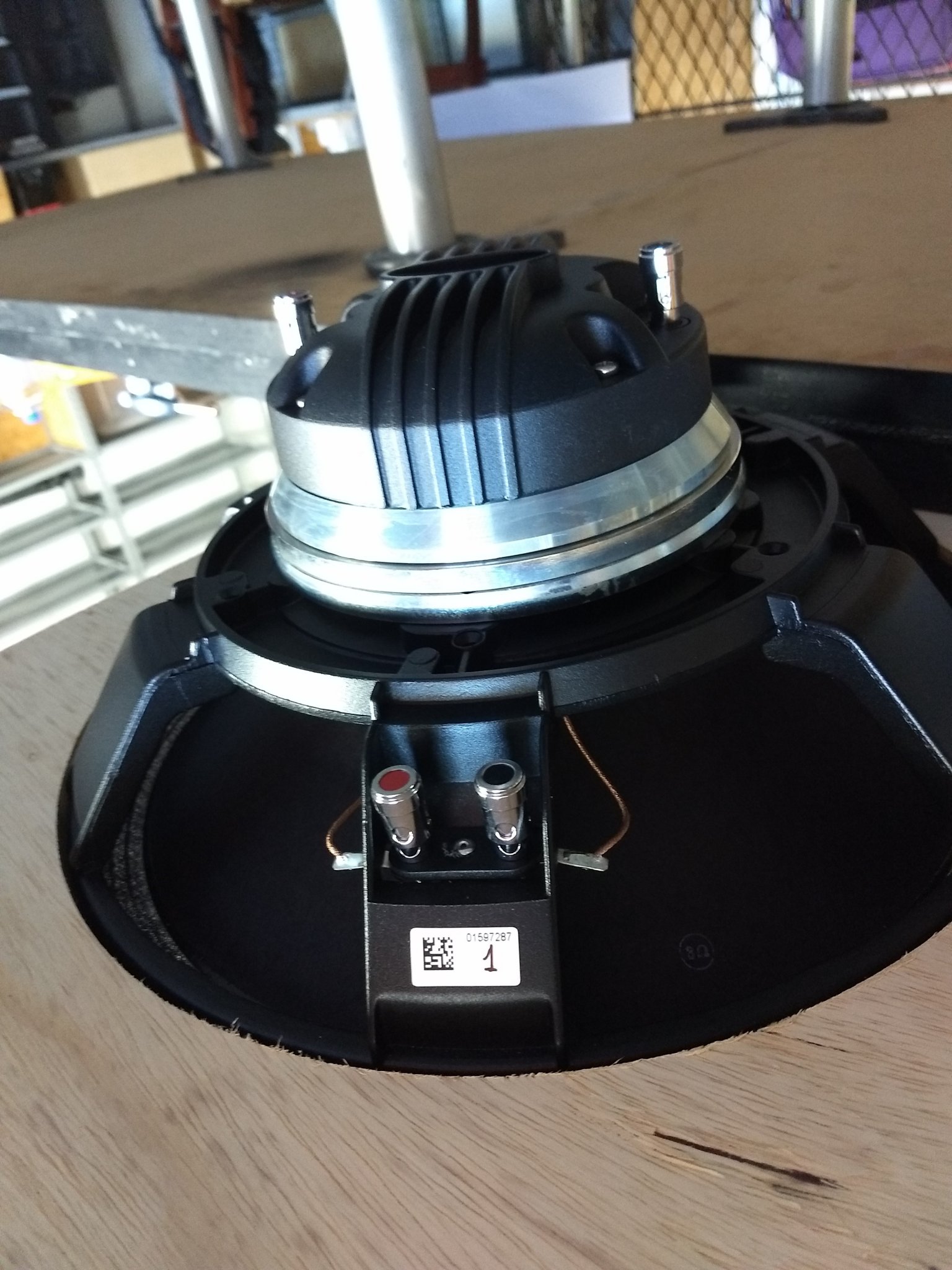

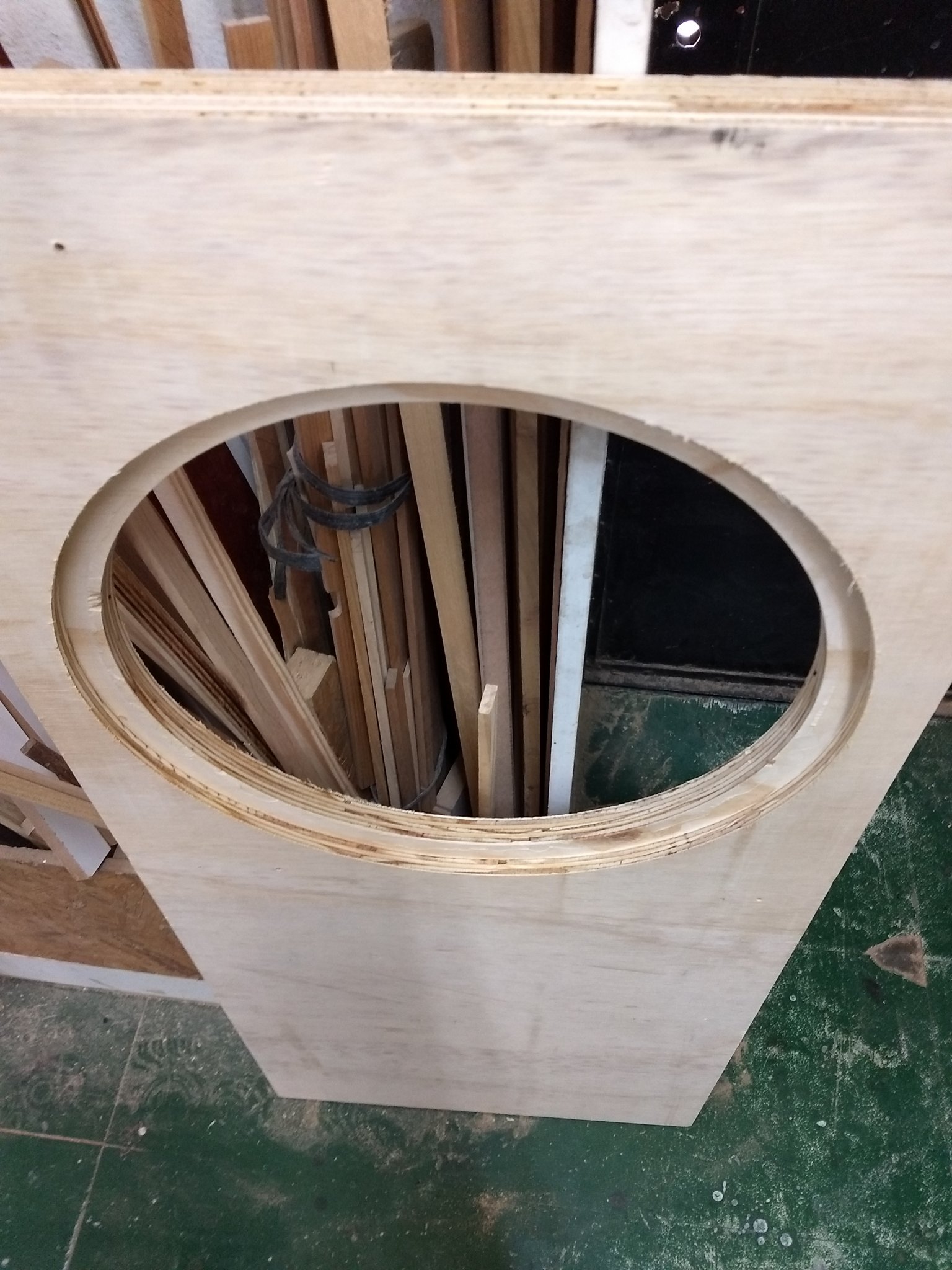

Hello, everybody!
I had a hectic last quarter this year, so finally got back to the project only late november.
I'll post a few pictures of the process and share some lessons learned on the way.
This first post shows materials and preparation of the front baffle.

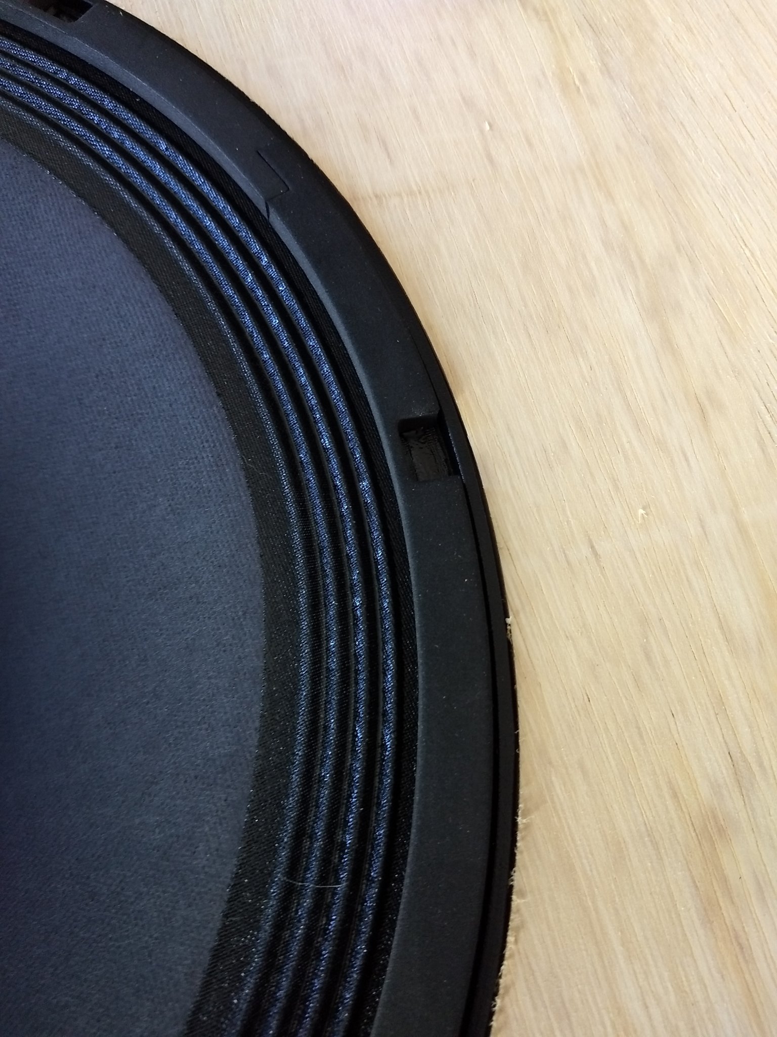

First time with the jigsaw. Simply amazing tool - I never had holes cut so precisely.
Speakers fit perfectly and tightly. I made a mistake by having one pass more than necessary, because I made a change to the original project.
To deal with diffraction (centered around 500Hz according to simmulations), I decided to add a layer of cork, 5mm thick.
So I had to add a 3mm MDF ring later to elevate the speaker just enough to make it flush to the cork (still not installed).
