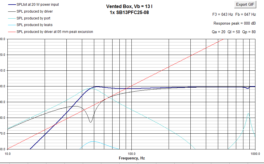

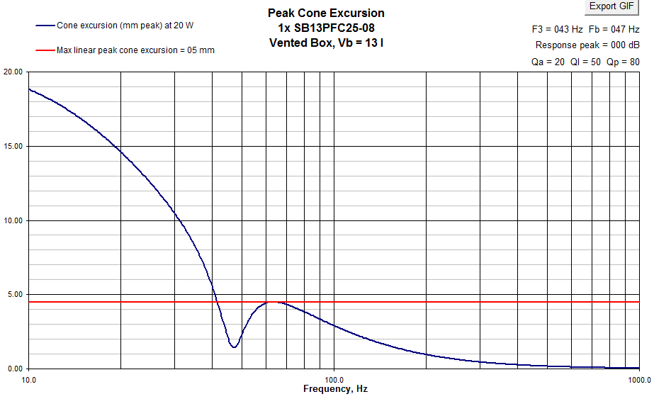

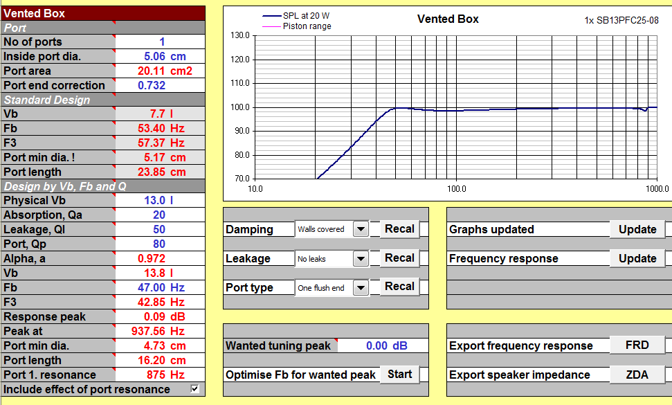

the SB13PFC wants a vented box. About 13-14 liters should work well.
For the PFC did you use vented or closed box?
Sagi
Vented. Its T/S makes it better suitable for a vented box unless you use two per side. Even in something like 3l sealed it would reach its excursion limit with modest to loud listening levels. If supported by another woofer it can do, but alone won`t shake you at all.
If you put it in a large box of 14-15l you`d reach its excursion limit easily. I`d shoot for something like 8-9l with port tunned to 56-60Hz (a 47mm diameter port 100-105mm long should do).
