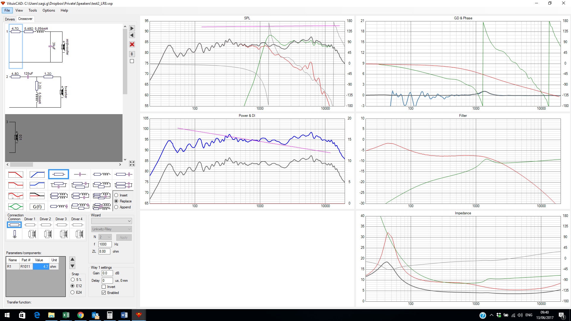

I finished receiving the parts - SP13PFC25-08 and ND25FN-4. Here is the simulation and the XO parts: http://imgur.com/a/I9HkG
WinISD recommended 6L box with port. I used birch wood 18mm for this. The dimensions were 220x330x146mm. It seems that this box is relatively small and should be increased in the future.

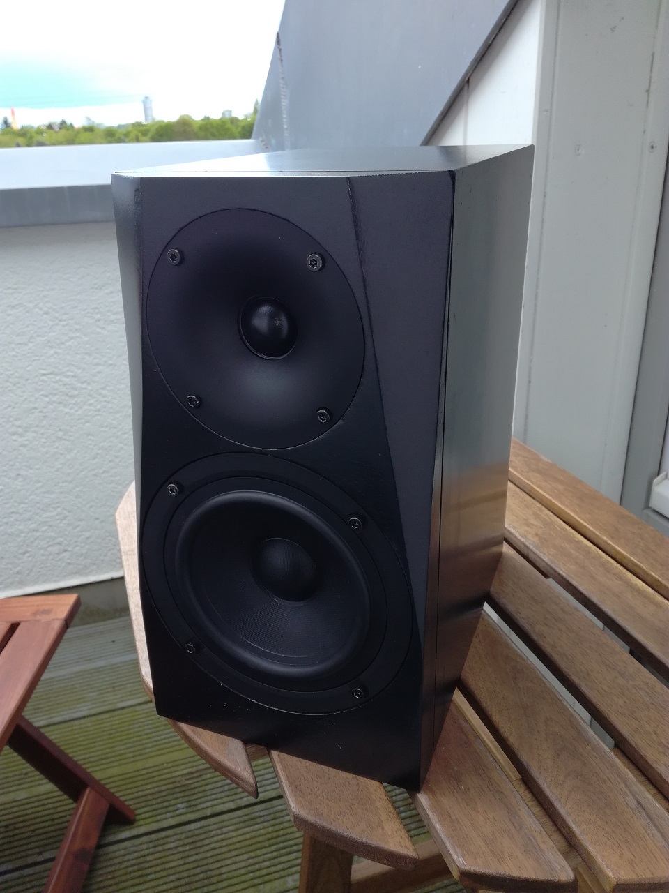

Results - First I've connected the drivers without the box on the table. Everything seems to work fine therefore I decided to put it in the box and see how it effects the bass. Recessing for the SB was done terribly and as it was my first time doing that, I will probably do it again in a better cosmetic way. The tweeters don't come with screw holders so I had to cut the exact dimensions in the wood so the tweeter will be inserted and hold by small press. The port that I purchased was 18cm long and I had to cut it to 16cm so it can be inserted to the box. There is a distance of ~3cm between the back panel and the end of the port.
Sounding - It seems that the sound is too flat and the tweeter should be tuned a little forward. Other than that, no special comments on the tweeter. The mid looks like it doesn't work smoothly. I don't know how to explain the behavior but maybe if you read the details and see the pictures you can get some insights on what is the problem. I will try to hear more music using the speakers and re-phrase what is the problem.
Here is a picture of the final box. The port and the connectors are not fixed therefore it is a bit twisted
http://imgur.com/a/gDZh1
Any recommendation of to continue from here will be welcomed.
