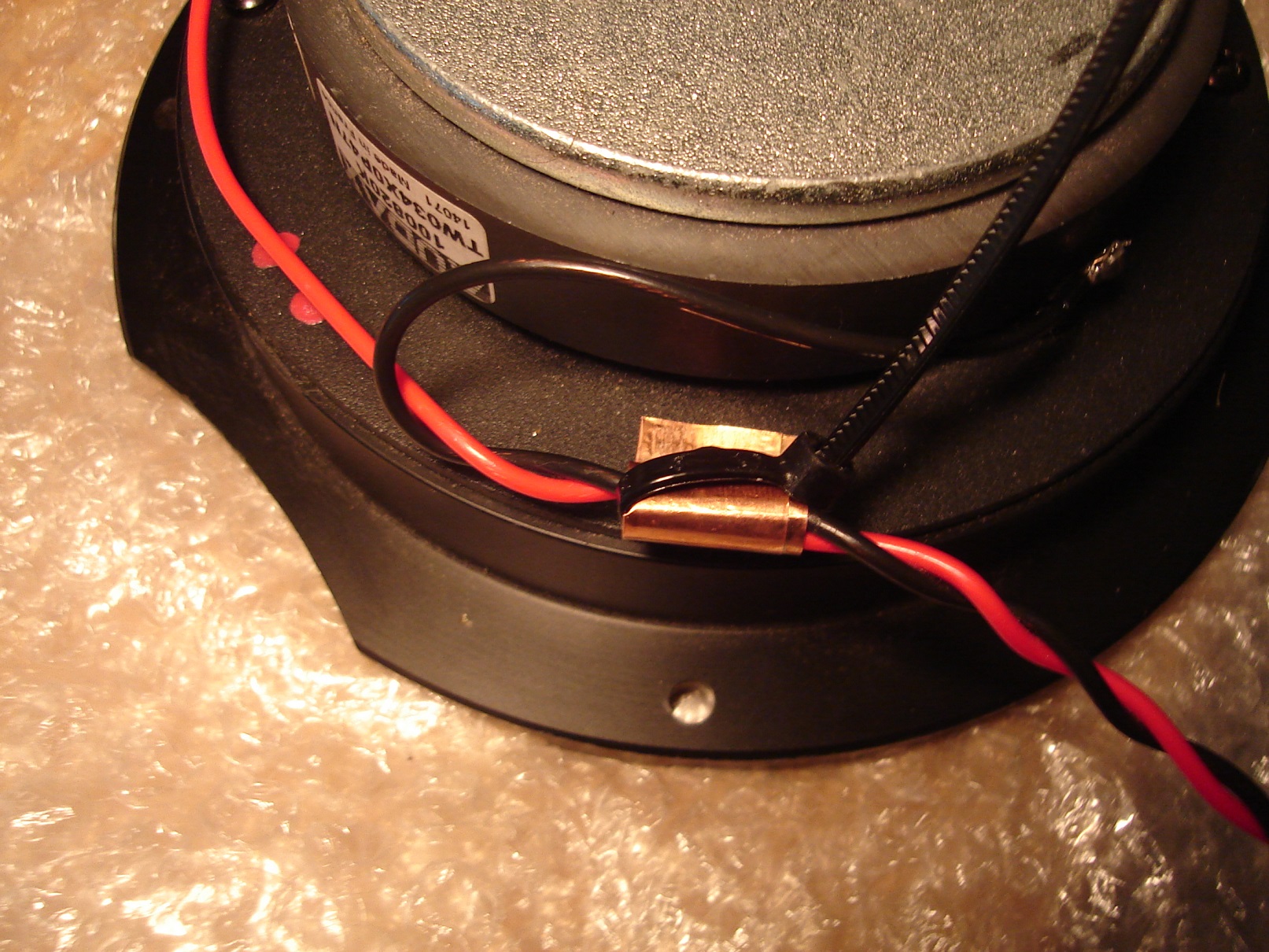

The length of 'skinny' connecting wire inside a speaker cabinet is so short that it introduces an insignificant amount of resistance to the flow of current.
It is in the longer run between the amplifier and the speaker where the benefits of using a thicker wire to reduce resistance are obtained.

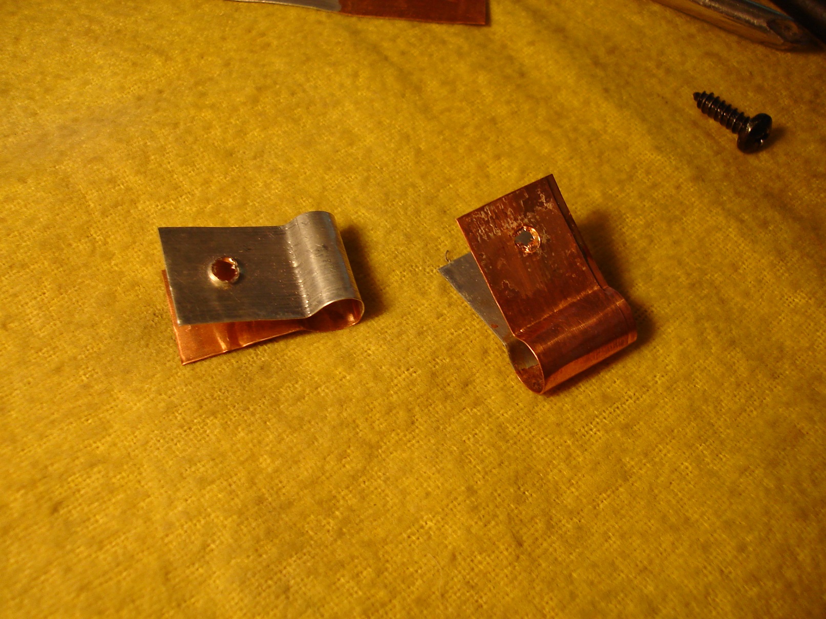

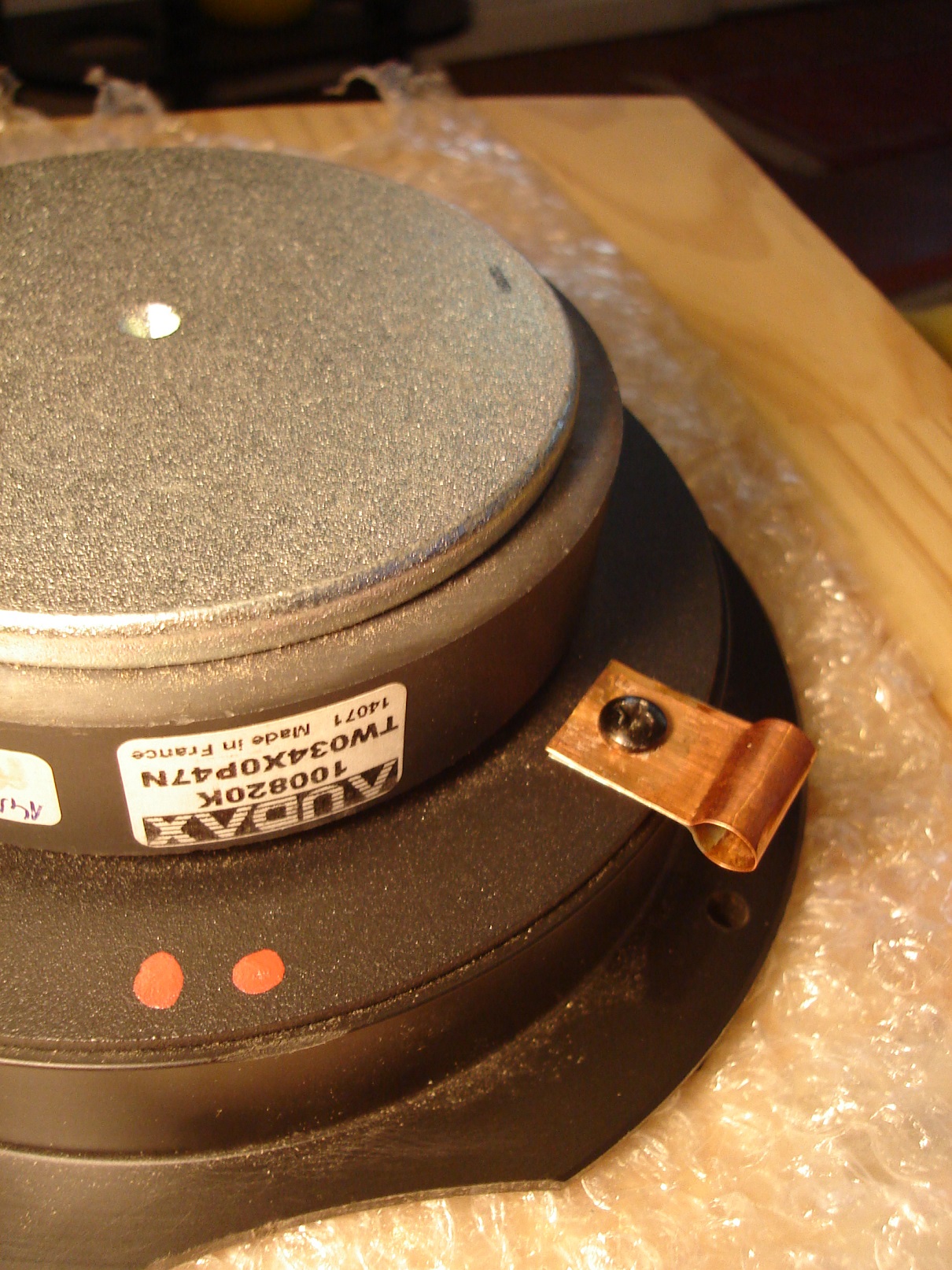

Using too thick a wire internally can cause problems in crimping or soldering the thick wire to the driver terminals as well as putting undue stress on the terminals due to the weight of the cable.
That is a real problem.
And there are cables that are extremely hard, so you have to secure them in some way so they do not break the terminal.
I found this way.
