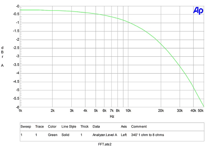

Of course cable has an effect. The only question is how much for a given situation. Attached is a frequency response plot of 100 M of lower than normal inductance loudspeaker cable driving an 8 ohm resistor.
So not surprisingly particular details matter. Now most folks here will never run 100 M of cable. But changes at 20,000 hertz start to be measured at 10 M of cable.
As to RF pickup, this starts to be a big issue with cables approaching 50 M.

All that is good information, and I'm assuming you're speaking of Meters of wire (M).
I don't know of anyone wanting to use 300 feet of wire to connect speakers of course, so it's a moot point.
In the average living/entertainment room of a residence I'd imagine wire lengths of maybe 20 feet or so - nothing to fuss over with 16 gauge zip cord wire.
