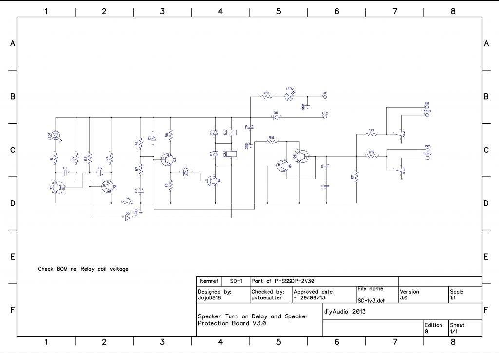

Hello here 🙂
Some time ago, i made myself this DC-protector board.
I did raise C3 from 47uF to 100uF for delaytime of approx. 8-10 sec.
It is stuffed with relay's for 24vdc PSU. (2x12vdc omron's as per BOM)
Nothing else changed, created from scratch from attached schm.
Well, right now i am coocking on a Aleph J - mini, with psu rail's at 19,2vdc, and i attached the protection board to the Aleps PSU.
Eventhrough the rails are lower, everything seems to work. I meassured at the relay's coil and the relay's engage around 7vdc; when they are engaged the voltage across them is around 9,5vdc (~Half my 19vdc psu i think)
So far so good 🙂
Last evening i tried to power it up, with everything connected (source, AlephJ and DC-protection boards).
As can be seen and heard on the youtube video the board engages the relays after ~8 sec. and speakers are then connected (You can hear the click from relay here on video)
At first in video, the sound which can be heard is my switch for 230vac mains switch, so just ignore this sound.
When i cut the mains, you can hear relay and a little "nasty" sound on speakers?
Anyone know, why this happens?
For years i have used a Velleman K4700 protection board, and this board does not give this "nasty" click in speakers?
Thanks in advance.

hi,
you should use a AC loss detection functionality for nasty sounds after switch off. this is available in UPC1237. my opinion only!
reg
Prasi

Power for speaker protector
Hey everybody. I realize my question has probably been answered somewhere else but I can't seem to find the answer I need. I just finished my F5 amp and I want to add the v3 speaker protect board. I have 2 12v relays and an Antek 10VA 24V transformer. I was wondering though if I could just use one of the V+ connections from the F5's psu which outputs 24-25vdc? I've had some transformer hum problems with my F5 and would like to avoid adding another transformer, even a small one. Is there a reason using the DC from psu would be a bad idea? Would it have an effect on the F5 boards, biases etc. I'm assuming that if I went that route I would connect PSU V+ to the speaker protect pcb's V+ and the speaker protect G to the PSU ground, correct? Also, do I just omit D3,D4,D5and D6? Or do I need to jumper those? Anything else I would need to omit or jumper? If you guys think it's better to use a separate transformer where should I tap into the mains AC, on the terminal block where my F5 transformer connects to mains AC through CL 60 thermistors or should I tap in directly at the power entry module? Also, my transformer has 2 outputs with blue and green wires. Would I just use one of those outputs, one blue and one green, and just seal off the other two wires? Thanks for any advice.
hi, see my post no. 236 for 5v subs. the link for 12v http://www.mouser.in/ProductDetail/...GAEpiMZZMtSzCF3XBhmW97xBhRVUmus6Z%2bft4FTgu8=Hello All,
As of 4:45 est neither of the relays in the BOM are available. The 12v ones are indeed listed as obsolete, and now the 5v ones are no longer available and slated for obsolescence. Has anyone found comparable 12 or 5 volt relays that will fit the PCB?
Thanks!
just check the footprint size on pcb (length for panasonic is 22mm and for omron is 19.8mm). if this dimension fits on pcb, you are good to go.
reg
Prasi
hi dbis,
d3 d4 are for relay back emf. there is no harm in keeping all diodes.
my suggestion would be to first try with amp psu +24v/25v supply and use 12v relays. check to see delay is proper and there is no shutdown noise.
