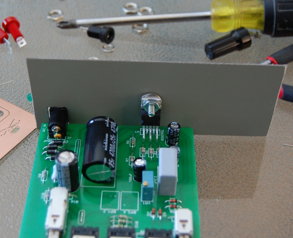

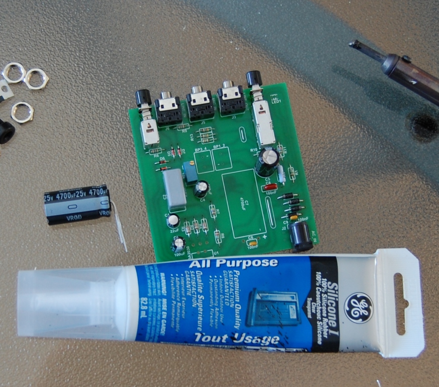

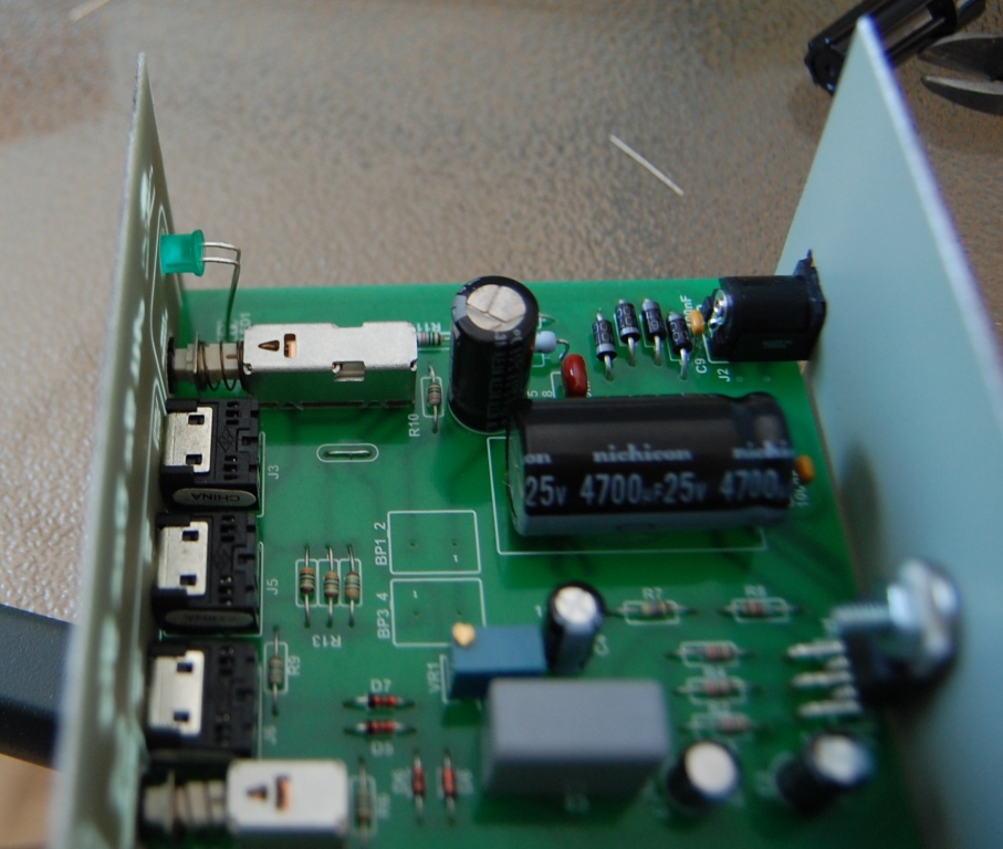

The power connector PCB in the kit appears to come with a 2.0mm center pin, according to the Data Sheet for the PCB connector .
So...it appears the appropriate plug on the transformer needs the 2.1mm inner diameter orifice? I think my plug is the bigger 2.5mm and seems bigger on that inside diameter.
I really should just add this transformer to my next Digi-Key order. 421 in stock. Positive center correct? I trace the tracks and the center pin of PCB connector heads off to the amp power switch.
However, those two pads beside the PCB connector that are unlabeled on the silk, no jumper outline like the other jumpers, are a bit of a mystery. i wonder what they are for? AC pads for some optional device?

Ooooooh!!! Light bulbs went off! So those two pads to the external side of the PCB connector could accept the pigtails from the nekked transformer output wires or a typical IEC socket and a computer type power cord with the transformer in the case. No shortage of those.

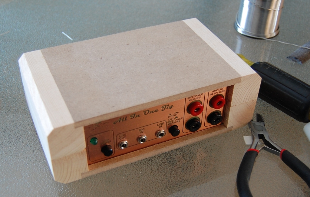

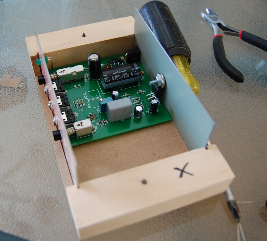

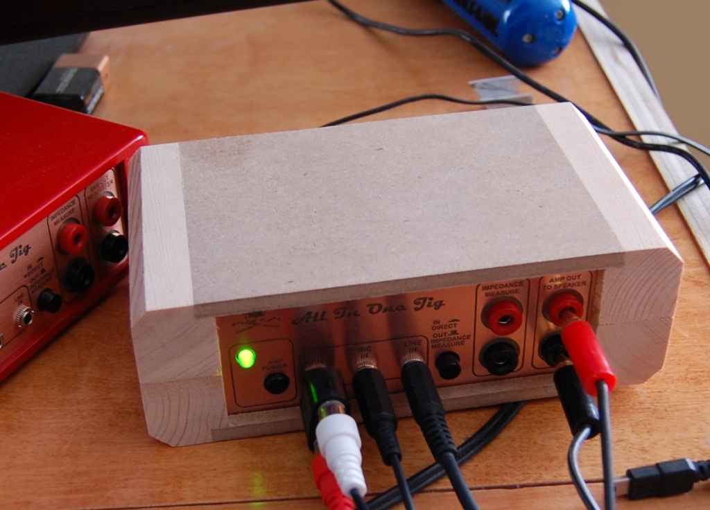

I need to rethink my case. I'm making one from scratch anyway and was about half-way through. Going for a matched appearance with my chip amp case might be nice. I was planning on veneering the jig case to match my chip amp so why not have other appearance features match, like size and rear connects.

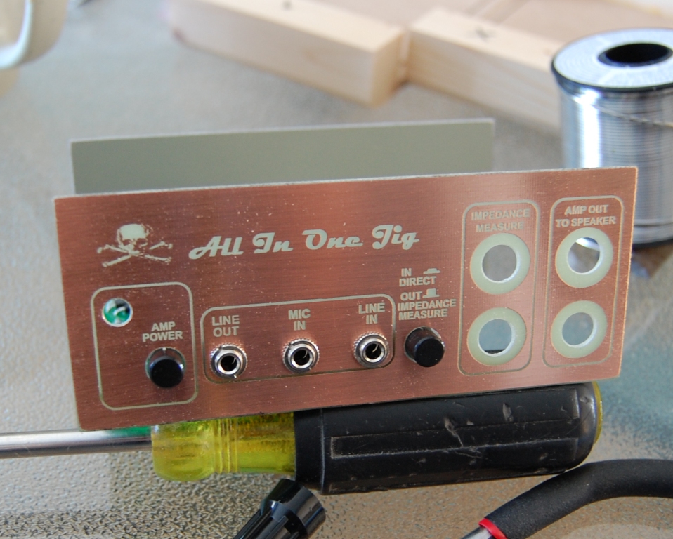

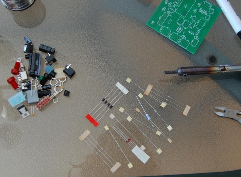

Here are detailed instructions for assembly of the speaker testing jig designed HERE.
Please let me finish posting all of the instructions before you contribute or ask a question.

If anybody still has one of these jigs and didn't get it to work the instructions left out two very important PARTS-SIDE jumpers that are marked on the board but not mentioned in the instructions. I fussed with the one I recently purchased and only noticed that in the pictures there are jumpers on the board where they are outlined in white but they aren't mentioned in the instructions. Once I installed the jumpers it seems to work fine.
Also of interest, I decided to use a full 24v PS and although it seems to work fine the resistor for the LED (R1) is only 1/8 watt and starts to get hot and stink after only a a minute or two. Thankfully the transformer I bought is a 24v secondary winding with a center tap so I can just switch to 12v and not have to replace the R1 resistor but it seems the only solution is to replace it with a 1/4 or 1/2 watt version. I haven't seen any other issues with the jig so far.

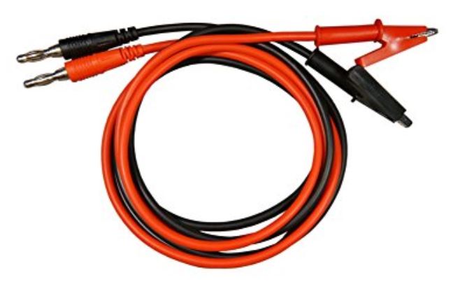

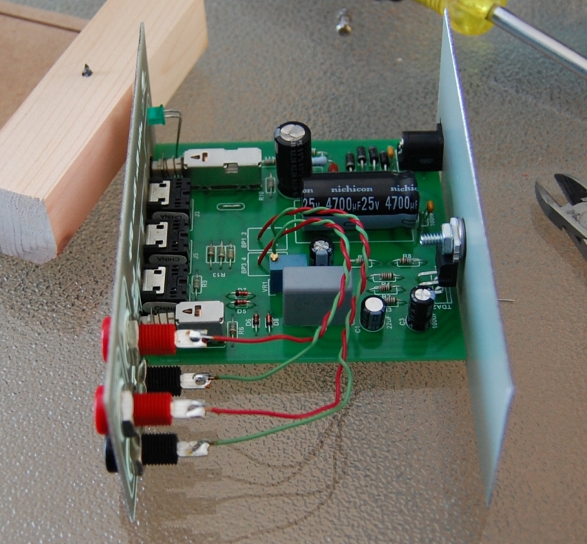

If anybody has one of these and is using it can you verify the IMP measurement procedure?
It seems the logical way to do this is with only 1 set of probes. It would seem obvious to get two dual banana connectors (red & black) and place one between both RED test lead plugs and the other between both black plugs. Then run the testing leads (12Gauge Monster wire?) down to the speaker for testing and clip them on. This should use the jig amp to excite the speaker and the IMP line-in to measure it. I was hoping I wouldn't need to purchase two sets of test leads. Monster wire is very expensive.
I have one assembled that I used a few times, I'd be willing to sell it for the original price. Meaning that I wasn't trying to sell it, but if somebody wanted one and they'd get more use out of it, then I guess I don't mind selling it. Mine is painted with Rustoleum "hammered" dark grey semi-metallic paint. If you're interested I could take a picture of it later this week.
