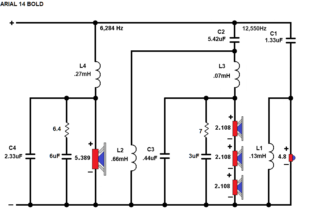

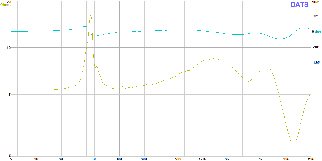

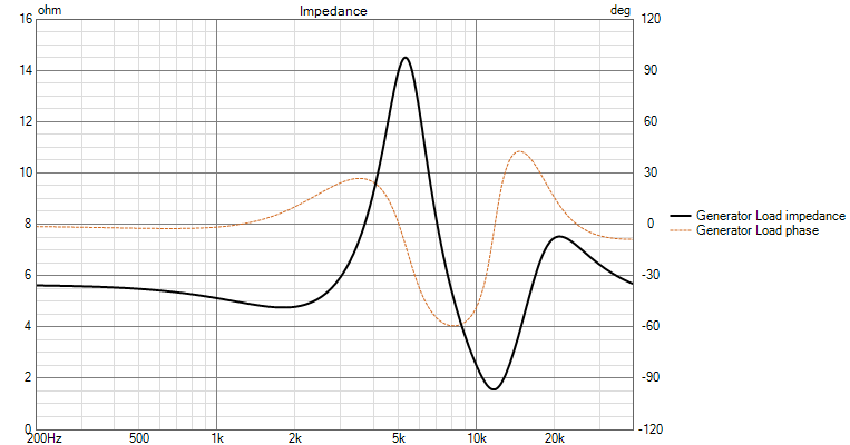

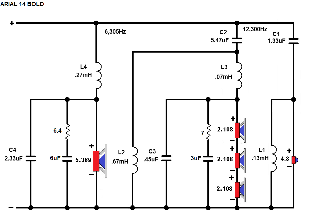

The impedance can drop on the low side, even if the crossover network is working properly. However, it is also often an indication that there is a problem.I might retest the Jensen tweeters just to make sure I calculated the zobel correctly unless sometimes it is normal for the impedance to drop that low.

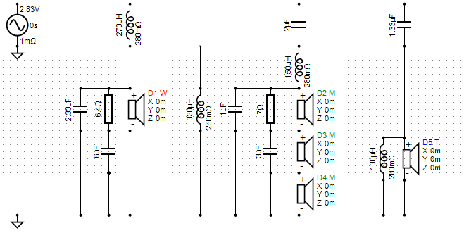

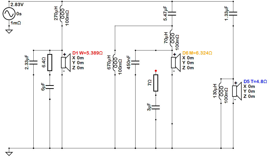

I created a VituixCAD model of the circuit diagram and its components that you provided earlier. The circuit is shown below. The woofer used a 5.389 ohm resistance, each midrange a 2.108 ohm resistance, and the tweeter a 4.8 ohm resistance.

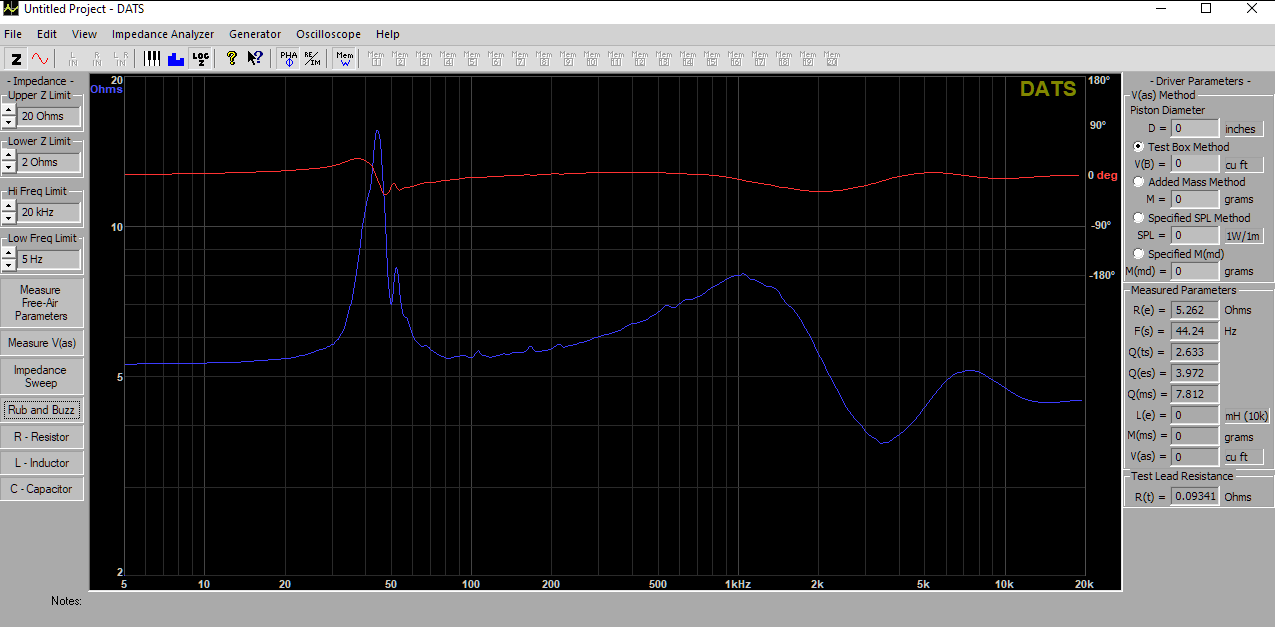

The impedance curve of the system is shown below.
The measured impedance curve of the complete system is shown below for ease of comparison.
It seems quite clear that assuming that the drivers are pure resistance loads in the VituixCAD simulation is not producing a particularly accurate model. If the impedance of each driver on its own was measured individually, then those measured results could be included in the VituixCAD model, making it much higher in overall fidelity.

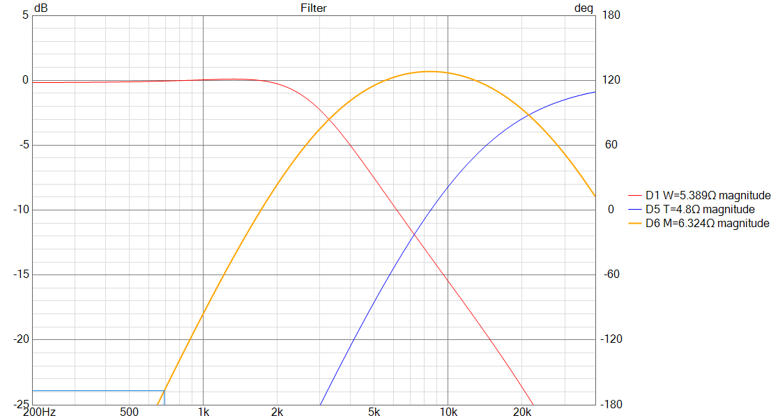

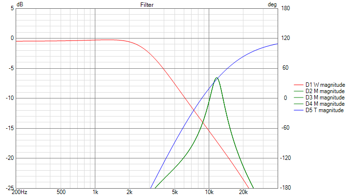

The electrical responses of the low-pass woofer filter, the bandpass midrange filter, and the high-pass tweeter filter are shown below. It's apparent that the bandpass filter is not working very well, and the peak in its response occurs at the impedance minimum. Note that adding together the identical filtered output of the three midrange drivers would create a single overall output curve that is raised by 20*log10(3) = 9.54dB, so don't be alarmed by the lower level of the three green curves.
It seems highly likely that the filter working on the Jensen tweeters (midranges) is not producing a desirable filtered response function.My concern is how that low of an impedance affects the crossover between the Jensen tweeters and the ribbon.

The green portion peak should be in the middle where the red and blue lines cross over, right?

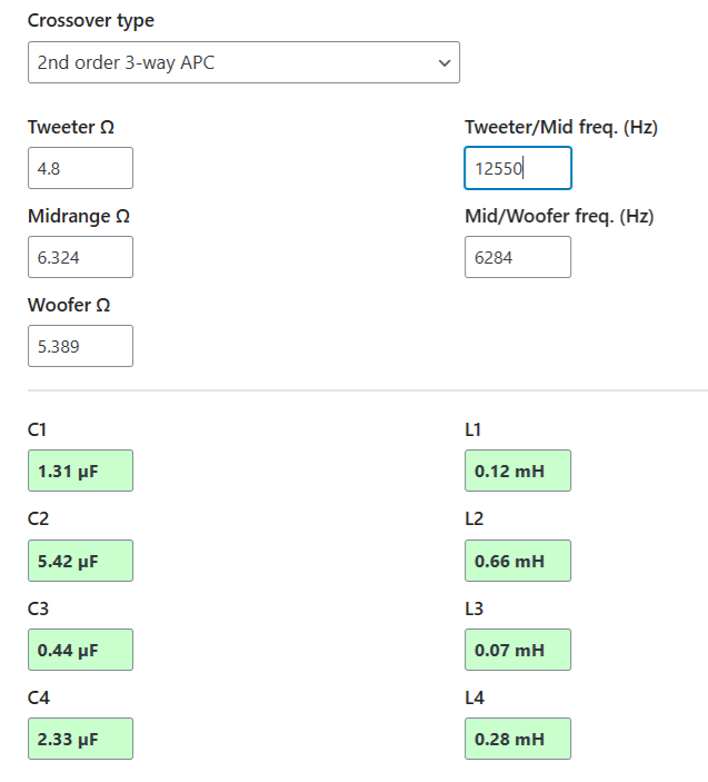

When calculating the crossover I used a two way crossover calculator to calculate the values for the woofer and tweeter and the tweeter and super tweeter given that most three way crossover calculators I've found would only allow you to select the woofer/midrange or midrange/tweeter crossover frequency and it filled the other one in which in my opinion is rather limiting.
That said I did just find a three way crossover calculator that allows one to enter both crossover frequencies.
https://soundcertified.com/speaker-crossover-calculator/
Here's the result of that. Looks like the current bandpass crossover is just a little off.
So the crossover would then become this.
Now if I adjust the frequency to the values of tweeter and woofer crossover parts I get this. C3 I can parallel two .22uF film caps, C2 I can parallel two .22uF caps film with two 2.5uF film caps in parallel, L3 I can make by unwinding some of the current L3 and L2 I might can make by unwinding some of a 1mH inductor I have.
Will you plug those numbers in and see if the crossover is better? Before I go modifying the crossover I want to be sure the new values are right.
Perhaps the bandpass filter being off is causing that dip in impedance.

I went ahead and redid the crossover per the last posted schematic.
Soon as the glue dries I'll mount it and test it with the DATS V3 to see how the impedance looks now.
I suspect the dip in impedance might have been due to the tweeters and super tweeter overlapping in their reproduced frequencies.

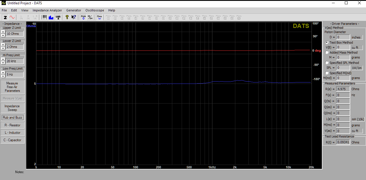

Here's the results using DATS V3 with the redone crossover. The impedance looks better and the phase shift is a bit smaller. Also just with a brief listening test I can already tell the speaker sounds better.
Interestingly enough now that the crossover is correct the bass sounds a little better and it's harder to tell that the speaker is three way versus full range.
That said this afternoon I did try the woofer by itself no crossover and it sounded fairly decent in the upper midrange lower treble region.
I know some crossover calculators are designed for the midrange to be reversed so I tried reversing the phase of the Jensen tweeters and it didn't sound as good.

Yes, most definitely. And the relatively sharp "peak" should be more of a broader plateau.The green portion peak should be in the middle where the red and blue lines cross over, right?
You hit the proverbial nail on the head. The bandpass filter actually serves to add a little bit of boost in the output, which is somewhat hidden by the method of presentation. That boost is what's leading to the dip in the impedance.Perhaps the bandpass filter being off is causing that dip in impedance.
The crossover that you've measured appears to be largely resistive in nature above 100Hz. The impedance minimum also isn't as low as before, so that's a nice overall improvement.Here's the results using DATS V3 with the redone crossover. The impedance looks better and the phase shift is a bit smaller. Also just with a brief listening test I can already tell the speaker sounds better.
I've gone and done a simulation of the crossover circuit with the component values that you provided. Note that I've disconnected the Zobel network, as this will upset the circuit as there's no inductance for it to compensate for. Also, I've amalgamated the three tweeter/midrange units into one driver with a composite resistance. This was done to better see the attenuation curve for the bandpass filter relative to the low-pass and high-pass filters.
The filter circuit as modelled is shown below:
The results that I obtained for the three filter transfer functions are as follows:
I won't provide the simulated impedance curve, as it will be nigh on meaningless.
My simulations would seem to indicate that you are in the right ballpark with your crossover. If you can be bothered, it would be interesting to obtain individually-measured files for the woofer, the three in-series midranges, and the tweeter. These would make the crossover filter simulation much more accurate, and allow the inclusion of the Zobel network in my modelling.Interestingly enough now that the crossover is correct the bass sounds a little better and it's harder to tell that the speaker is three way versus full range.

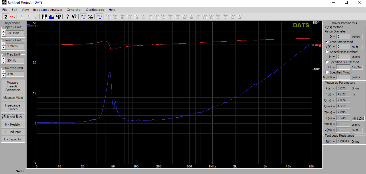

I'm a bit surprised by the impedance curve for the midrange drivers. There doesn't seem to be any resonance peak present.
Are you able to zip up the measured impedance files and post them here?
You mean the files generated by DATS V3?
I'll have to look and see how to save what DATS puts out.
The cones of the Jensen tweeters don't move at all so there may not be a noticeable resonant peak like a typical driver has.
I can measure other tweeters to see if they have a resonant peak.
Also I see one why people like ribbons. The more constant impedance.
