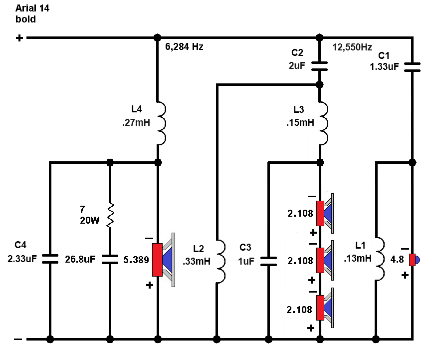

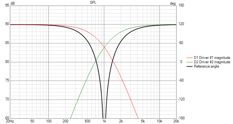

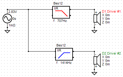

Thanks for providing the data. It makes the simulation work much more useful. Here is the circuit that I've created. Each driver now has its own ZMA impedance data file attached to it.
The simulated filter functions and the system's impedance curve are shown below. I think that there is now a quite good match between the measured system impedance curve and the simulated one, which is comforting.
The simulated filter transfer functions are shown below. Note that the crossover between the low-pass filter and the band-pass filter in the 2kHz–7kHz is not ideal, as the cross at 4kHz with almost zero attenuation happening. The end acoustic result will of course depend on the acoustic responses of the drivers as well, but the present simulation does provide some useful insights.
The band-pass filter on the midrange/tweeter units seems to be nicely doing the desired job, as is the high-pass filter on the ribbon tweeter. It would seem that the knee of the low-pass filter on the woofer could do with some shifting down in frequency, so that it is −3dB down at around 2.5kHz or thereabouts. Of course, doing that will change all the relative phase shifts through that crossover region, which may require a polarity inversion on the woofer for the best results for the acoustic response function.

One possible issue is I used the impedances DATS showed when I measured the drivers when doing the original 6dB/octave crossover. Not sure why the woofer and Jensen tweeters read slightly different now. I need to see what version of DATS is installed and see if that could be causing a difference in measurement or would using a USB 2.0 port on my Windows 10 PC to power it versus the USB 3.0 port on my Windows 11 PC cause a measurement difference.
Would there be any benefit to removing the resonant peak the woofer has?
That requires a 164.7uF cap, a 75.3mH inductor and a 7.4 ohm resistor.

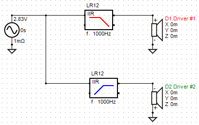

I think it is worth pointing out that at the very start of the schematic diagram, the 2.83V source signal is quoted as having an impedance of 1m ohm >Thanks for providing the data. It makes the simulation work much more useful. Here is the circuit that I've created. Each driver now has its own ZMA impedance data file attached to it.
If the drivers were all full range, then they would sum together something like the following, assuming that they are all coincident (X=Y=Z=0 for all the drivers), which of course is not the case:
this doesn't actually equal the impedance of the tube-output transformer, so the simulations are not strictly accurate > by how much I'm not sure.
True microphone/analyzer measurements are more accurate given the non-linear impedance of the output transformer. Good ears are also invaluable.

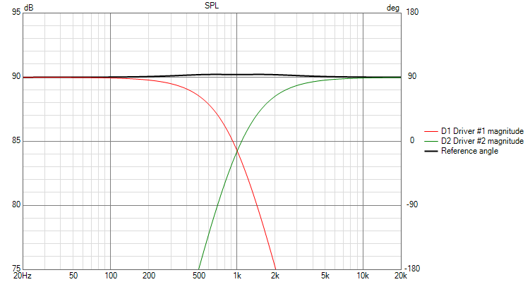

Here's the simulation of the filter functions with Rg=1mΩ.
And now we increase Rg to 4Ω, which is a damping factor of 2 re 8Ω. The differences are noticeable, but not huge in their effect. It all boils down to knowing what that output impedance is.
So the damping factor is a reason why some multi-way speakers sound better on some amps than they do on others as it has an effect on the crossover performance.

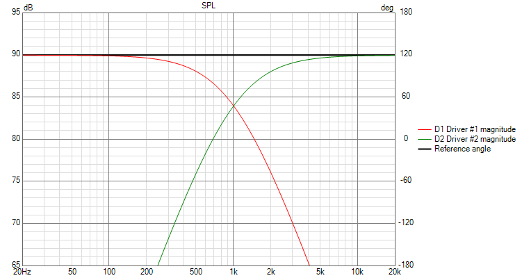

Yes, amplifiers with low damping factors will cause audible frequency response changes in the acoustic output of multi-way loudspeaker systems. Below is a graph that compares the simulated frequency responses of vented box loudspeaker when it is connected to amplifiers with damping factors ranging from 1 to 16. It's not a pretty sight.
Below are the results for loudspeaker simulation with amplifiers whose damping factors are 100 and 800. The value of 100 is easily attainable by many solid state amplifiers. It's clear that the loudspeaker's frequency response is affected much more subtly.
