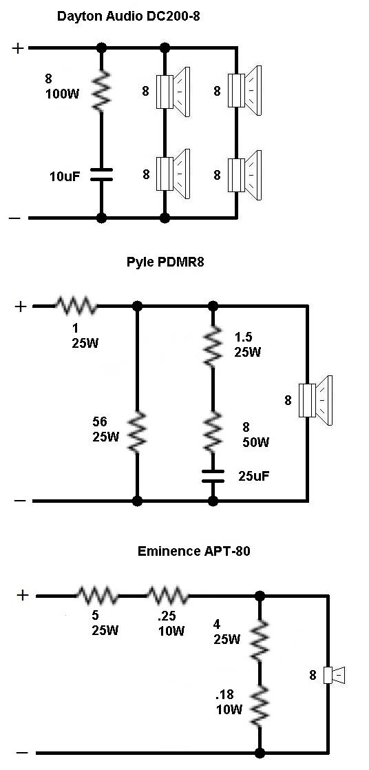

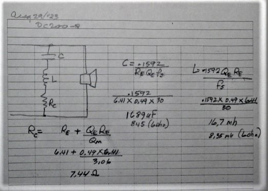

Now the crossover itself had two non-polar caps which I replaced with film caps as I wanted the speakers to be something that 30 yeas down the road I don't have to open up and recap.
Now would there be any use to using the DATS V3 connected to the whole speaker to see what it measures like?
Skuttle the zobels and save about $140.00
That's a good idea, run an impedance check on both systems, all wired up and ready to play. I do it all the time before connecting it to an amp.

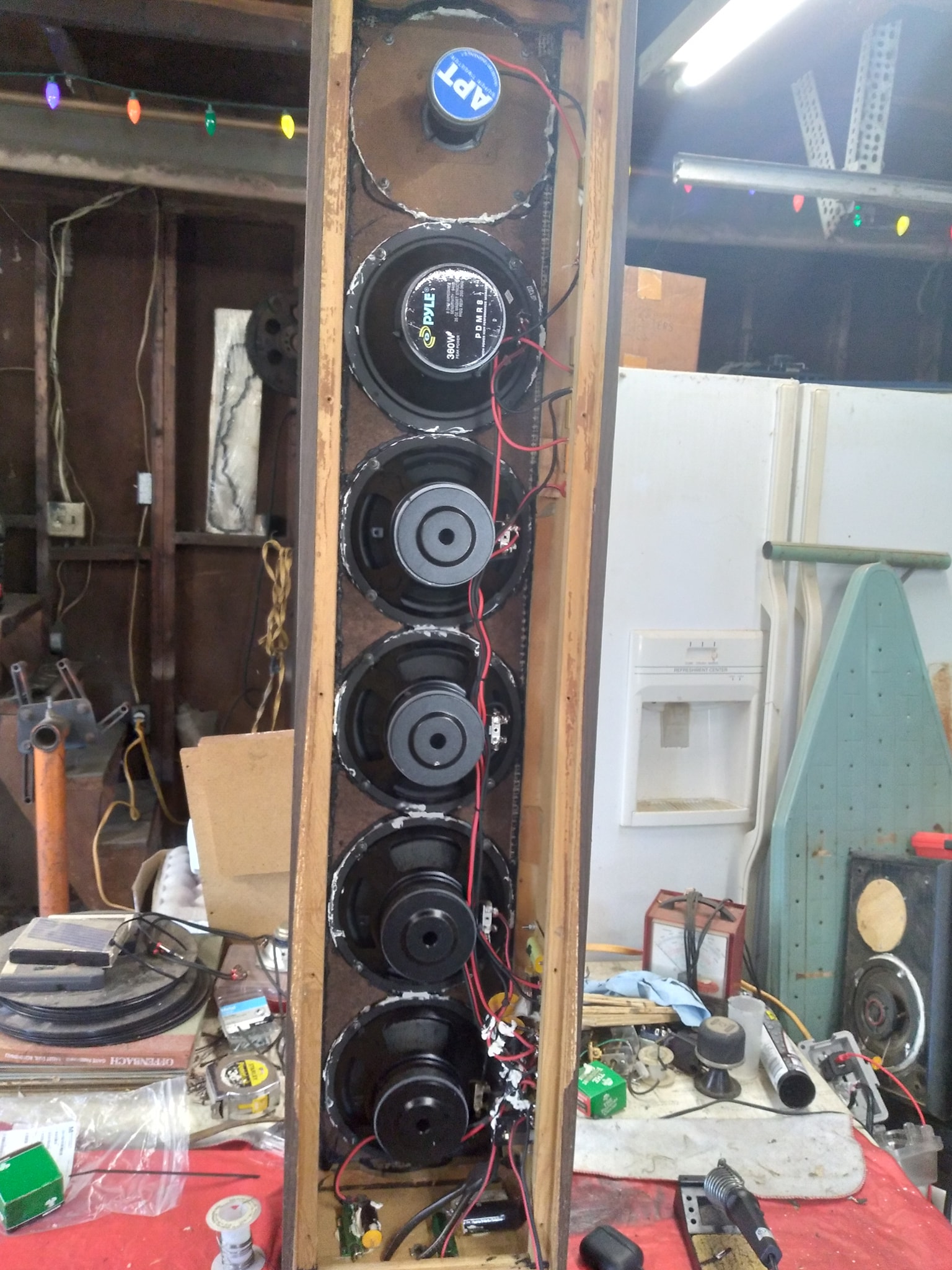

At some point when I have the money I need to get four cabinets built to the following internal dimensions.
I'd probably use 3/4" thick wood.
H 45"
W 11"
D 7"
Which will be 2.005 cubic feet.
