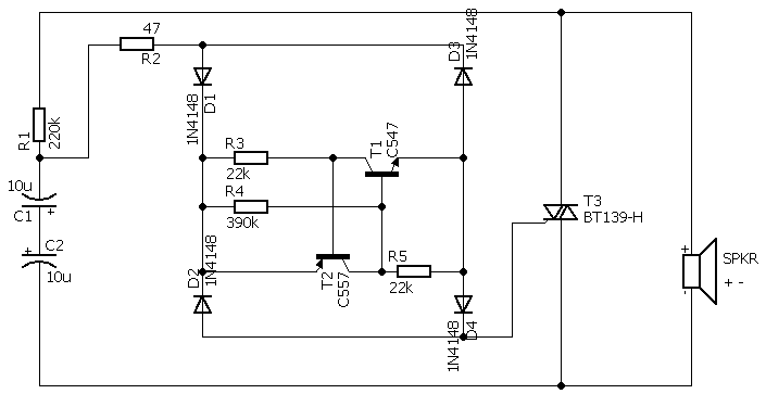

Hello everzbody, i looking for speaker protection (dc protection) but without power supply that i can mount directly on speaker , i saw couple of these devices but i cannot find schematic
I remember a passive (no external power) mosfet that would be mounted at the speaker terminal. With DC, it closes the circuit and shunts the amp. I think Apex designed it and Prasi made layout.
Was it post 2218 in thread http://www.diyaudio.com/forums/solid-state/173462-studio-reference-amplifier-222.html#post4837066
Yes, that was it. It has a couple of BJTs even. Fits inside speaker cabinet and passively powered.

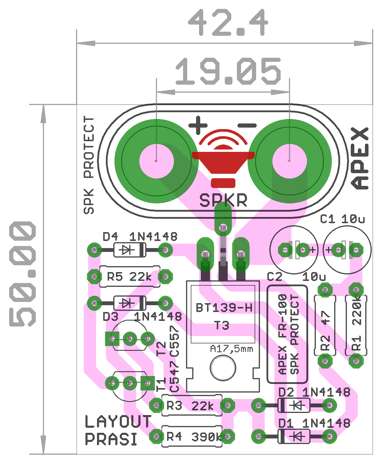

here is the sch. it can be mounted on 0.75" speaker binding posts
According to Elliot's guides these electrolytics capacitors will be a future problem.
When they dried this circuit will blow up the amplifier without any other reason.😱

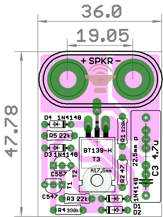

Prasi, you must draw again for not electrolytics here😉
film cap http://www.farnell.com/datasheets/2...3.1055681548.1508483769-1572543905.1506810295
Thats'it! Thank you!! i will put film caps. Another option it will be with relay and trimpot that i can adjust level when relay will switch off speaker
