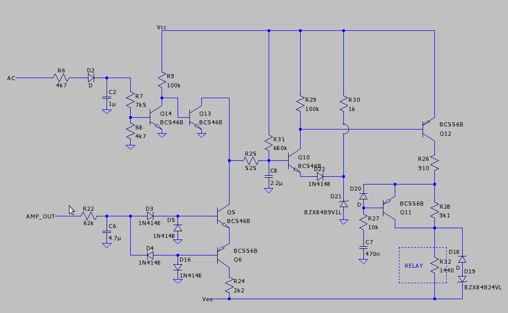

I am trying to build a speaker protection circuit with relay, doing protection against DC offset, delay at powering, and AC loss detection.
It is for a mono amplifier, with +/-20V power rails, and is based on Douglas Self circuit.
There are some things that I am not sure about. I am not familiar with switching circuits.
Q5/Q6 and Q13 discharge C8 throught R25 when power is removed for Q13, and if there is DC at the output for Q5/Q6. Could I connect them like this, or do I need one or two diodes to isolate them from each others? If yes, should I use pull-up resistors too?
I am not sure wich value choose for R25. It should limit the current, but as the discharge of C8 is really fast, I think I could use lower value as the transistors will dissipated power for a really short time.
I don’t really know how to choose the maximale value for R22 too. It limit the base current of the DC detector transistors, but as we don’t know wath he value of the offset will be, I don’t know how to calculate it.
For the loss of AC detector, Douglas Self said that C2 should be an electrolytic capacitor, but I don’t understand why, as in my simulation it work well with a 1uF capacitor. For now I have just use (only in simulator) random value with no calculation, it seem to work well but I have probably overlooked something.
There are probably things that could have be done better. Any critics would be really appreciated!
Thanks a lot for your help!
Please apologize my bad english.

Thanks mikeAtx!
I'll have a look to MID400 datasheet. But I would like to use only "standart parts" if possible, I should have specified it, sorry.
I don't need the AC loss detector to be really fast. The amp produce a noise something between 0.5s and 1s after the power is removed.
I use virtually the same circuit in my amp and it has been faultless.
R6 and D2 can be duplicated to also monitor the other side of the secondary winding rather than just monitoring one side.
100k and 10k were originally the values used for the resistors at the input, arranged slightly differently to yours with no 1uF cap needed. Your R25 would be 100 ohm and the other electrolytics 10uF.
Your Q13 should be a high beta type.
Essentially the same circuit with differences 🙂 Look it up, September 1996 in Electronics World magazine.

I know this circuit. 🙂 In July 1999, Douglas Self published an improved version of it. (It is in "Audio power amplifier design" too.) This is the one I'm using as reference.
There have perhaps been a few variations of that circuit 🙂 Just looking at the one in edition 6 of Doug's book (fig 24.32) and that is slightly different again. I'll have the July 1999 mag tucked away.
The circuit works great. Instant disconnect of the speakers on power off and a repeatable delay even after a short mains interruption.
I have no doubt it is working great. 🙂 I just try to adapt it to better suit my lower rail voltages. It also allowed me to use a lower value for the timing capacitor, so I don't have to use an electrolytic one.
Furthermore, I really would like to learn how to calculate the values of components, and not just copy it as it is.
Have you use it for DC offset protection too?
I did add DC offset protection. Its a long time ago but it was based on Dougs circuit.
If you look at the board here you can see it is a similar design (post #267)
Output Relays
Component values are not very critical. The relay driver and any series resistor has to be able to drive the chosen coil value.
Its very important to ensure that any base bias resistors are able to fully turn on the transistors if using lower supply voltages. So that is things like the 100k's
Same applies to the AC detect input and also the DC detect input. The R values have to be low enough to allow the transistors to conduct correctly at the appropriate input levels.
Its a wired AND gate, no need for diodes as both transistors (Q5, Q13) are pulling down toward ground (or slightly below ground). The emitters of Q5 and Q6 are constrained to be within +/-1.3V of ground by the 1N4148s. Note you can replace all 4 1N4148s with a small bridge rectifier as the topology is the same.
Probably, the value isn't crucial, I'd make it 470 anyway as that's an E12 value.
The pull up on C6 is 680k, meaning Q5/Q6/Q13 only need to pass 30µA to operate the protection, so their base currents are miniscule.
R22 and C6 are chosen so that R22 can handle full swing voltages without burning out, and their time-constant is suitable to allow 20Hz full swing to
just fail to operate the protection. Make R22 too small and it would have to
be a power resistor, too large and you'd be worrying about base-drive but given
only a microamp or so is needed I think its OK.
To keep the size down?
Thanks! In my simulation, when Q5 goes low, it was sinking current from Q13 collector. I found it strange, and that was what give me doubts. Furthermore, Douglas Self use a diode and a 220k pull up resistor on the DC detector side, but not on the AC loss detector side.
This is what I would do too, 525 was just for simulation. But the original circuit use only 100ohm, hence my question.
just fail to operate the protection. Make R22 too small and it would have to be a power resistor, too large and you'd be worrying about base-drive but given only a microamp or so is needed I think its OK.
Nice, thanks a lot!
Would it cause an issue to use ceramic capacitor here?

Sorry, I don't know how the circuit in edition 5 is. You can find the one in edition 6 in Electronics World magazine from July 1999, or in "Self on Audio" too.
In regards to filtering and low frequencies, a lot has been made about DC amps and extended LF response. Well, I believe strongly in limiting LF response to minimize woofer excursion below Fb. I run a 40 Hz second order to my mains now, 15 Hz to my sub. That gives considerable margin separating base notes from rail fault. That is in addition to the crossover.
I will limit the bandwidth in the preamplier stage.
Thanks a lot! I need some time to digest all those informations, but it really help! 🙂
