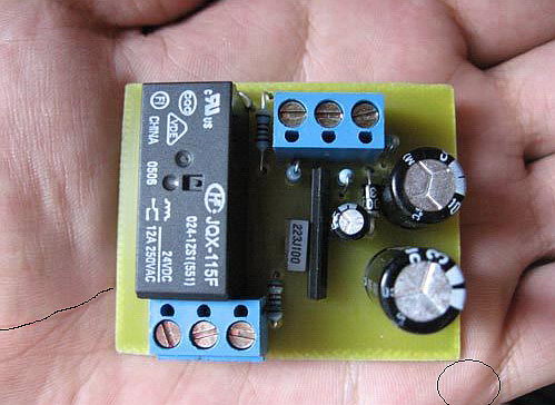

the uPC1237 is aslo manufactured by NTE as NTE7100 http://www.nteinc.com/specs/7100to7199/pdf/nte7100.pdf and is available from Mouser. This might be the route I take as well, but my circuit is a bridge and would need 2 of them per channel in parallel, becase both output offsets could be of equal value +/- VDC. Since the speaker doesn't connect to GND but rather floats between the two outputs, the chip would be fooled by the input resistors on pin 2.
Still cheaper and easier than the descrete alternitive, when considering PCB space.
Pardon me, but, could we focus on the audio issues and find another forum for the family issues.
That said, is there an app note for this chip that can be read in English? Also, the board that is shown does not have any provisions for mounting.
I would be interested in a number of these boards if there is a way to operate from 80VDC. It would seem to me that a voltage divider or zener diode could solve the problem.

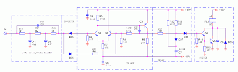

How about this one... found it in one site which I don't remember where 😀
short description... note the unit is coonected in the speaker terminal. maybe somebody want to try in simulation.
The filter network comprises a pair of cascaded low pass filters R1 and R2 and capacitors C1 and C2. The high pass filter includes values for resistor R1 and R2 and capacitor C1 and C2 are selected so that DC and AC signals significantly below 20Hz in frequency, i.e. below 2Hz, are passed to the filter output line. The electrical values for R3 and C3 are selected so that signals significantly above 20,000 Hz, i.e. above 200,000 Hz are also passed to the output. As such, the filter blocks signals in normal audio band between 20Hz and 20,000 Hz while passing significantly outside the normal audio band to filter output.

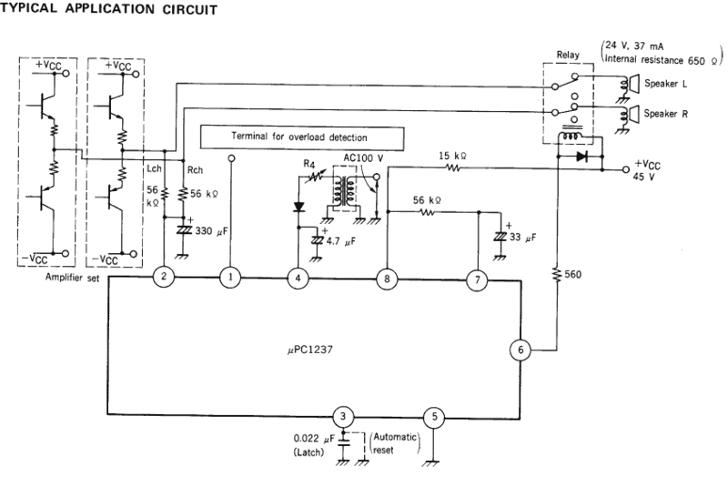

HiUPC1237HA(MS) Discontinued 04/1997
UPC1237HA Phase-out 04/2008
UPC1237C Limited production
http://www.necel.com/nesdis/image/IEP-730A.pdf
Look at page 4
Pin2 senses DC offset.
pin 3 is connected to ground or to ground via a cap to form a latching protection.
pin4 sences ac off through a diode and resistor
pin5 connects to ground
pin6 drives relay through a resistor, the other side of the relay connects to DC+ supply
pin7 connects to pin8 with external 56k resistor and has 33uf cap to ground
