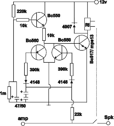

speaker protect schema here
I build this the last week and work well.....this detect +/- tension.
I use one circuit for each channel and idividual relay...
No offence, but the upc1237 chips are less than a dollar,
will detect AC loss, as well as DC offset... All it needs is about 5 resistors 3 small electrolytics, 2 diodes, and a small film or ceramic cap. can be used with as many channels as you like as long as they are powered by the same PSU... as it samples AC before the rectifier and DC after it...
Better yet, it needs no dedicated power supply like your 12V rail, it powers itself through the senseing wires... can be used on amps from 25 to 60VDC.

To assemble with transistors we can do those things easier... i am also searching for a complete schematic..but i want off set sensor.. also o would like to adjust the time delay to enter the speaker... would like to have monitoring leds to show me the circuit operation and so on.

As much as I agree with Nordic about the superiority of chip-based solutions it’s always nice to see examples of how discrete circuits accomplishing the same things are put together. After all, if no one would pass on this know-how there eventually wouldn’t be people left to design the chips in the first place.
Could someone perhaps present some simple ideas of how this circuit could be modified to house features such as a fault indicator LED and the aforementioned AC loss detector?

UPC1237HA(MS) Discontinued 04/1997
UPC1237HA Phase-out 04/2008
UPC1237C Limited production
http://www.necel.com/nesdis/image/IEP-730A.pdf
Look at page 4
Pin2 senses DC offset.
pin 3 is connected to ground or to ground via a cap to form a latching protection.
pin4 sences ac off through a diode and resistor
pin5 connects to ground
pin6 drives relay through a resistor, the other side of the relay connects to DC+ supply
pin7 connects to pin8 with external 56k resistor and has 33uf cap to ground

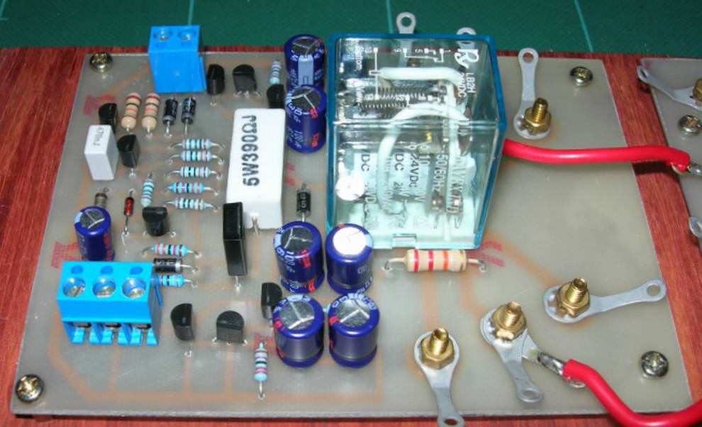

Speaker DC protector
This I have constructed and works very well.
No need for additional transformer.
R1 & R2 can be configured for various voltage from +25V to +70V
Includes AC detect for delay turn on and off for speaker.
Cheers.........Raj

Hello Carlos / Nrik
The circuit is by Siliconchip magazine issue July 2007 under 20W class A amp.
Please get it as I cannot post it here.
Carlos, I will send you the image of construction. Please post it here as I do not know how to load here. The image is too big.
Working very well. Tested with 1.5V dc input and it works good.
Cheers...............Raj.

Hi RSK,
You can post the schematic, as long as it the one you have drawn and not an actual scan of the SiliconChip article. The circuit is not copyright but the publication, pictures are.
Carlos already has the complete set of the Silicon Chip 20 watt class A articles.
regards
Here is RAJ construction of the Silicon Chip magazine protection
I cannot post the circuit.... it has copyrigth.
RAJ boards are good, made at home.
RAJ have already offered to produce boards for friends, at very reduced price, almost the cost to produce the boards plus mail costs.... he can enter as the provider of boards to some small group buy we organize.
Was offered some monthes ago.... now a days we have to contact him in advance and arrange those things.
He do not use silk screen over the boards.... they are made at home but really professional work.
RAJ do not need to own money from forum, he has a very confortable life in his country... his intention, when have offered, was the cooperation only..i ensure you that.
