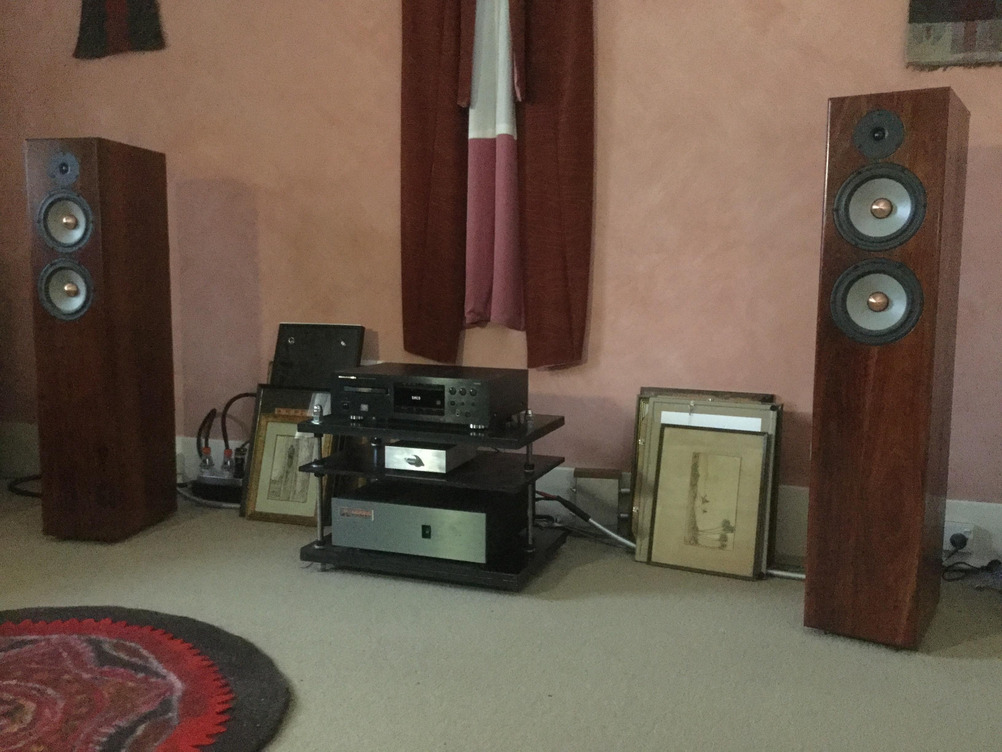

Yes, your room presents a very difficult situation, maybe the most difficult of all. I have had similar rooms in the past and found them difficult. My current room is very unsymmetrical and difficult. It took me a long time to obtain my goal as described. In my room I sit way over to the right side as there is an obstruction in the middle of the room where I might naturally prefer to sit. It's pretty hard to remove a fireplace from a house. And I prefer to not sit in a moveable chair in front of the fireplace.
Generally, one can sit pretty close to the middle between the speakers. I used to, until I got tired of the desk chair on rollers and preferred the comfy old chair off to the side.
Here's a pic that shows the speakers in the room, taken from my listening chair. I have since moved the player and volume control box to be over in the corner above the not shown subwoofer. If I had an updated pic it would show the speakers to be much as in the pic, though I have moved them some. Left speaker is now a few inches more out into the room and the right speaker is about the same.
With the way I do it, it is all about the speaker's relative position to each other that is most important, after getting them far enough away from the wall to not be coupled to it.
From my seat, I have a perfect L-R stereo image, same as if I sat in the middle. Mono is also perfectly centered. I have a lot of 50's jazz and much of it is mono, so mono is a big deal.
