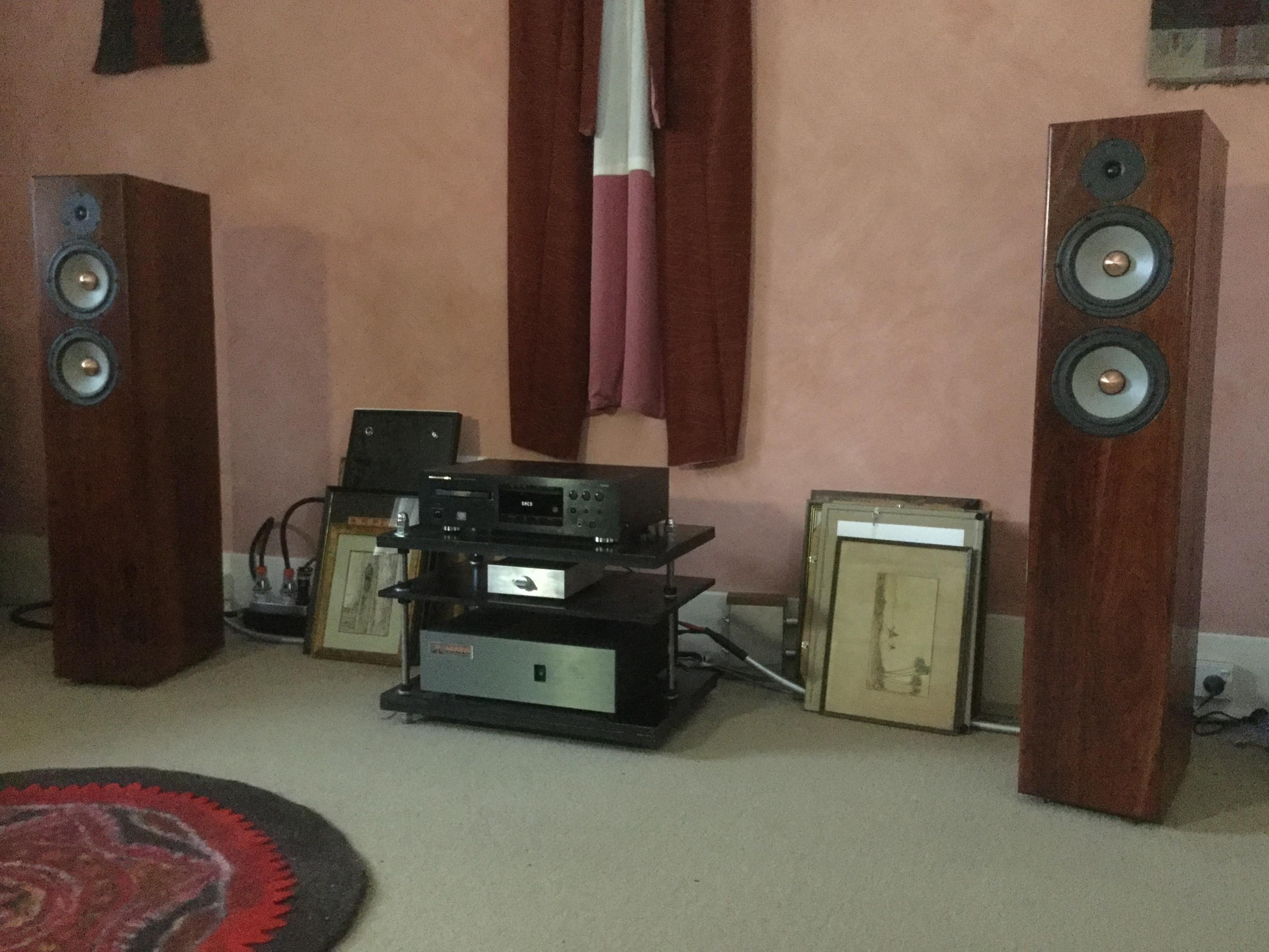

I have posted a pic of my set up. As can be seen it looks fairly conventional. However, the speakers are positioned perfectly to work completely together.
Thanks, very nice system. Are those speakers DIY ? they are stunnig.

My whole system is DIY and pretty much one off.
The player is Marantz on the outside and DIY inside.
The volume control is constructed by me from Tortuga audio parts.
The amp was designed by Hugh Dean and Paul Bysouth, both active on the forum, and completely constructed by me, including the pcbs and their design.
The speakers were designed by Rick Craig of Selah Audio long ago, and were constructed in 2018.

My pic does not show all. The speakers are 2 1/2 way and there is a sub in the corner to the right of the right speaker that fills in the bottom couple of octaves and has a steep midbass cutoff.
