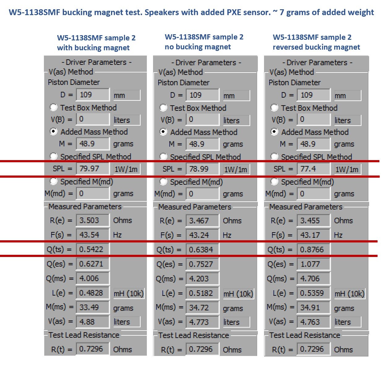

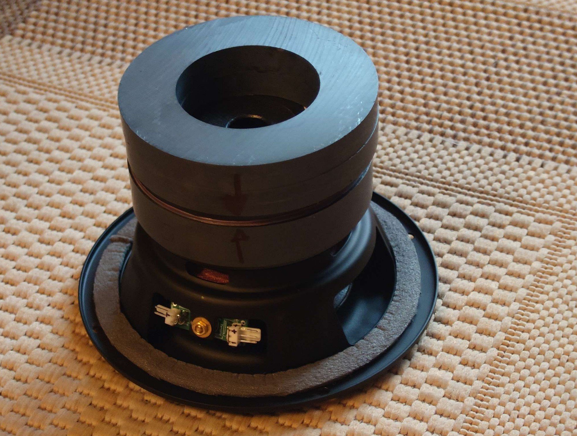

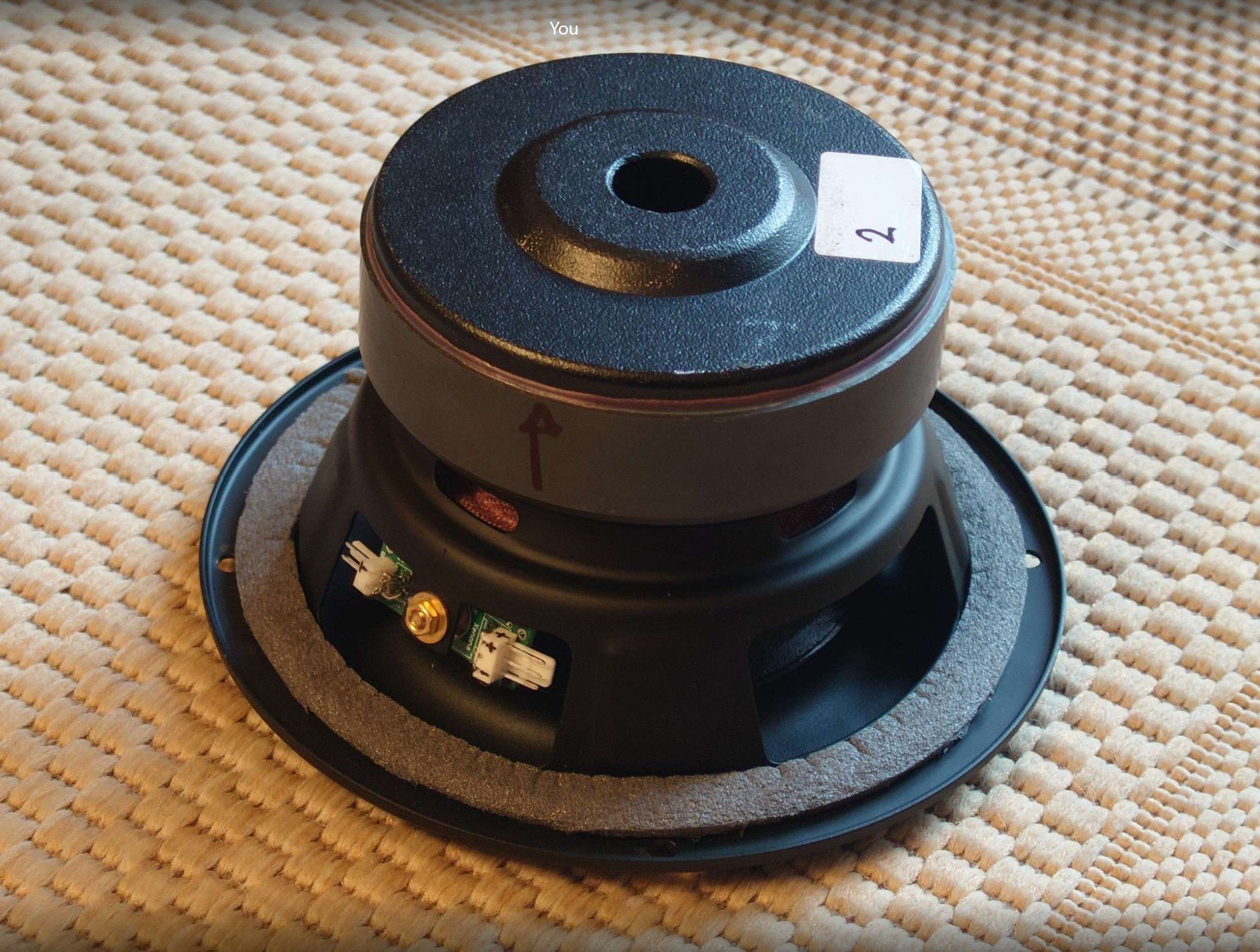

To add a bit of info to the thread.
I have tried adding additional magnet in an effort to decrease a bit the Qts of Tang Band W5-1138SMF speaker.
It works.
It works.
The correct (Qts decrease in my case) orientation behaves exactly like described by @wolf_teethYou'll find that the initial fields will repel, but once pushed through them, it will attract just fine.
