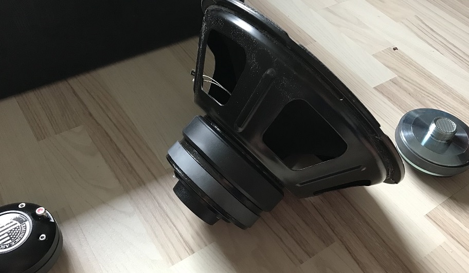

I took an old Vifa M21WG-09-08 woofer with a QES of 0.79, and with 1 Neo ring magnet on the back I measured a QES of 0.64, and with two I measured 0.58. There's also an extra 1db sensitivity with the two magnets.

I have measured 2dB higher sensitivity of a woofer with bucking magnets.
I had some drivers with Neodymium magnet rings. I first tried 1 bucking magnet and it gave approx 1 dB extra output playing white noise.
3 magnets extra gave slightly more than 2dB extra output.
It increases the total flux of the magnet system and i guess it helps keeping the ferrites magnetized longer over time as well. Another benefit is the added mass that counteracts the reactive forces from the voice coil, which gives more dynamics and less vibrations. And it requires less power from the amplifier to produce same SPL!! Actually if you think about it, it reduces the amount of necessary electrical current in the voice coil and less power dissipation. And less power compression. Lower power in the voice coil means less temperature buildup.
If you build your own speakers, do not hesitate to experiment with bucking magnets!
As far as I am aware the addition of a magnet, on the back of a driver outside the magnetic circuit, operates on the principle of redirecting the stray field produced my the main magnet. That is flux is lost from the magnet within the magnetic circuit by the stray field it produces and the additional magnet forces this flux back where its useful.
Contrary to what some have said here this can have a significant affect on the sensitivity and final Qts of said driver but it's going to heavily depend on the construction of the magnetic circuit of the driver in question.

Looks like Troels placed his magnets N-N or S-S and then due to the repulsive force had to glue them on. This is what I thought would work. Don’t just slap the magnet on the back of your woofer, press the repelling sides together and glue that sucker on with JB Weld. This will increase the magnetic force. Cool!
Measure the Qts of the driver in both orientations. Shielding with opposed fields will cause the Q to go up. Correctly adding the fields will lower Qts. Mark with a sharpie the right orientation, remove to add epoxy, and place back on the driver in the correct placement.
You'll find that the initial fields will repel, but once pushed through them, it will attract just fine.

I have tried adding additional magnet in an effort to decrease a bit the Qts of Tang Band W5-1138SMF speaker.
It works.
The correct (Qts decrease in my case) orientation behaves exactly like described by @wolf_teeth
