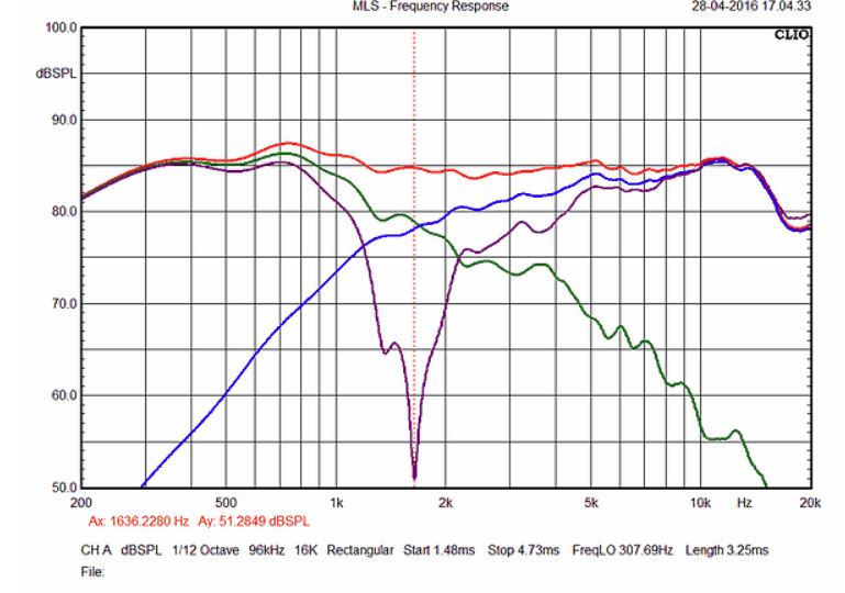

below i have attached a graph from the above link you have read.
although you seem to percieve it as "excellent phase alignment", it is not, the phase tracks merely from 1.5K to 3K
the thread below shows examples of far better phase alignment
The importance of phase tracking
in the above thread, post 9 with the graph labeled "A_phase_2nd" shows tracking from 400Hz to 5K
in the above thread, post 19 the graph shows tracking from 700Hz to 8K
My "excellent phase alignment" quote was about Troels' speaker not the one you linked to. (sigh again)

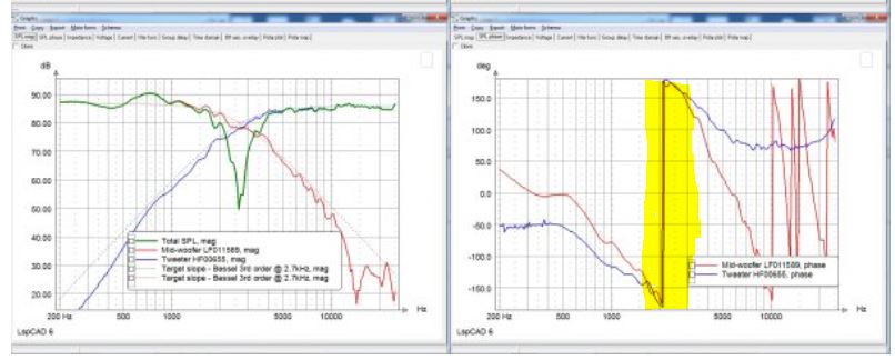

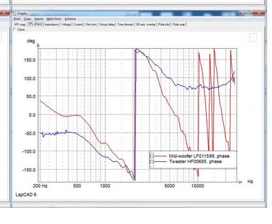

What I said about the graphs you linked to was that "every single deep reverse null has excellent phase alignment at and close to the xo point". Here are the FR and phase graphs together this time for one of the examples you linked to:
The xo is at ~2500Hz and the phase matches perfectly at that frequency and within the frequency range I have highlighted. In this example the width of the reverse null is not as wide as with Troels' design though, but it's still much better than no alignment in the xo region at all.
I am still open to being shown that a deep reverse null can be achieved without good phase alignment in that xo region. Always interested in learning something new.
They track well but they are not what one would call aligned; they do not share the same phase angles at the same frequencies in the xo region. Therefore, no reverse null to speak off. Note I'm not commenting on the validity of the xo, only on the nature of the reverse null.

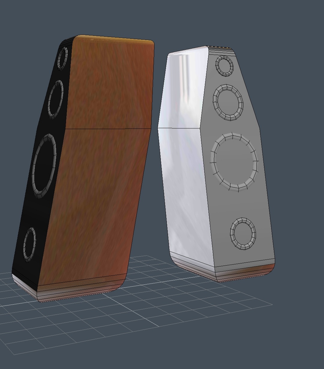

First of all, thank you guys for patricipation in this discusion, but I am starting to feel like a ''golden retriver'' (means I am tech. not on this level of discusion 😀 )
this quote from jReave is what I thought in the begining. How often I am going to be in perfekt liesening position? +/- 3° (left, right, up, down). Speaker schould perform in this range least 95% performanse?
Anyway, I did some new 3D box designs, and original 14° tilt for whole enclosure will be ok (from aesthetic stand point) so only change will be woofer mowing forward approx 10cm and under 14° angle:
Can you guys give me you final thoghts on this, so i can start with project, without changing XO.

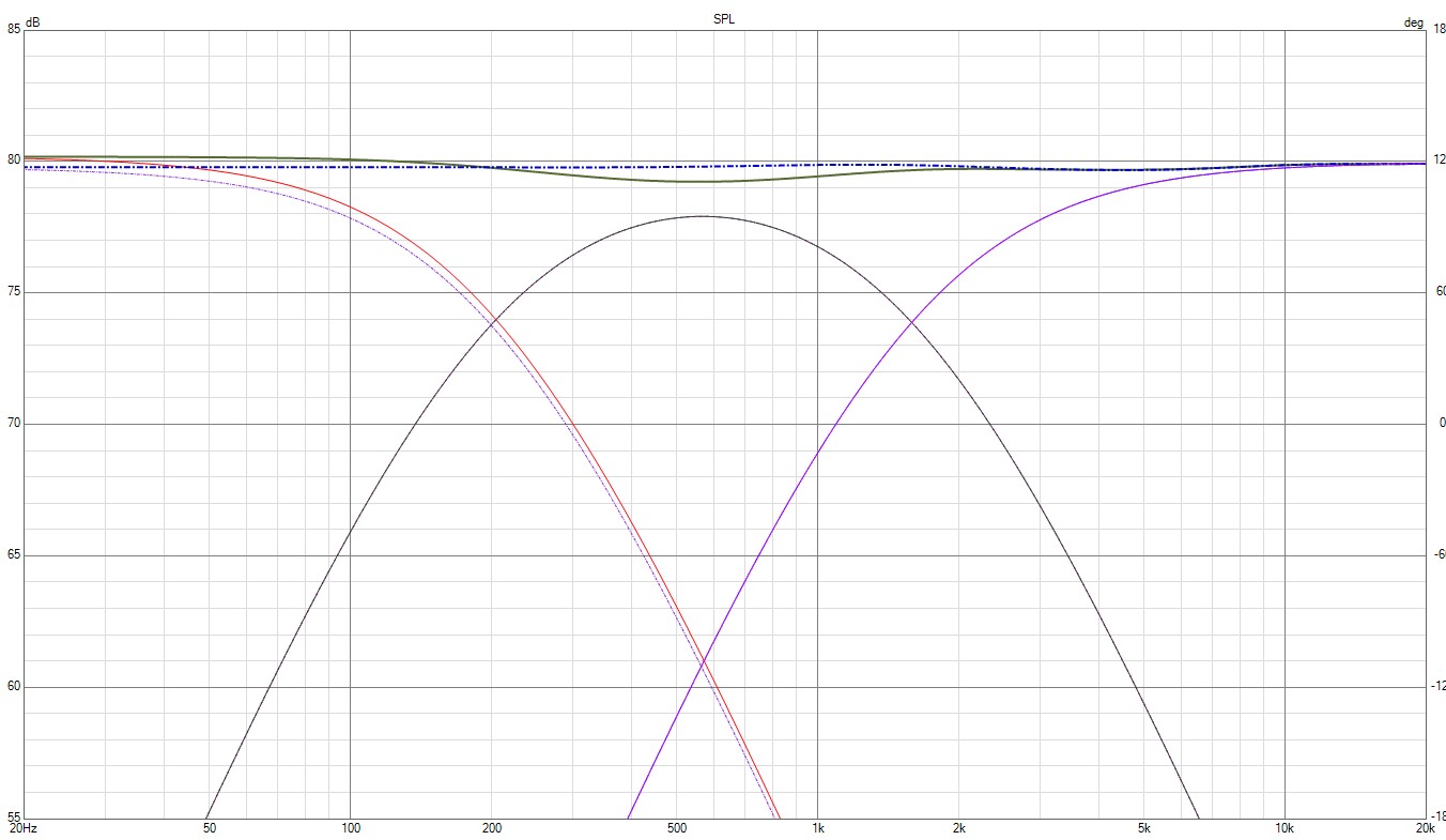

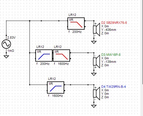

For what it’s worth: Here's a first cut simulation showing what might happen when the woofer is moved ahead toward the listener by 10 cm.
1. The simulation uses perfectly flat driver responses and text book filters that match Troel's 200/1600 Hz crossover points and LR12 slopes. No baffle step effects were included. This shouldn't be an issue since we're just interested in the change in response when the woofer is moved.
2. I used the tweeter as the design axis so its position is 0, 0, 0. I calculated the Y values for the mid and woofer. I did it on a plane so you may want to verify.
3. I assumed the cabinet slope puts the mid and tweeter on the same acoustic plane so the mid's delta Z = 0.
4. The woofer's acoustical offset is unknown in the original position so I used a value of zero.
I attached the crossover diagram and a response diagram. The response diagram shows the original responses (woofer Z offset = 0) with dashed lines and the modified responses (woofer Z offset = -10 cm) with solid lines. I was somewhat surprised where the biggest change (~ 1 dB @ 600 Hz) occurred.
For a 2nd cut simulation I’d start with manufacturer’s IB plots, add the simulated baffle step responses and use minimum phase versions. You could even add in the driver’s simulated low end responses if desired. The still unknown variable would be the woofer’s acoustic offset.
