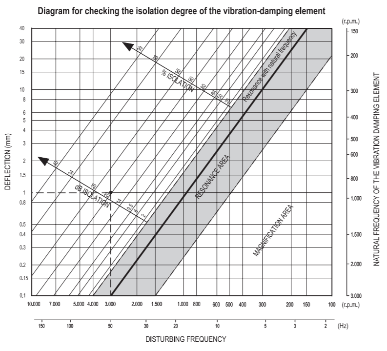

Vibration isolators are (should be) tuned to the load on top of them. If disturbing frequencies come from a loudspeaker or a machine has no bearing on the function. In general, the isolator should have its own resonating preferably 1 octave or more below below the lowest disturbing frequency. It starts to isolate from root (2) = 1,4 x the disturbing frequency. So, to isolate from 20 Hz and upwards its own resonance should be 14 Hz or lower. If its resonance is 20 Hz, it starts to isolate from 1,4 x 20 = 28 Hz, the higher the frequency the better its isolation. The SD Damping feet can be had for speakers up to 100 kg (220 lbs) / each.

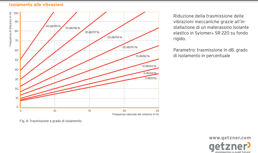

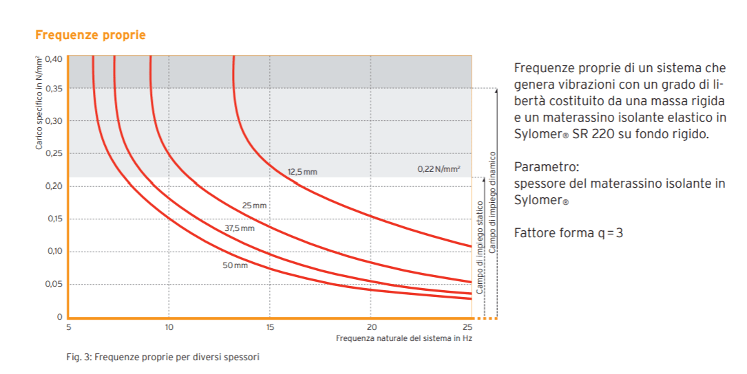

It is enough to "concentrate" on the lowest disturbing frequency which is possible from the system, no need to give a range. If the lowest frequency can be treated well enough, all frequencies above it will be even better isolated. The thick, bold line in the diagram shows the natural resonance frequency of an isolator under load. As can be seen, the isolation improves in % and dB the higher in frequency ones goes above the natural frequency. (In this case it is for a solid piece of rubber = a lot of load is necessary to deflect 6 mm versus 20 Hz, meaning solid rubber is totally useless to isolate 20 Hz to -20 db / 90%. -No usual speaker weigh that much, giving a deflection of 6 mm. Diagrams for cellular rubbers, hollow rubber balls, springs would be similar looking but show another needed deflection for a certain isolation and also dependent on thickness and form factor (like round or square). Thicker are needed for really low frequencies as is shown for Getzner's red Sylomer.
