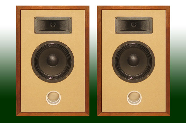

I built this a few months ago and was thinking of selling it as a kit... but probably will change my mind. It's the dayton 6" woofer plus a piezo crossed at around 6khz in a .5L box tuned to 70hz. It sounds really good and punchy and will cost less than $100. I think it's a good alternative to the speakers listed above... but it's not perfect, LOL!

LOL. I'm not selling those in the picture. They are sitting behind my desk playing away now. But the components are cheap enough and the sound is good enough. If you want a cheap box .5L then this is one of many options. When i designed them i was thinking inexpensive college dorm speakers, acid rock with a bit of power handling so they don't blow over 4 years of partying. They may do rock a bit better than the cheaper full range driver types like the one in the Zaph link.
The B20 + tweeter Scott mentioned is another good option for a cheaper build. Scott, have you heard the B20? I know many drivers here in the USA are not readily available where you are... and some by you are difficult to get here (Monacor for example).
